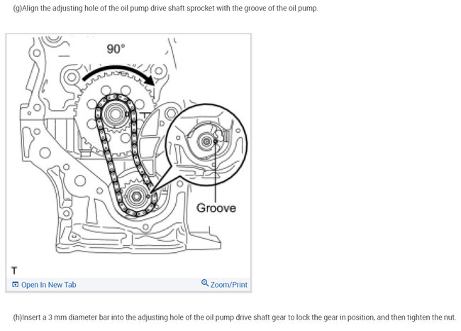

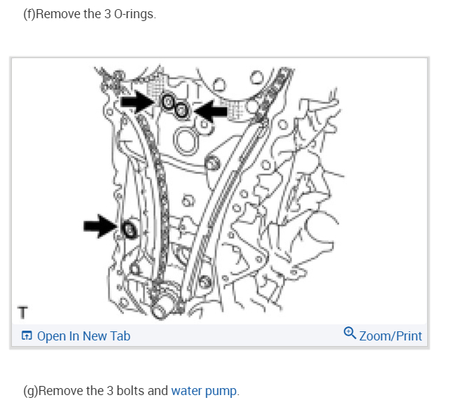

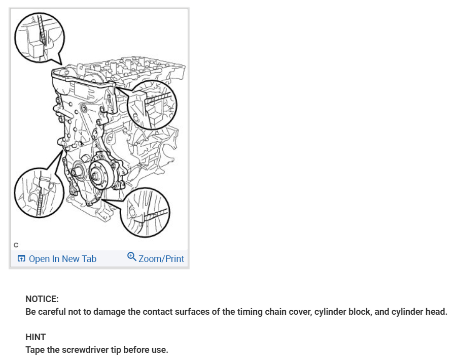

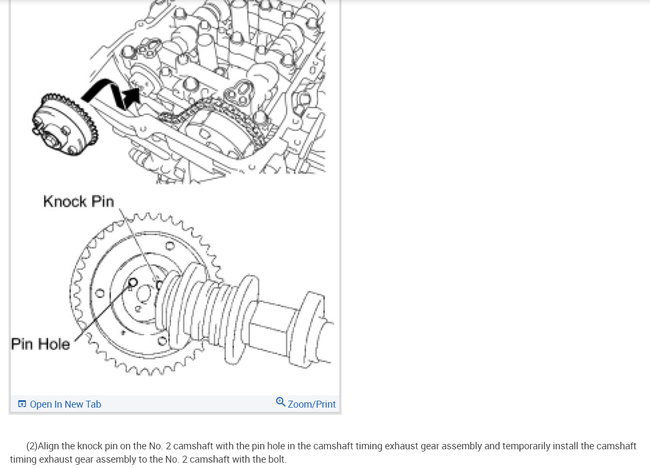

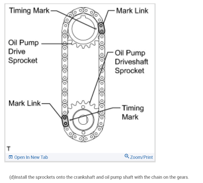

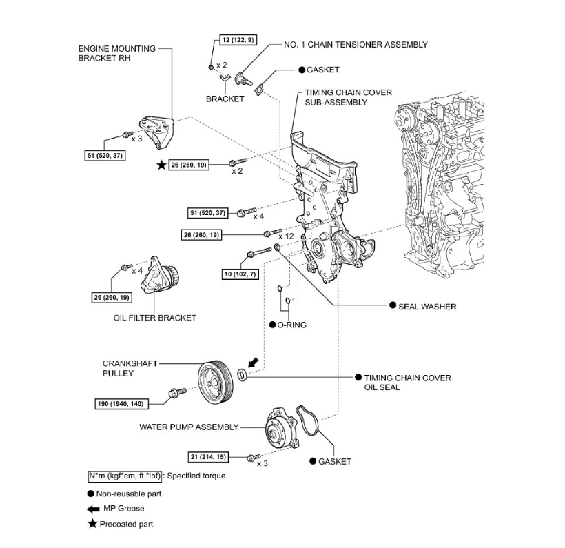

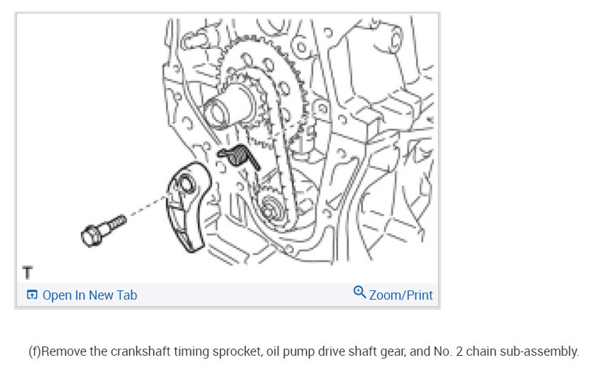

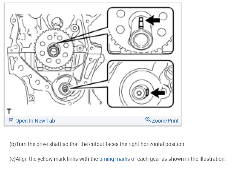

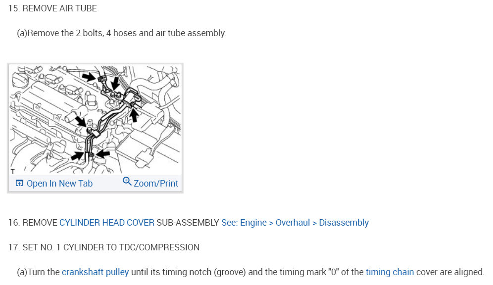

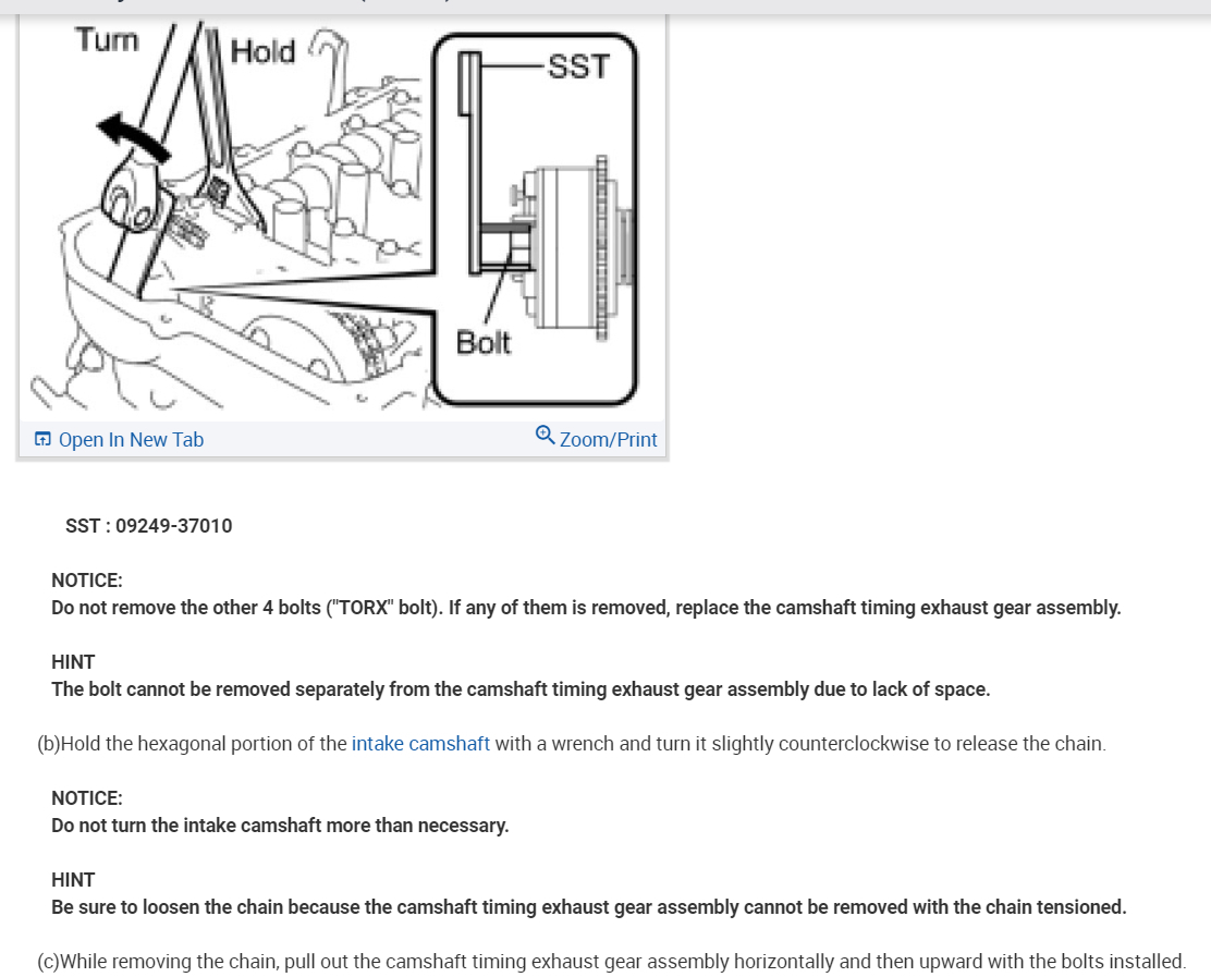

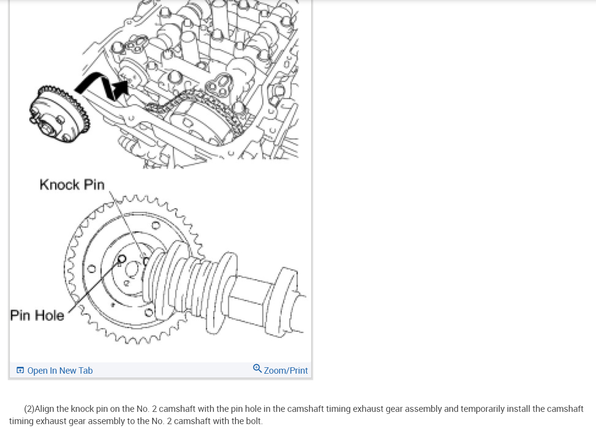

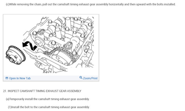

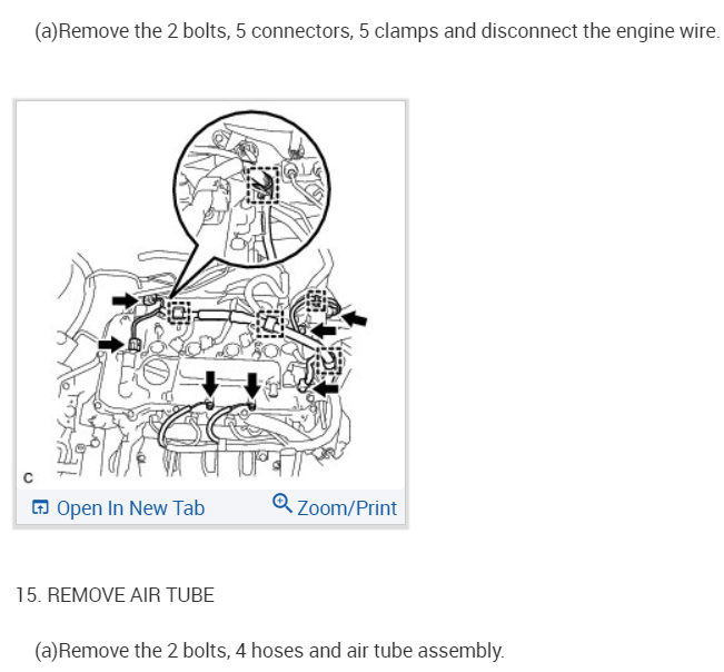

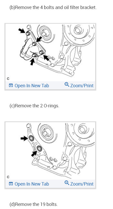

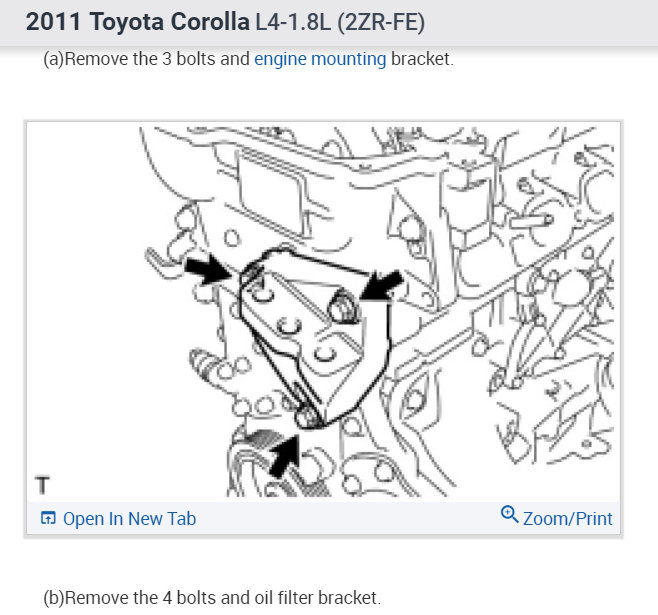

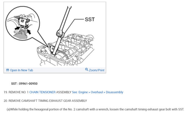

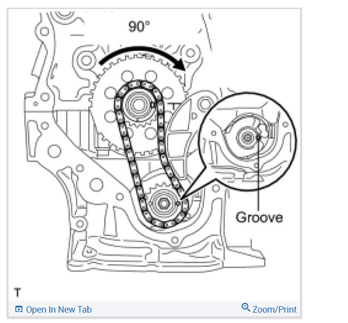

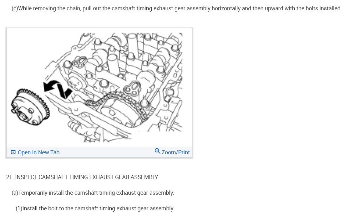

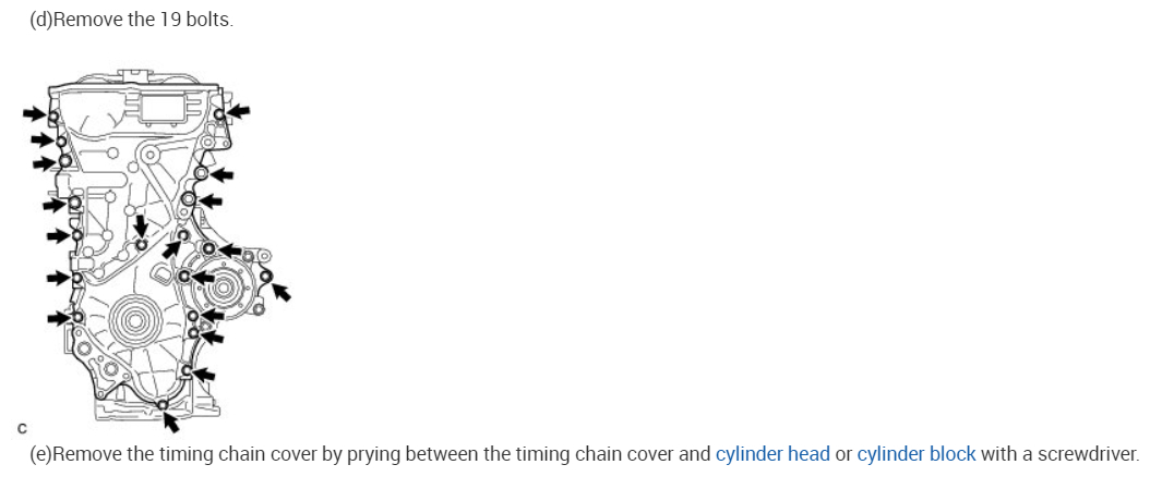

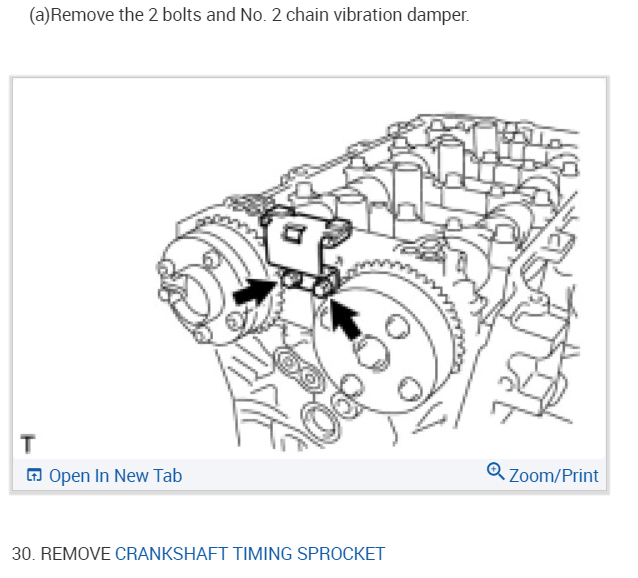

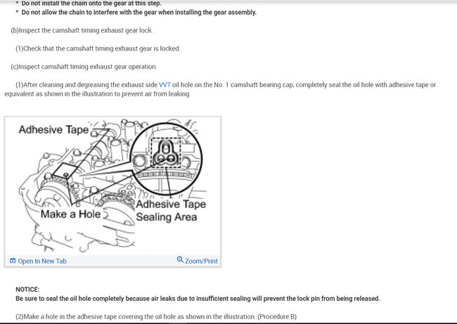

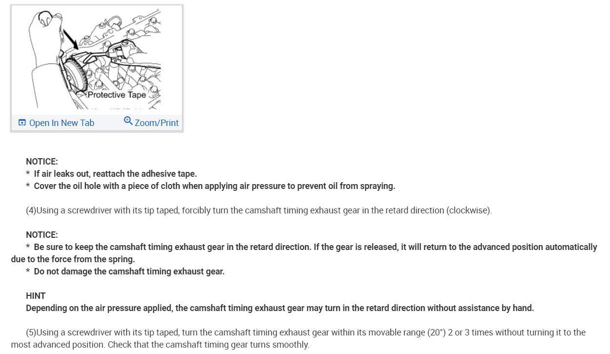

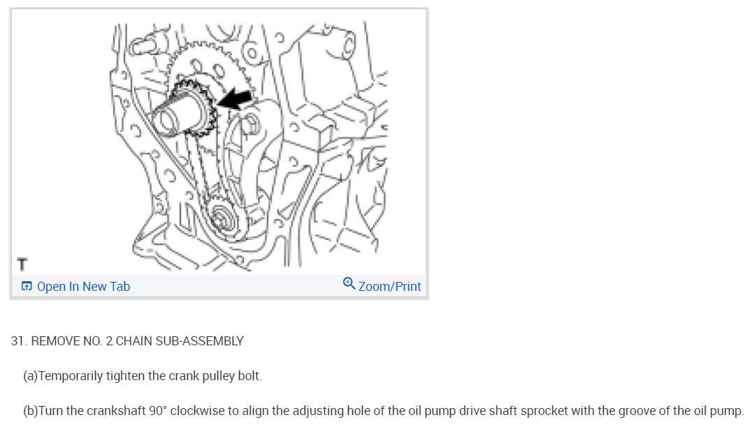

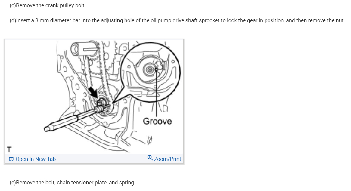

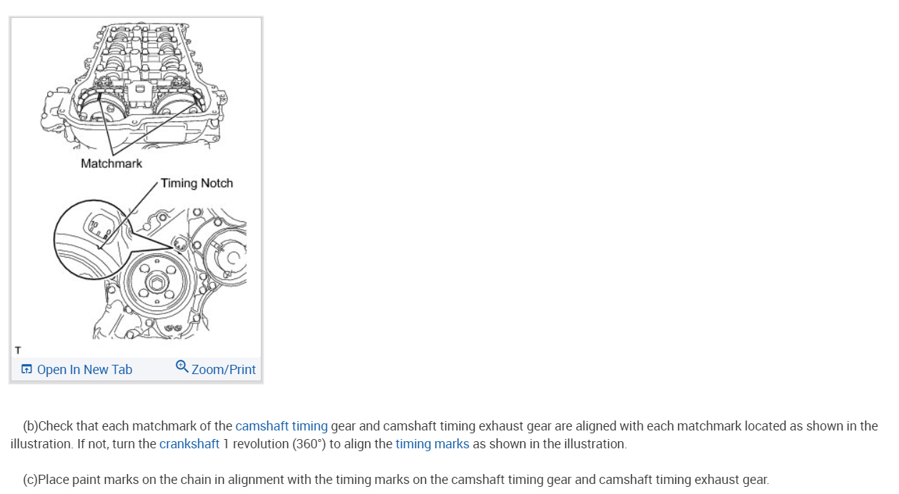

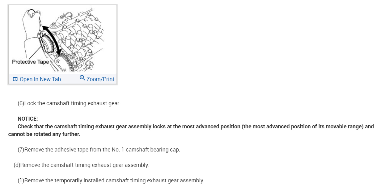

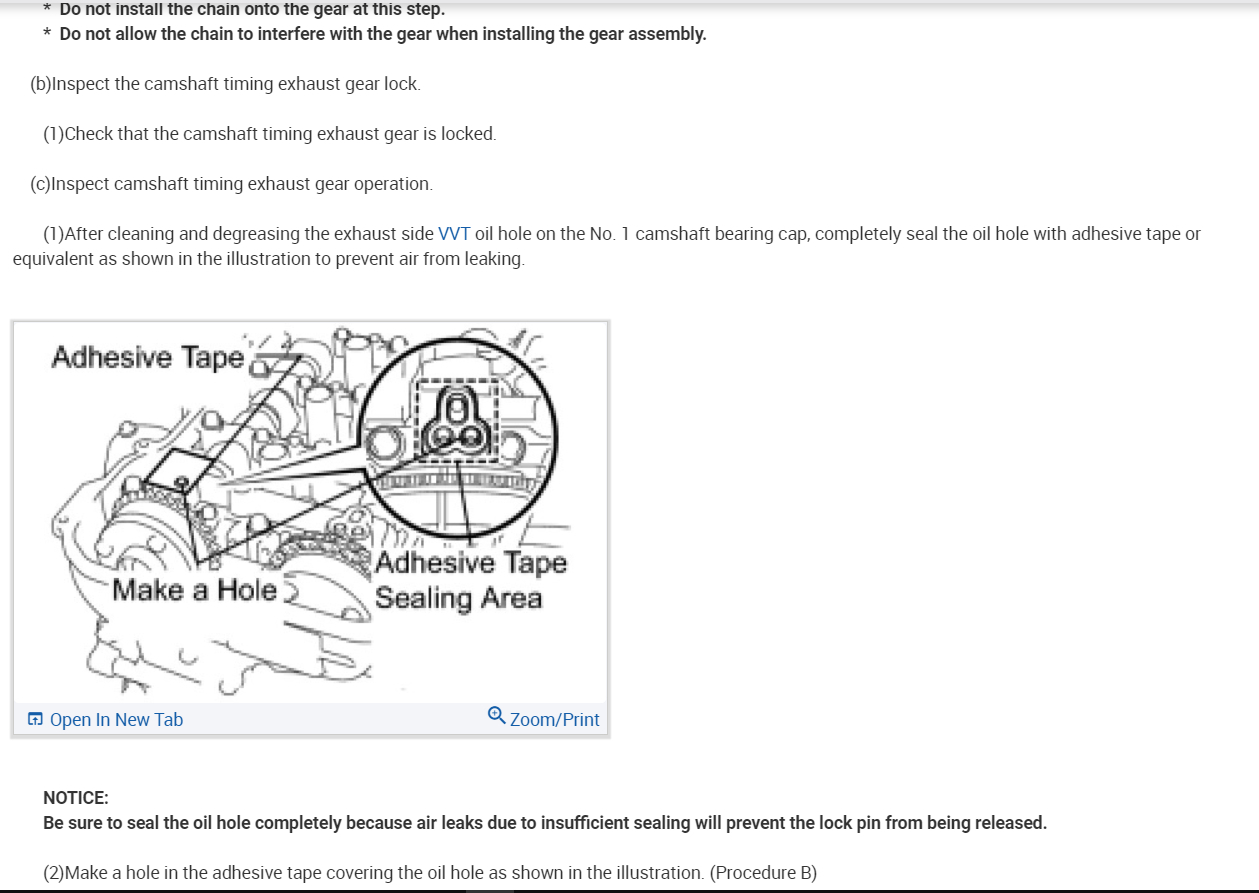

Yep, good call on the catalytic converters they were probably okay. What happens is the the variable valve timing actuators were out along with the timing chain and guides. Can you please shoot a quick video with your phone so we can see what's going on? that would be great. You can upload it here with your response. That was I can tell for sure.
Here is a guide to show you how it works:
https://www.2carpros.com/articles/how-camshaft-variable-valve-timing-works

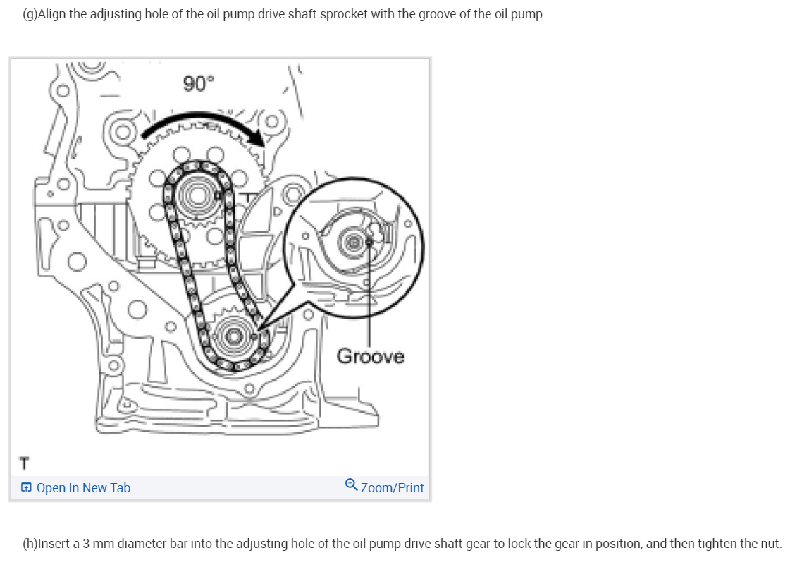

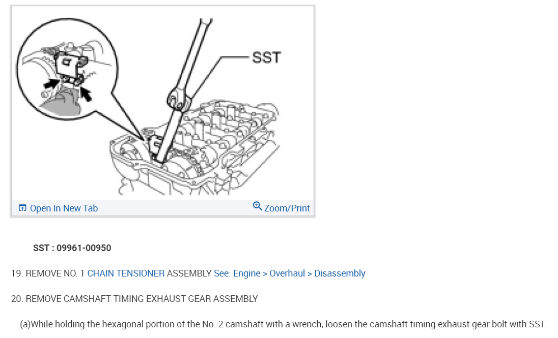

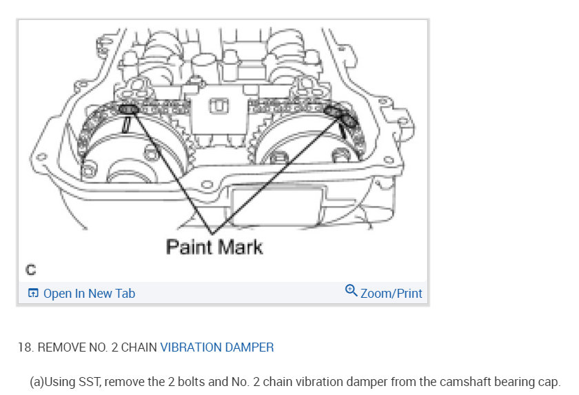

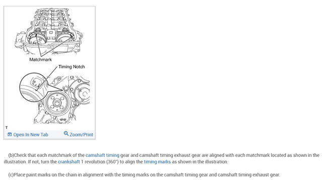

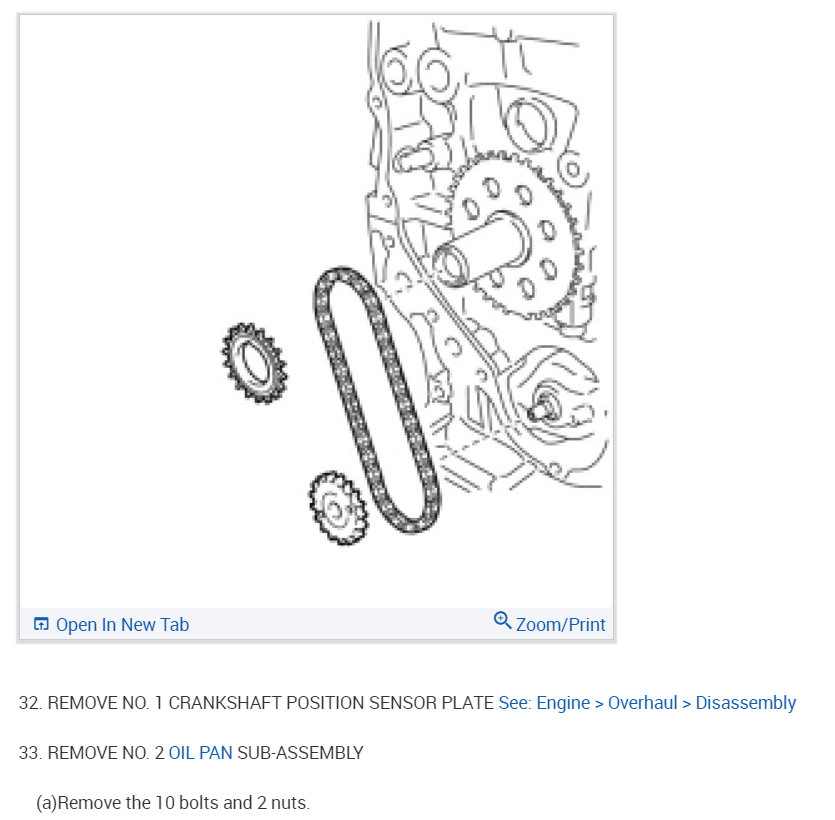

If I am correct here are the instructions and diagrams to replace the parts needed to fix the problem. Check out the diagrams (below). Please let us know what you find. We are interested to see what it is.

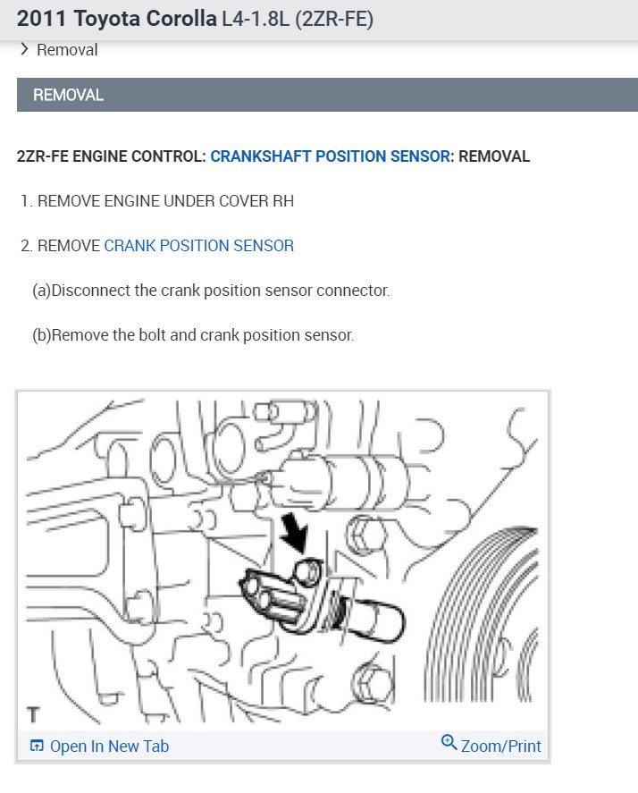

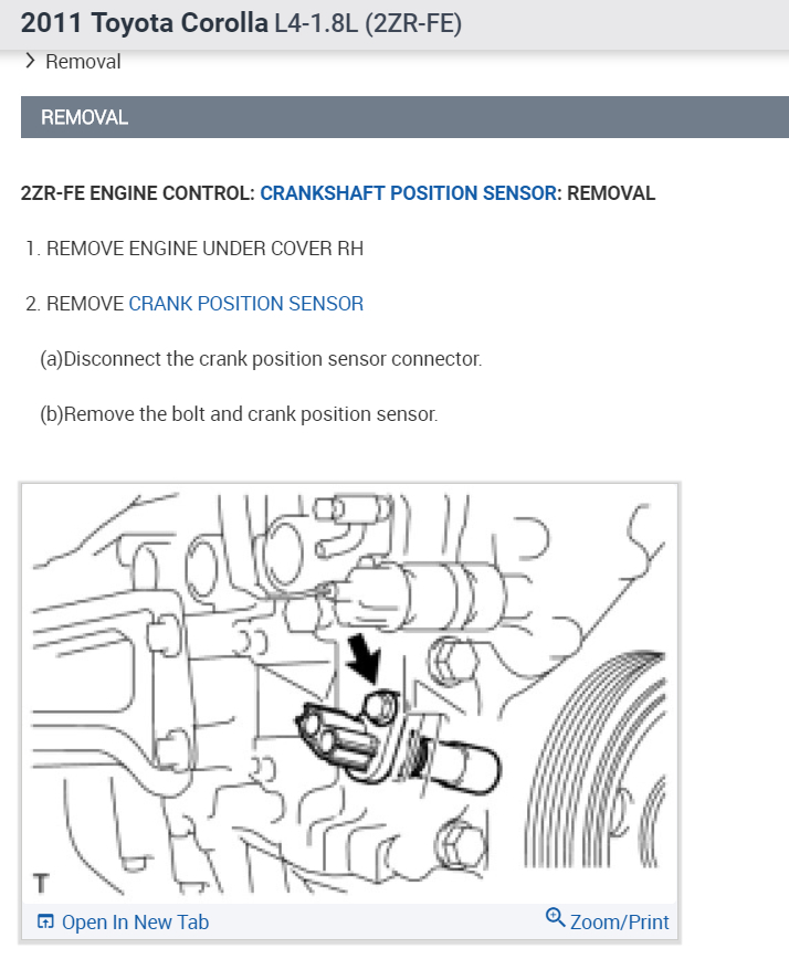

Many thanks for your response, help and advice, I hope to make a video of the problem and post here also, I plan to have a mechanic look into what you suggested, but before we get into such hideous and expensive exercise or task, I want to rule out this possibility as it occurred to me: the P0016 DTC reads; Crankshaft Position - Camshaft Position Correlation (Bank 1 Sensor A). Could this mean, it is perhaps the sensor that is bad or a bad sensor would not be accompanied with the chainlike rattle sound am hearing?? because, I read one of your blogs here, and realised a failed Crankshaft sensor can cause reduced engine perfomance.
Jul 29, 2019 at 5:54 AM
You get the p0016 codes etc, when the actuators cannot hold their position and the engine losses correlation between the crankshaft and camshaft. You can try to replace it to see if that helps. I have been wrong before lol. Here is the location. Check out the diagrams (below). Please let us know what happens.

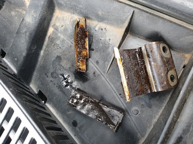

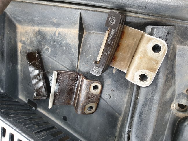

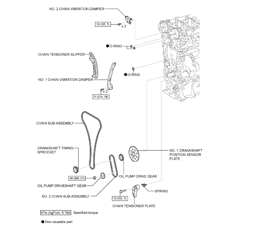

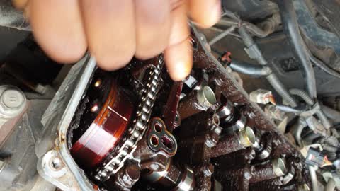

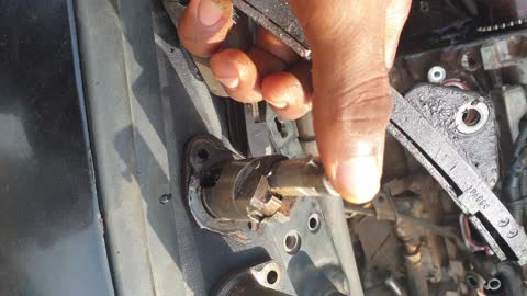

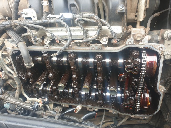

Thank you very much. Right call on the bad timing assembly being the problem, upon opening the engine, The damper no. 1 and 2 were broken, as you can see in the pictures, the Timing Chain was loose and out of time and the timing Adjuster was also bad after the fix, the noise was gone and the engine appears to have more power now. The engine have a lot of sludge though, should worry?

Good find on that one, it looks like the engine oil was not changed very often which might be causing the issues now. I would try to clean as much as you can then remove the oil pan to clean the pick up screen for the oil pump then keep changing the oil every 1000 miles/KM For the transmission issue lets start a new thread.
