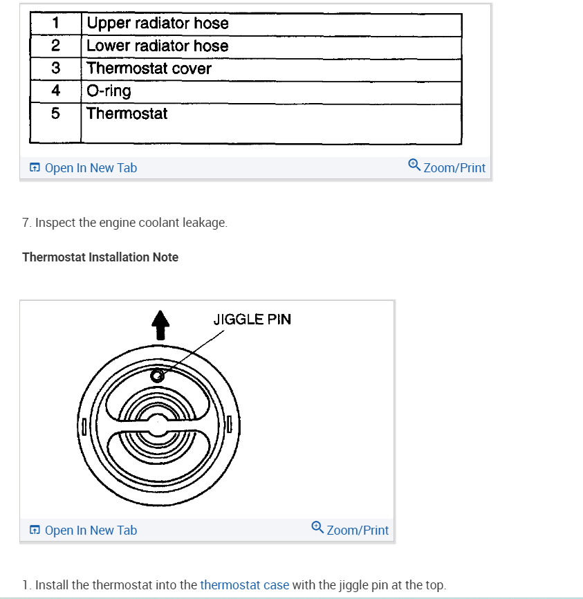

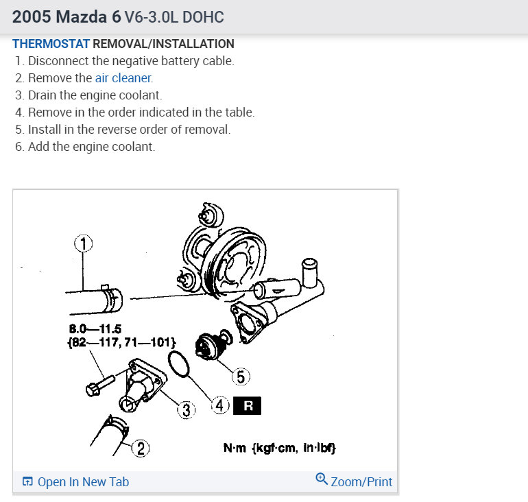

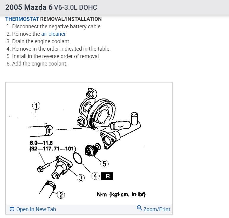

This can happen when the thermostat sticks closed. Also, double check the coolant level to make sure it is full. This video will show you how and I have included a guide and instructions for your car in the images below on how to change out the thermostat.
https://youtu.be/GSE9skKnOgY
and
Check out the images (below). Let us know what happens and please upload pictures or videos of the problem.
