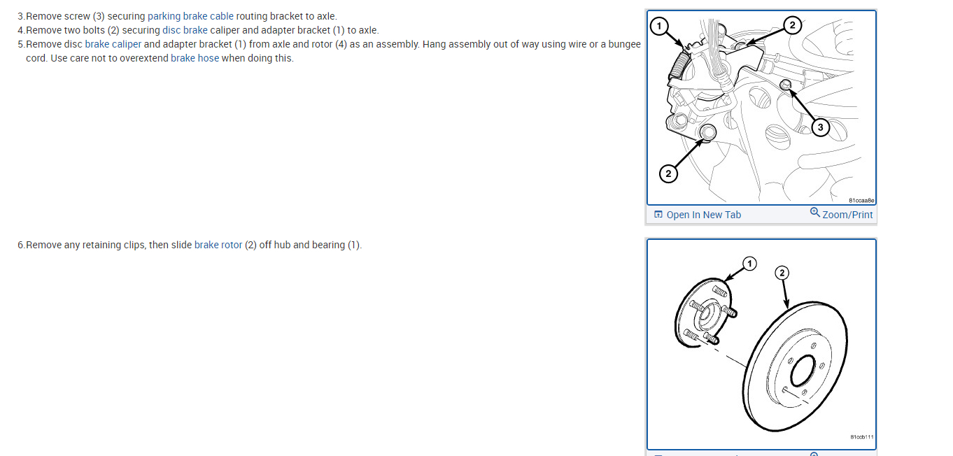

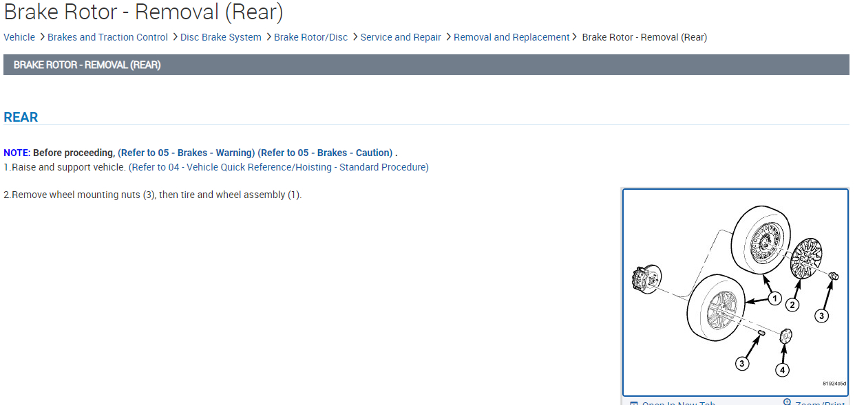

Hi Christopher Ellison.
We can help with that, it sounds like your rear dust plate has a issue, will need to inspect for possible touching when braking, see link below .
inspect that inner brake pad is in the piston grove.
Cheers Nick
