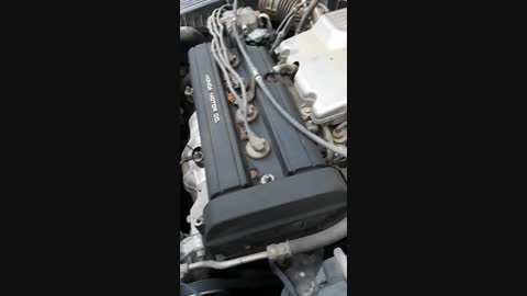

This is the noise that the 2000 Honda CRV four cylinder 2.0 liter is making. Hope this helps you. I will be waiting for a response. Thanks

Thanks for the video it helps. Yep dont run it anymore, It sounds like something is hitting the flywheel. Remove the serpentine belt to eliminate any accessory issues. Then turn the engine over by hand to pinpoint the noise. Going to be a dust shield or like I said the starter bendix or the starter is not in right. Please let us know what you find. We are interested to see what it is.
