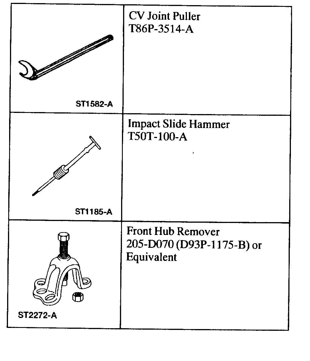

Special Tools
pic 1

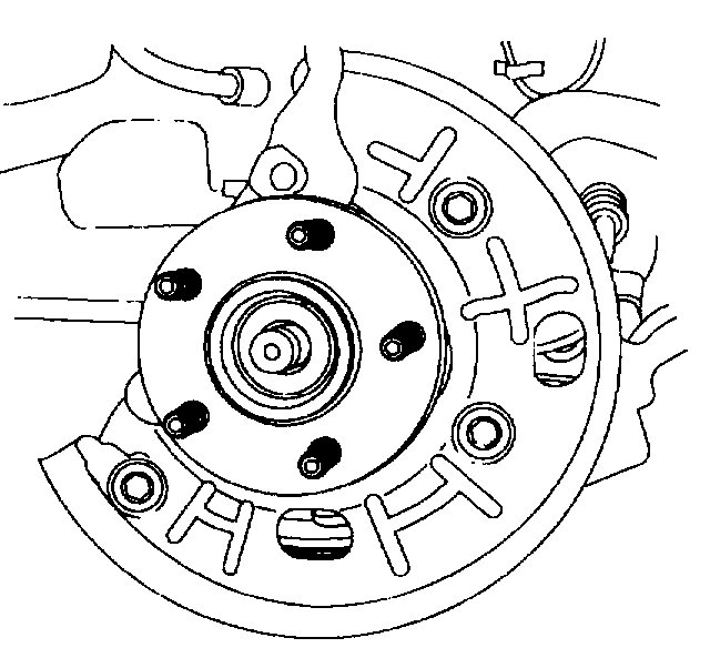

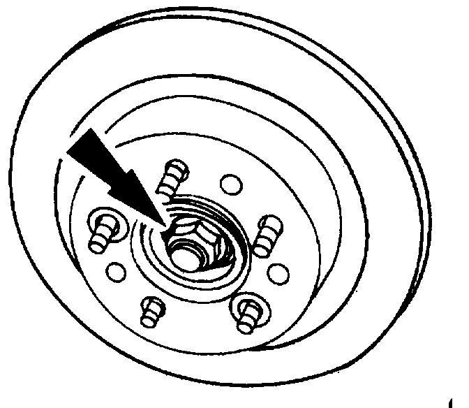

3. CAUTION: Discard the wheel hub retainer nut and washer assembly. It is a torque prevailing design and cannot be reused.
Remove the wheel hub retainer nut and washer assembly.

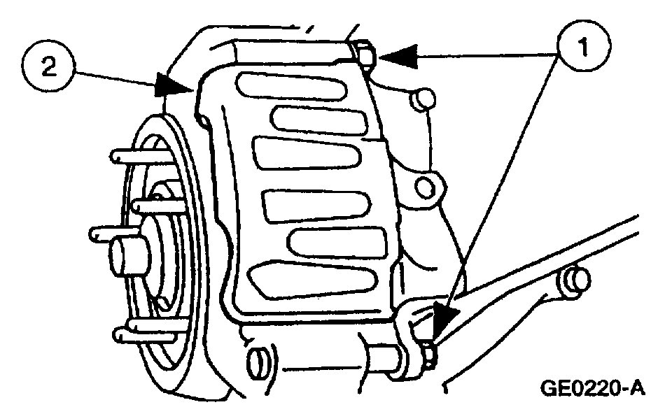

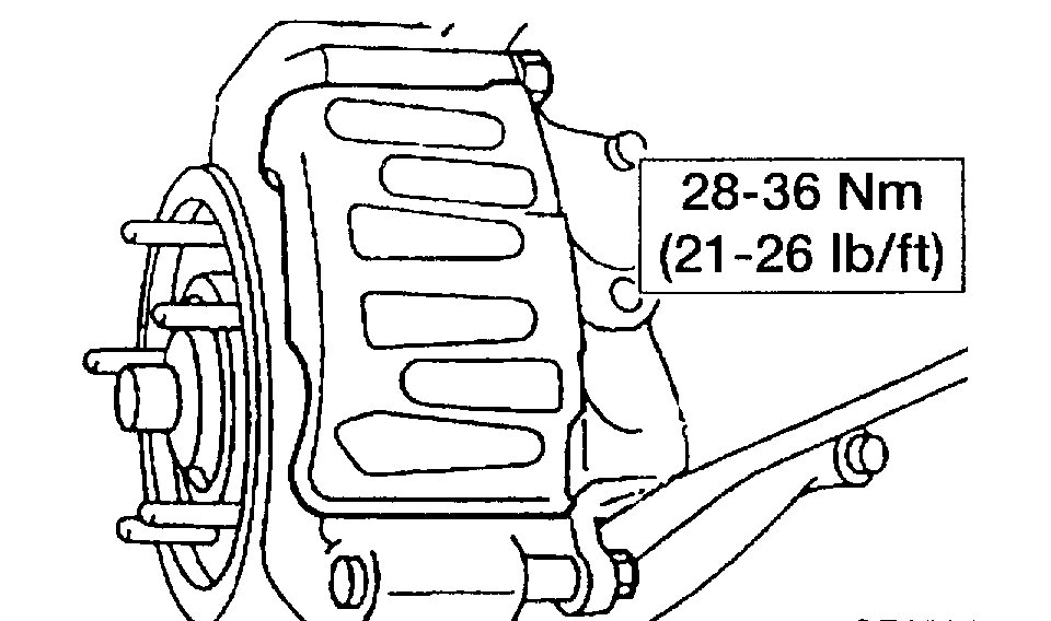

4. Position the disc brake caliper aside.
1. Remove the two front disc brake caliper bolts.
2. Lift the front disc brake caliper off the front disc brake caliper anchor plate and position aside.
pic 4

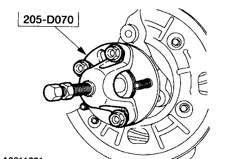

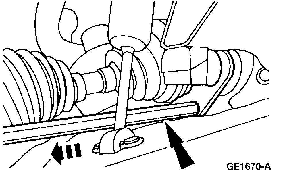

6. CAUTION: Do not use a hammer to separate the outboard front wheel halfshaft joint from the hub. Damage to the outboard CV joint stub shaft housing threads and internal components may result.
Install the special tool and separate the halfshaft from the hub. Remove the special tool.

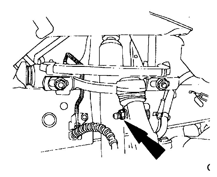

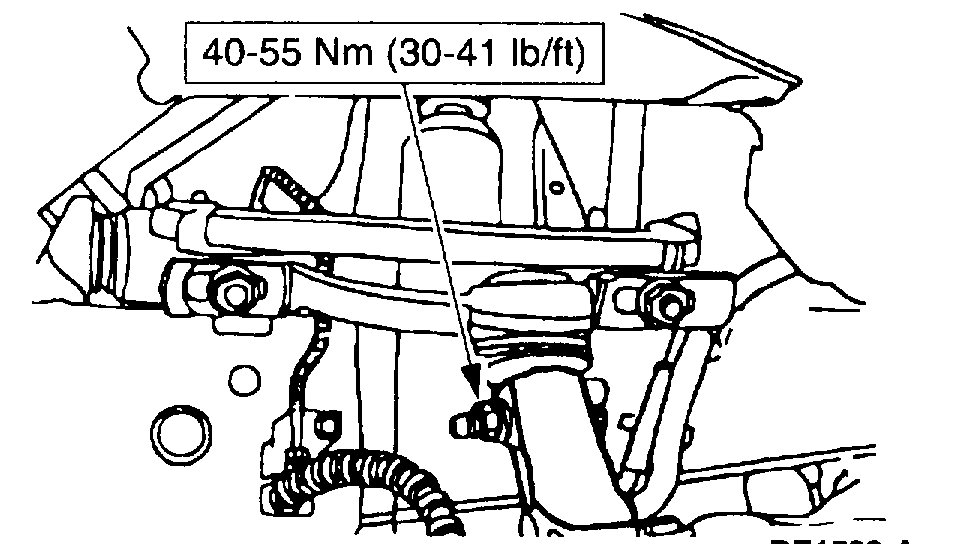

8. Remove the upper ball joint to front wheel knuckle nut and bolt.
pic 7

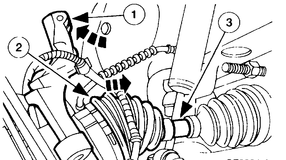

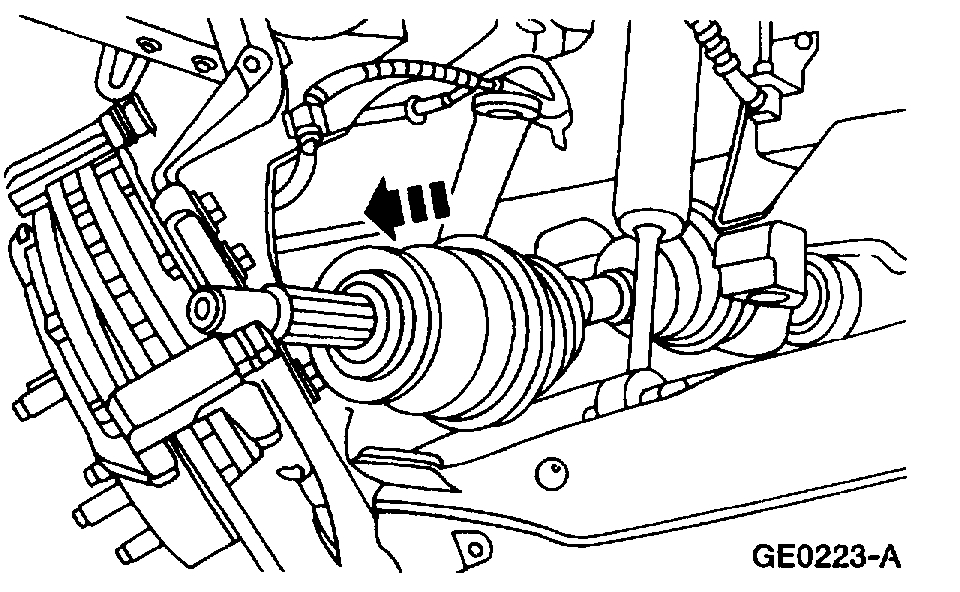

9. Remove the outboard front wheel driveshaft and joint from the hub.
1. Rotate the front wheel knuckle.
2. Compress the outboard front wheel driveshaft and joint.
3. Remove the outboard front wheel driveshaft and joint from the wheel hub.

10. Using the CV Joint Puller and Impact Slide Hammer, separate the front wheel driveshaft and joint from the front axle housing.
pic 9

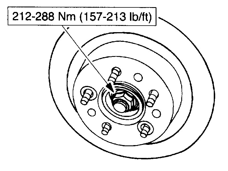

1. CAUTION: A new front axle wheel hub retaining nut and washer assembly must be installed.
CAUTION: Do not use power or impact tools to tighten the hub nut and washer assembly.
CAUTION: Do not reuse the retainer circlip. A new circlip must be installed each time the inboard CV joint stub shaft housing is installed into the differential.
Follow the removal procedure in reverse order.
