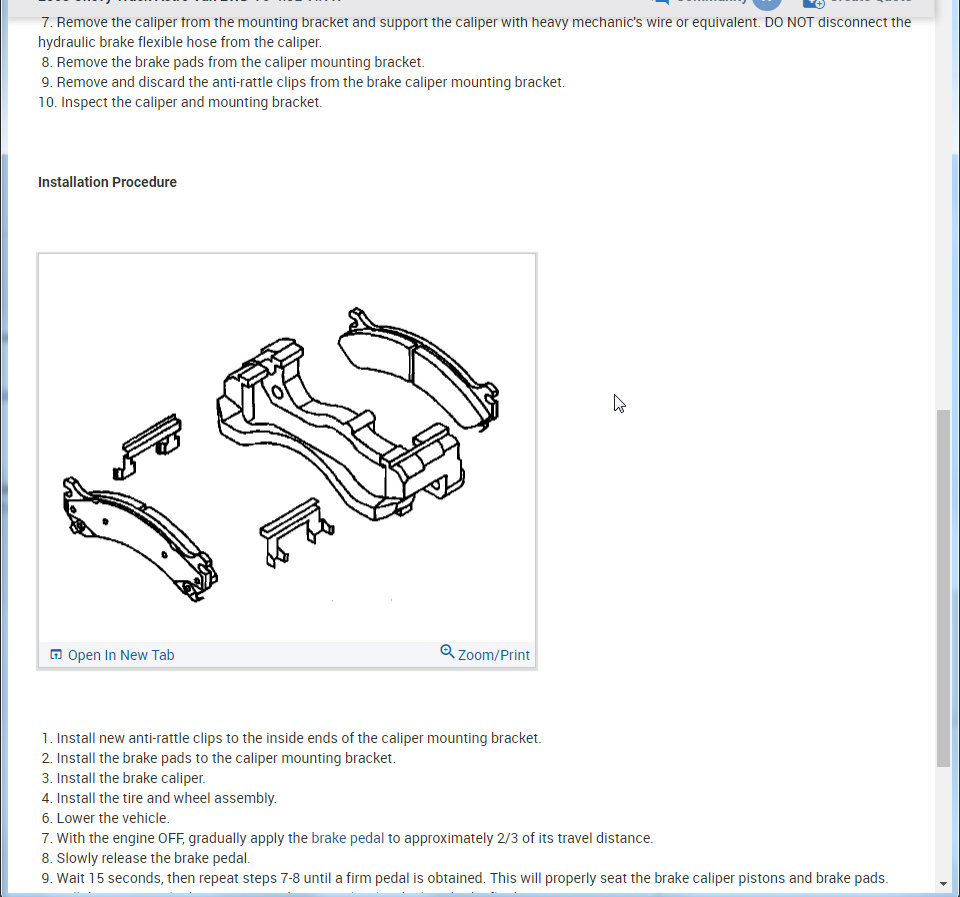

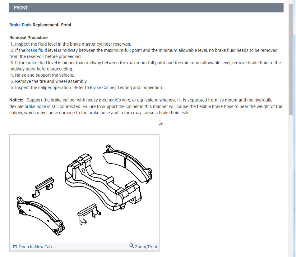

Here is a guide that will help with this as well:
Below you will find the detail from the manual on how to do this as well.
I would suggest replacing the pads if they are low and then retest to see if the noise is still there.
