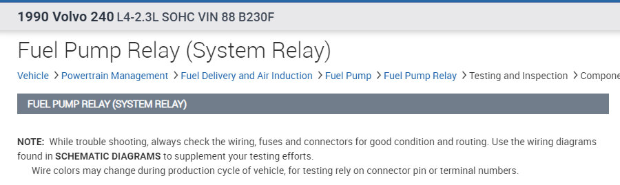

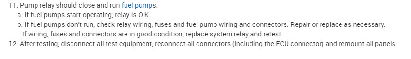

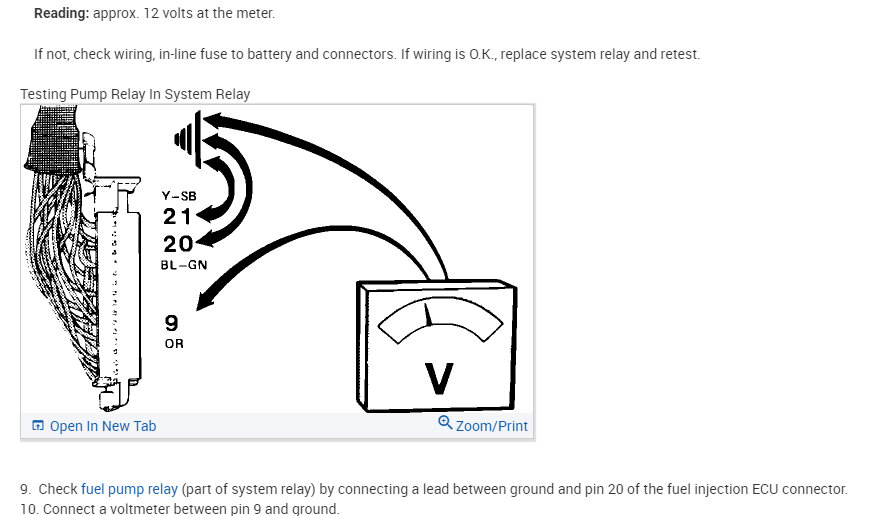

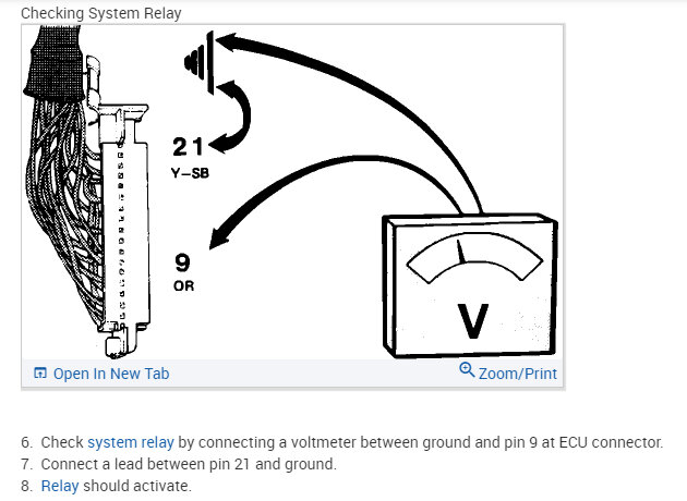

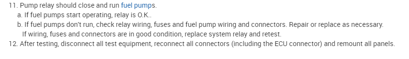

If you are able to jump the secondary side of the relay and the pump runs, chances are the primary side is the issue.
If you look below, I attached the directions for testing the fuel pump relay circuit. Take a look through it and let me know if you are comfortable performing them.

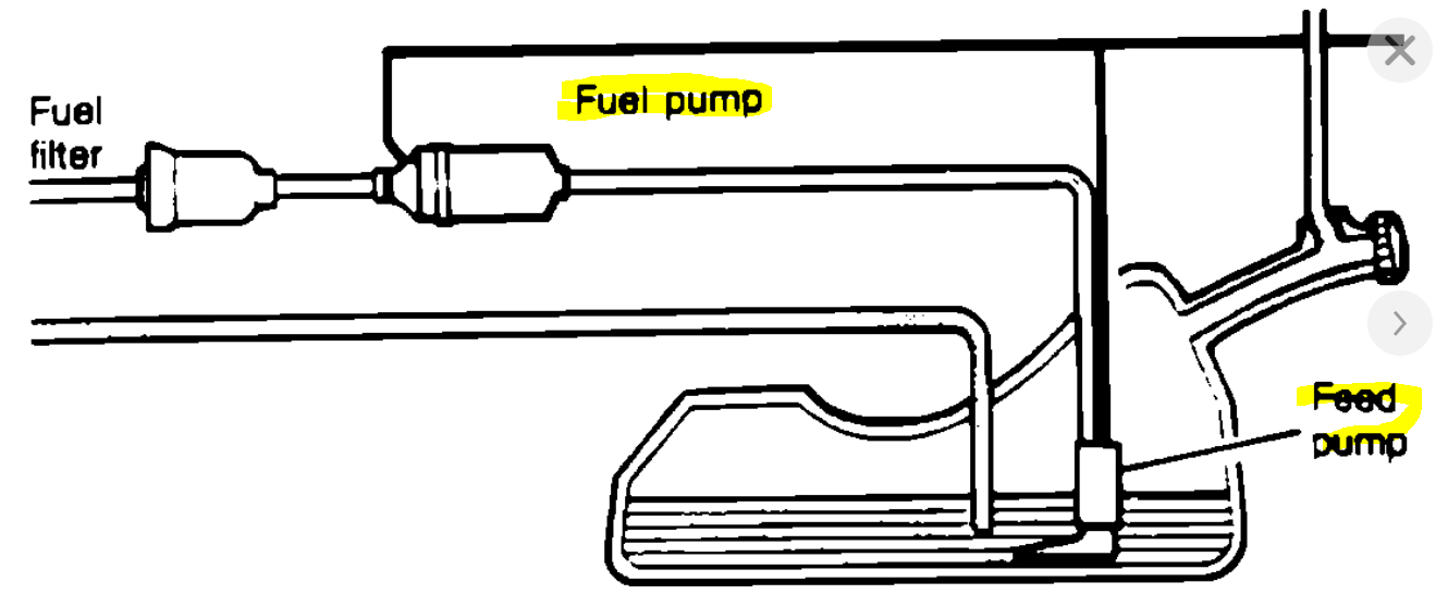

Are you sure the in-tank fuel, feed pump is working?

So, I ran some tests on the in-tank pump and couldn't hear it turning on or get an accurate voltage reading so I went ahead and purchased it to install tomorrow. I went ahead and took out the old one today, what a headache only because it seems like it had never been done before. Hoses and flange were caked with soil and rust, it took a good three hours just to loosen the flange with a mallet and flat head as there was no flange tool available at local auto parts stores and there isn't enough room in the opening to work properly. Filter or screen as they call it attached to pump was hanging on by a thread, so it definitely needed to be replaced. I would recommend people go and clean the area periodically to avoid the frustration when the time comes. Fingers crossed for tomorrow...

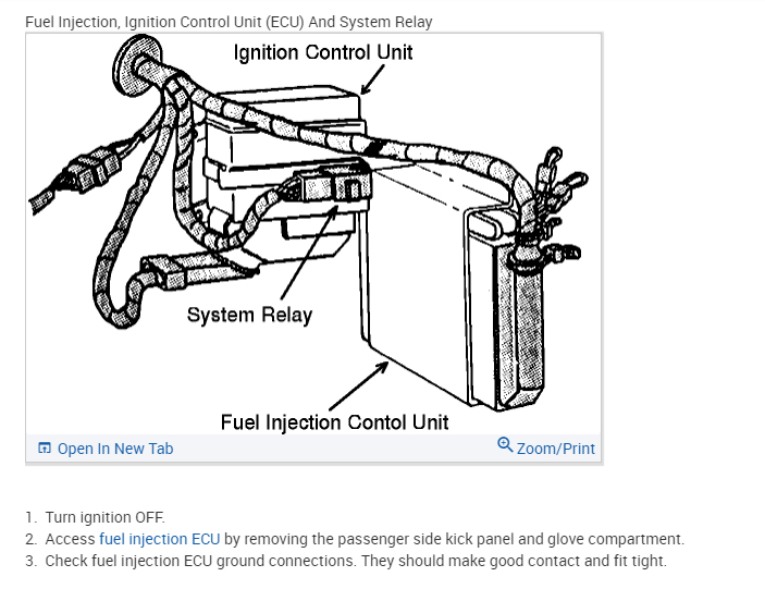

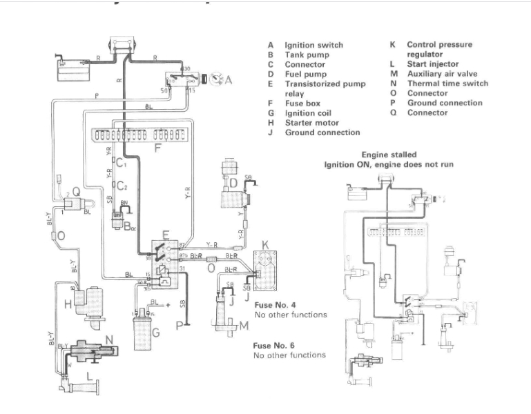

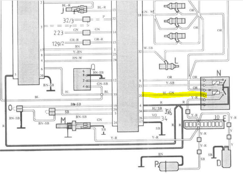

Since I don't have great schematics, I have a question. You indicated it will start if you ground the blue/green wire from the relay. If that is the case, then the issue is either a faulty ground via the connector at the ECM or the ECM is bad and not providing a ground path.
Take a look at the pic below. Does that appear to be what you are looking at on the vehicle? I ask because when I look at the schematic for the 2.3L, I don't see a blue/green wire. When I look at the schematic for the 2.4, I do.
Pic 1 is the 2.3L and pic 2 is the 2.4

Hi Joe,
Yes, it is the 2.4 as pictured in diagram 2 with blue/green wire. What I found was after 89' they used the Bosch ecu and made it 2.4. I have conflicting paperwork on mine as the previous owner/seller didn't know and put ink to paper on what they thought or remembered so it took me a while to get that sorted. But the good news is it runs without fail for now. I had always suspected this was the issue but knew I needed to start replacing parts anyway. So, I used this as an excuse to work my way to replacing them. In all its good experience on these old cars as not many mechanics these days will touch them. I will investigate the ECU further and figure out if it's a bad ground or if the ecu is bad it that area. Thanks again.
