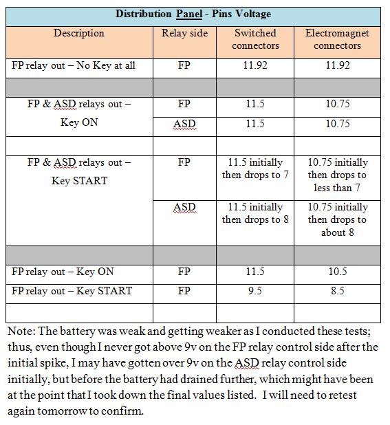

1yr ago, tried to start the Caravan that had sat for a couple of years without being started. For diagnostic reasons that I can't remember now, but which I'm pretty sure involved introducing gas directly into fuel rail (using an OTC air pressured canister) and getting van to start, I replaced the fuel pump. Van then started a couple of times over a few days and then wld not start again. Now, a year later and after more diagnostics done, have determined that a.) no power is getting to fuel pump when relays are plugged in (except for quick 12 burst); b.) replacement pump does not respond when relays are by-passed and power is present at the connector near the pump, so possibly whatever caused the first pump to fail also fried the replacement one; c.) confirmed that fuel pump and ASD relays are working to the extent that the electromagnets inside do switch over the load side of the relay when there is at least 9v present, but not when it drops below that level; d.) When cranking, the engine voltage drops to below 9 volts after a quick 12v spike, the latter which I now understand (from reading caradiodoc's other posts) is normal until the engine starts running. However, what I don't know is if the voltage is supposed to return to close to the 12 volts after the engine starts. I presume that it cannot be normal to drop as much as it does for me. So it seems that the reason for the lack of power to the pump is that the relays are not switching on the load side because they are getting voltage at the Power Distribution Center that is less than the 9v+ required to energize the electromagnet inside.
Additionally, now the van will not go into reverse. Nothing happens (no jerks, no noises) when in reverse other than the back-up lights come on. Forward drive may be slow in reacting as well, but it does kick in. This new problem occurred on a very cold day after a prolong cold spell of single digits temperatures. Could temperature have been a factor?
Finally, the van has a new coil, new plugs, new plug wires, and a fairly new, but possibly dying battery (not sure if it is holding a charge as well as it should). As I said, the van starts if I by-pass the fuel pump and run it off gas being fed directly into the fuel rail. And speaking of being able to start it, what I have not tested (bc it just occurred to me!) is to see what the voltage at the PDC is on the electromagnet side of the relays once the engine is actually running - that is, is it between the 9v and 12v needed to energize the relay or below that threshold.
So, what could be causing the voltage drain at the PDC that is failing to activate the relays? A sensor failure elsewhere, the computer, a short somewhere? I have a new Bosch fuel pump waiting in the wings to replace the apparent faulty one, but I do not want to do so until I can ensure there are no shorts or some other fault that may have fried the first two. Any help in troubleshooting this further would be greatly appreciated.

Thank you Caradiodoc for responding. First off, I have done so many tests that I may need to redo some of them again and this time write the test and results down simply because I cannot always remember all of them and their combinations or what were the exact results and/or values! Having said that, I'll clarify a couple of the results which you brought up.
First, I have not gotten the replacement pump in the tank to make any noise or to build up any type of pressure, even when attaching a motorcycle battery (w about 10.25v on it) directly to the connector on the harness leading to the tank (next to it). This was also true when the pump received voltage from the van battery after I jumped the FP relay (see below), which is why I think the pump has failed. Thus, the "burst" I was referring to was one of voltage, not pressure, and then that was at the connector next to the tank (sorry if I was not clear). That burst was a momentary one - more of a split-second +/- 12v spike right when the key is in the ON position (if my memory serves me), but nothing when the engine is being cranked. Because of this, I have not dropped the tank again and installed the new Bosch pump. Note that I'm primarily checking for voltage to the dark green wire (pump); however, the dark blue wire (sending unit) does get continuous (I believe) voltage.
To verify that the issue was not the FP relay, I took it out and jumped the load side pins (30 & 87) on the PDC and I did get voltage at the connector on the harness by the tank when I cranked the engine. The caveat with that is that I do not remember the voltage or how consistent it was, nor if I also had the ASD relay out and the pins jumped when I got the voltage (Done too many combinations of tests!). However, being that, if I'm not mistaken, the load side of the relay always has power present (or at least when the engine is cranked/running) and it's the relay that switches the load connection on/off (like a house light switch), then for the purposes of the above test, whether the ASD relay was in or not might be irrelevant since I did get voltage at the pump. Where it might come in to play, I'm guessing, is if the computer recognizes the ASD relay missing (or not working) based on the control side circuit remaining open even after voltage is applied to it, and/or that control side circuit feeds something else downstream of the relay - something which is needed to start the engine. But, then again, if either of the latter two were indeed factors, wouldn't it make sense that the van would then NOT start even when I by-pass the fuel pump by injecting gas directly into the rail?!!
You touched on the crankshaft and camshaft sensors. Initially, I thought that if one or both were not working that the computer would not send power to the coil for a spark. However, is it possible that all the computer needs to turn on the coil is a quick "confirmation" that the one or both of the ASD & FP relays (control side) work even momentarily, and, further, that once it gets that quick response it ignores the state of the control-side of the relays' circuits? That might explain why I can still start the engine without the fuel pump working. To bolster that theory, I have confirmed that momentary surge of voltage (+/- 12v) on the control side of both relays when cranking the engine, The caveat here is that the voltage only lasts for a short period, dropping almost immediately to below the 9v threshold that the relays need to switch on (see attached chart image, which shows voltages measured on both the control & load sides of both relays under various conditions). So, if the normal engine electrical design is such that both relays (or at least the FP relay, of course) should remain powered (and therefore load side switched on) once the engine is running, then the question is why the voltage on both, but particularly the FP relay, drops so significantly and below the 9v threshold.
Anyhow, I will charge the battery again tonight and perform both my tests and the ones you suggested tomorrow. Thanks and stay tuned....

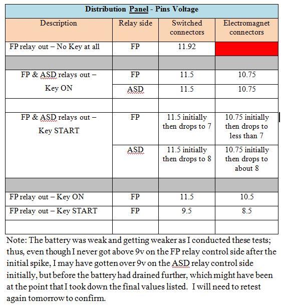

P.S. A couple of corrections: First, on the 3rd paragraph of my last response, I meant to say that I was verifying that there wasn't a broken connection in PDC or in the harness down to the fuel pump (well, at least to the connector near the tank). Second, the chart is incorrect in that I had no voltage on the control side of the FP relay pins when the key was off. Corrected chart is attached.

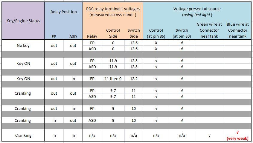

Performed some additional tests today using the voltmeter and the test light but I was not able to do any tests on the connector near the tank using the either tool simply because I did not realize I no longer have access to that side of the van since I moved it last (not having the reverse drive working complicates matters. Will try again on Thursday when I have my kids around to help me push it back!)
What I was able to do was a couple of things: First, I took the battery out and completely cleaned all the connections down to shiny metal since there was a grayish film on the surface of the connections . The second thing I did was get the DTC’s, which came up with 12 and 55 right after reconnecting the battery, which I understand represent a normal condition, and I got equal results after cranking the engine. The third thing I did was get some voltage readings again using both a voltmeter and the test light at the PDC. The battery cleaning must have really helped since I was able to get better voltage readings at the PDC relay terminal points than I had gotten last week – particularly in the low range affecting the relay control side's 9v needed to activate them. However, I want to redo a couple of them before posting them here because they don’t make sense based on my earlier tests and I need to verify I didn't miscopy (is that a word?!) something somewhere; plus I want to do the test with the test light at the connector near the pump as well.
The interesting thing in all this, however, is that after doing all those voltage readings, which involved taking the FP and ASD relays in & out and in various combinations thereof, I cranked the engine again and got a new DTC: 42…twice! Just to be sure it wasn’t related to playing around with the relays, I disconnected the negative terminal of the battery to erase whatever codes were stored, cranked the engine once more, but got the same result: 12, 42, 42, 55. I don’t know why I got 42 twice, if it means anything, but a 42 DTC seems to be that there is a short or open circuit at the ASD relay, though I can’t confirm that since one website listed 42 having multiple meanings, including fuel pump relay circuit, no change in fuel level unit, and voltage missing when auto shutdown is energized!
Incidentally, I did test voltage at the source for each of the FP and ASD relays (pins 30 & 86) using the test light, and always got a solid light on each, but let me confirm that tomorrow.

No....using the test light is definitely a great idea, as I had forgotten that getting voltage and the right amount of current [ amps? or is it "juice"? :) ] are two different things.
I have not been able to do the resistance and other tests that you suggested and I may not be able to do them now for several days due to business travel demands, but I will do so as soon as I can and get back to you afterwards. However, I did have a few minutes free today and I made a closer inspection of the wires next to the windshield washer reservoir, which are coming off the PDC and into the firewall (I think), and I did find some wires with damage to their insulation (likely from critters), which had been taped over (I must have suspected something at some point in the past and had my son do a quick patching up, but I can't remember).
Though it's possible that these sections of wires need to be replaced completely, not just taped up, and that this could be the source of any intermittent shorts that may be occurring, after reading about the issue you had with the other harness rubbing and causing a short when the engine is running, I'm more apt to think that something like that could be the cause of the problem I'm experiencing, since it was after I ran the engine that the 2nd pump failed and that I stopped getting voltage to the pump. Though having "reset" the computer by unplugging the battery could have been the fix, it's also possible that one of the many times I cranked the engine, it moved any wire shorting out on the chassis enough so that it resolved the DTC 42 and also stopped the computer from cutting off power to the ASD relay when cranking (????!)
In any case, it looks like I'm in for a long 2-3 days of testing and/or splicing new wires on that entire grouping by the PDC. I'll also need to check the others on the left side of the engine as you mentioned. Incidentally, if you have access to a complete wiring diagram, would it be possible to send me a copy or post it here? That would be very helpful!
