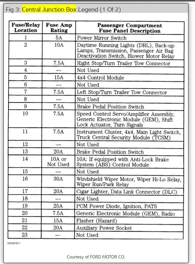

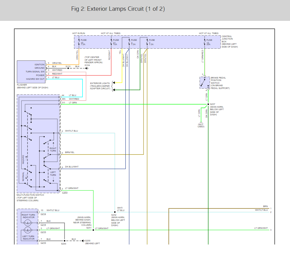

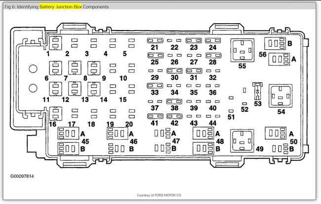

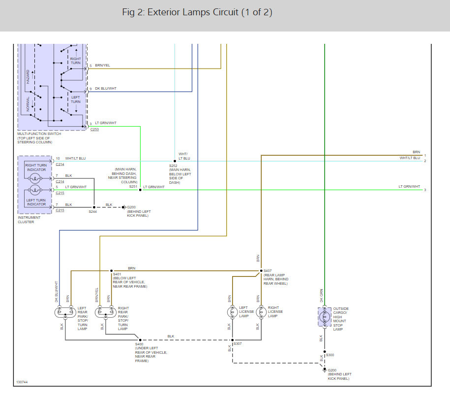

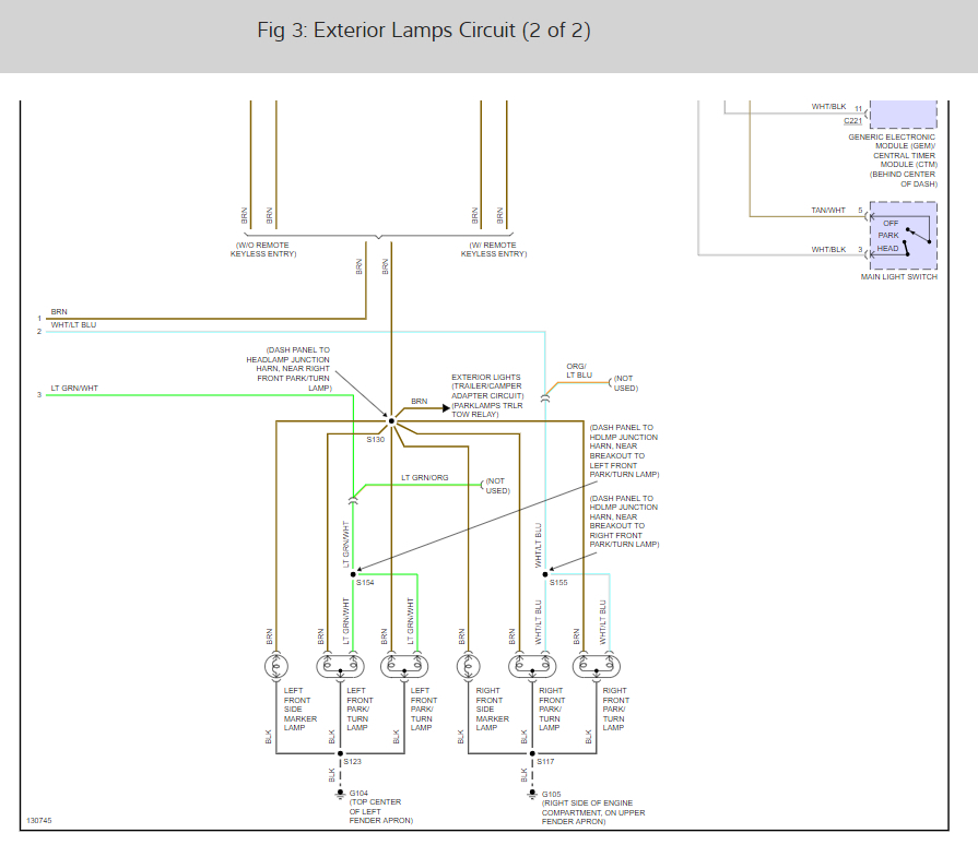

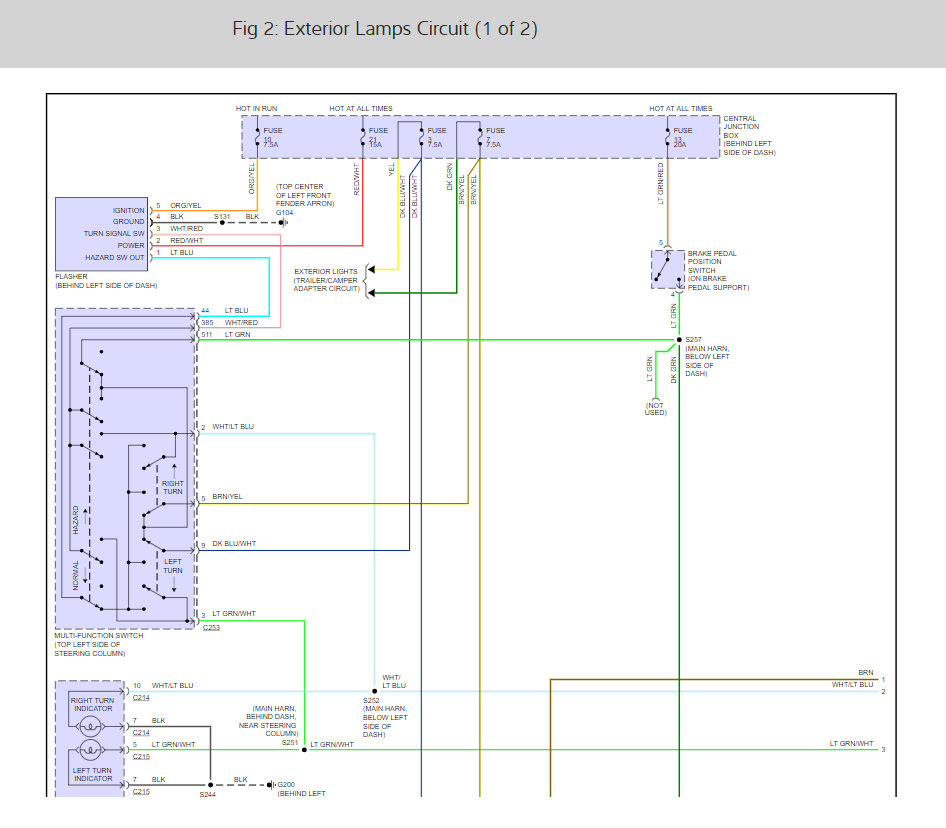

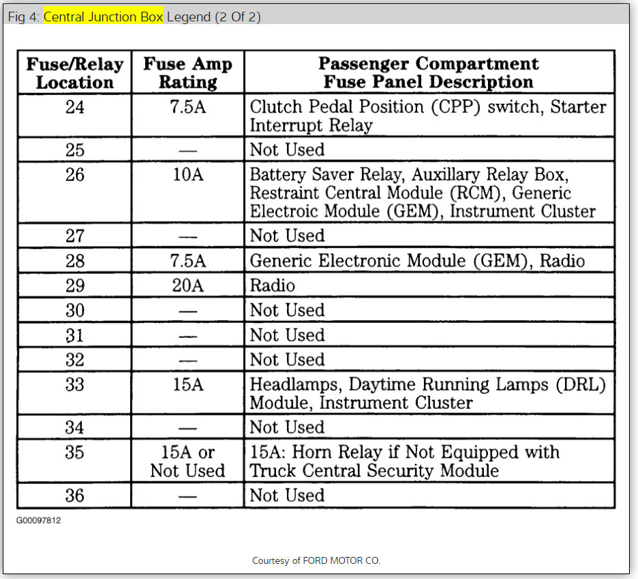

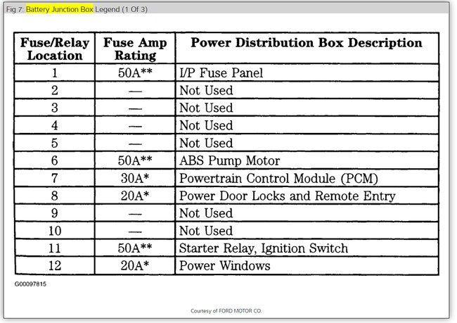

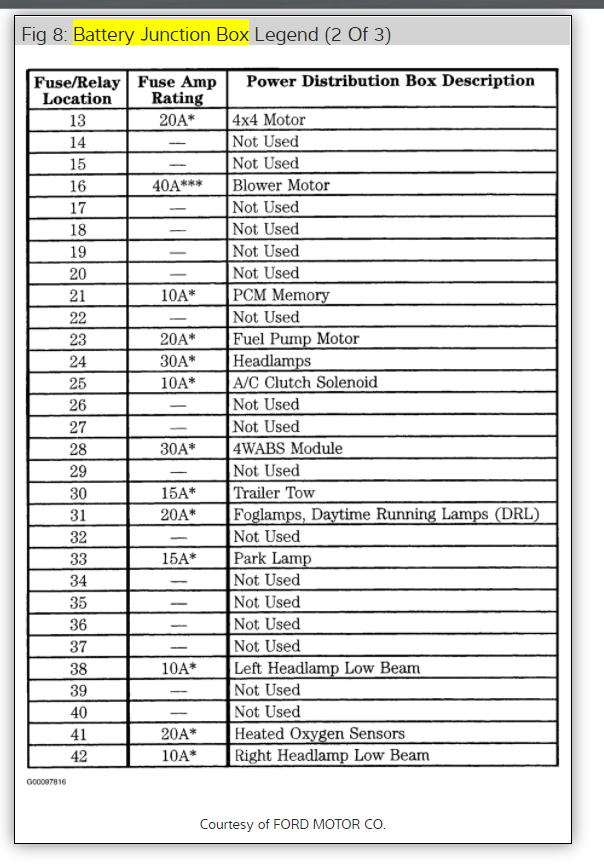

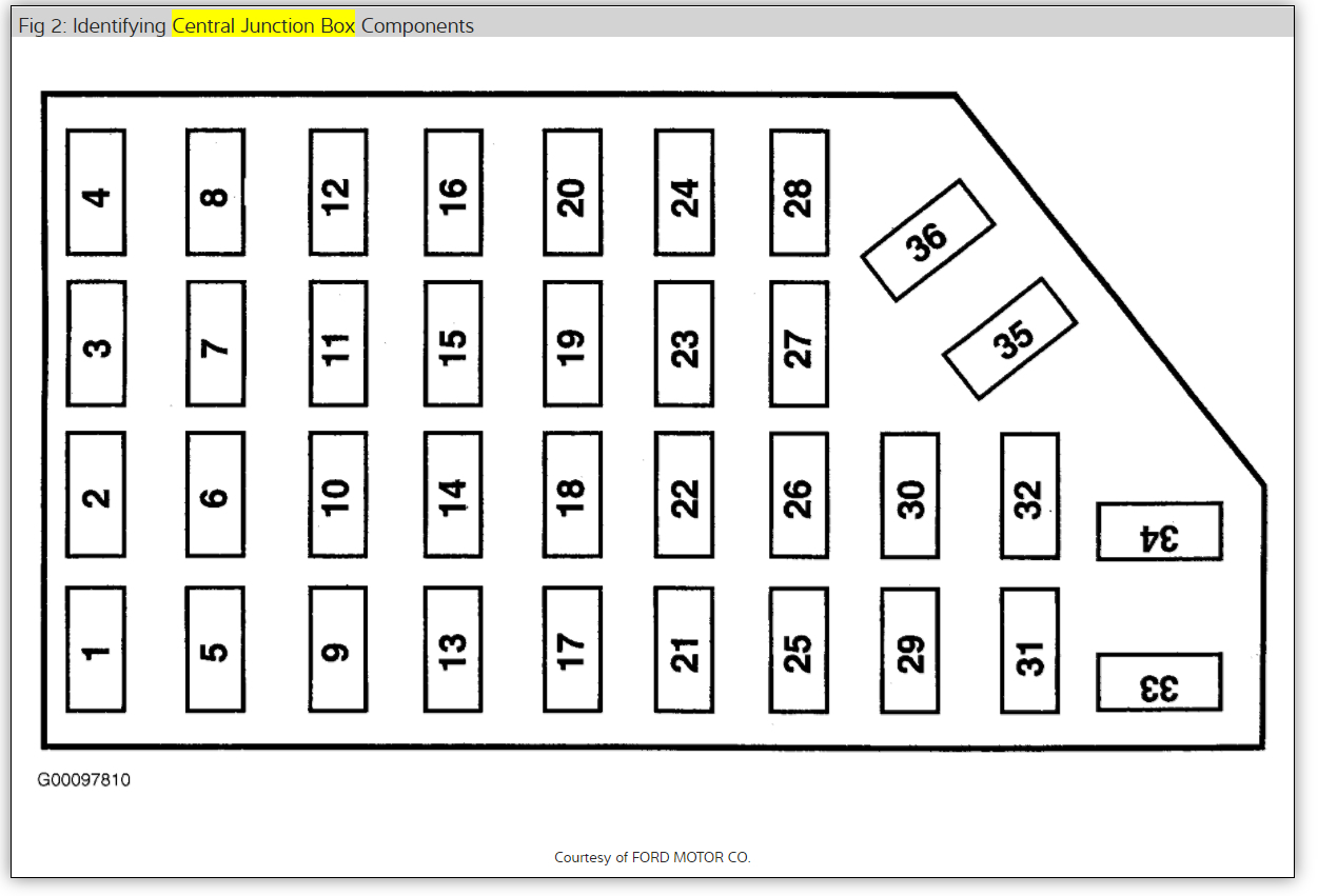

You are loosing power somewhere I would start by checking the power at the fuses here is a guide to help you and the blinker wiring diagrams below so you can see how the system works.
Check out the diagrams (Below). Please let us know what you find. We are interested to see what it is.
