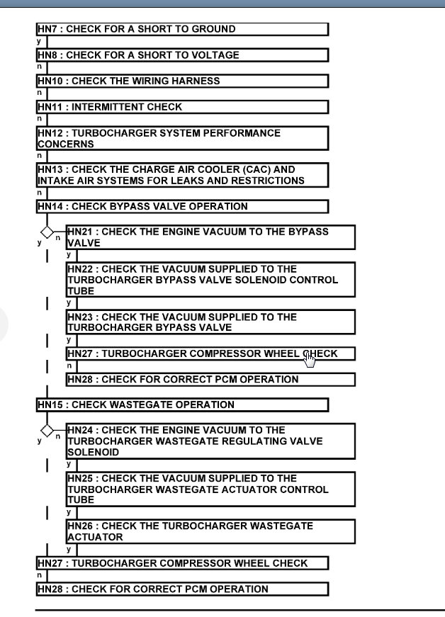

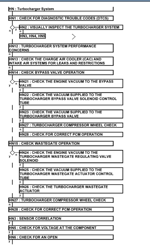

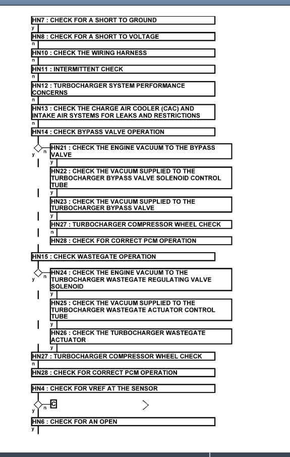

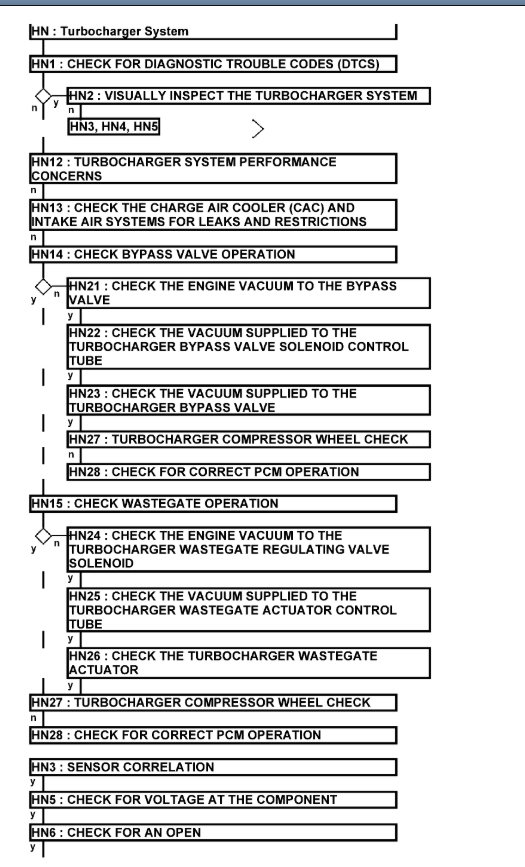

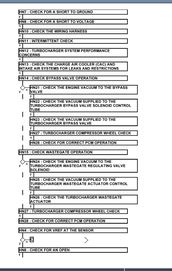

I have the car listed above ST3 model 247bhp on a 62 plate. while driving I lost power and no turbo, car still drives fine but with no power/limited power. there was no lights on the dash until I turned it off then on again and the engine management light came on.
