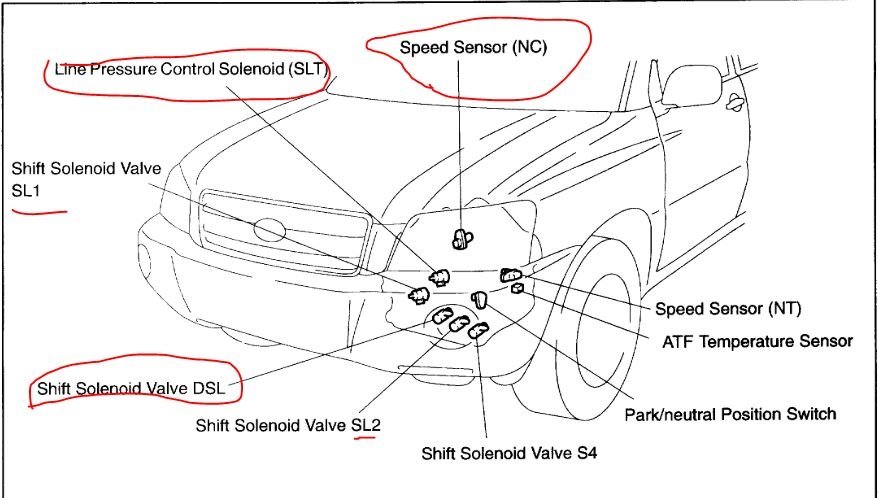

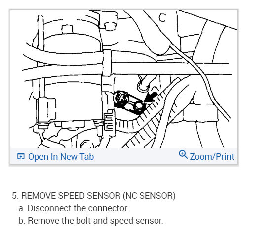

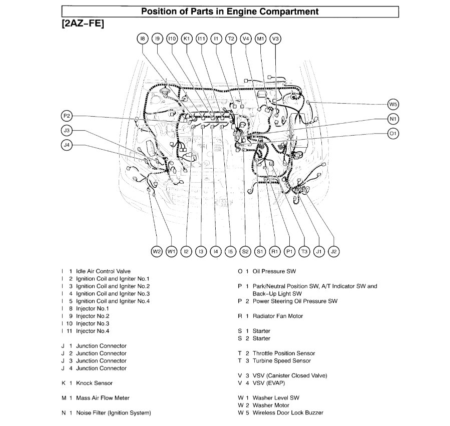

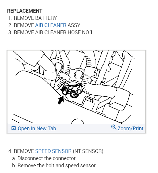

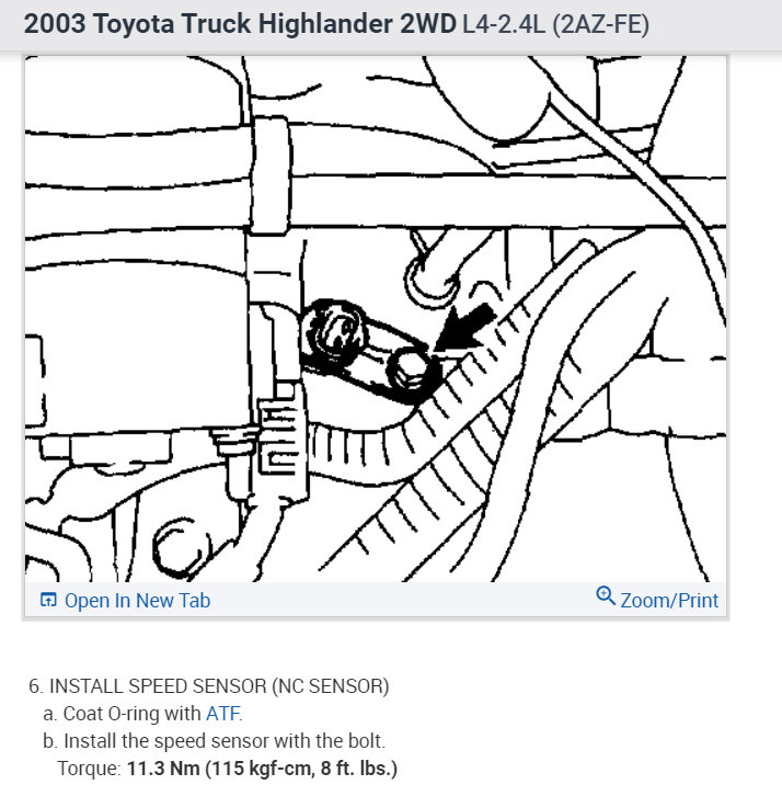

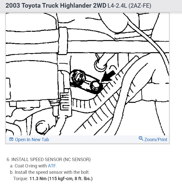

Even thought here are no codes I have seen the input (turbine) shaft speed sensor cause this issue . Here is the location so you can check it out and replace it.
Nov 21, 2019 at 4:50 PM
