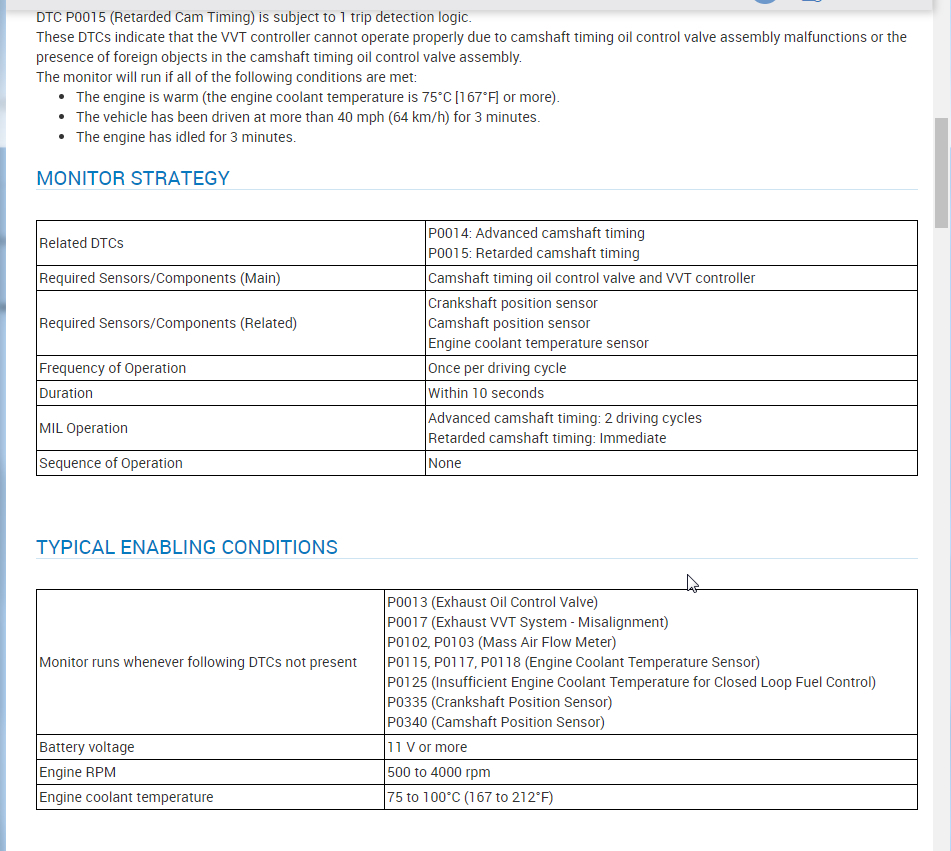

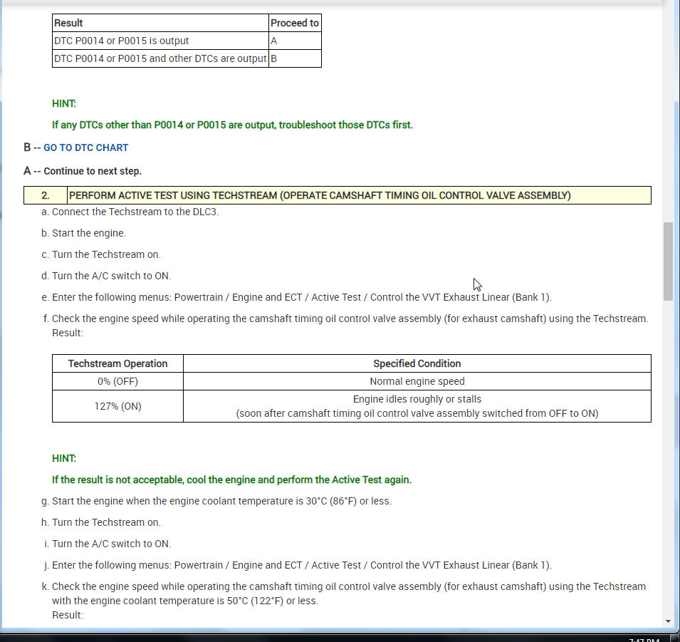

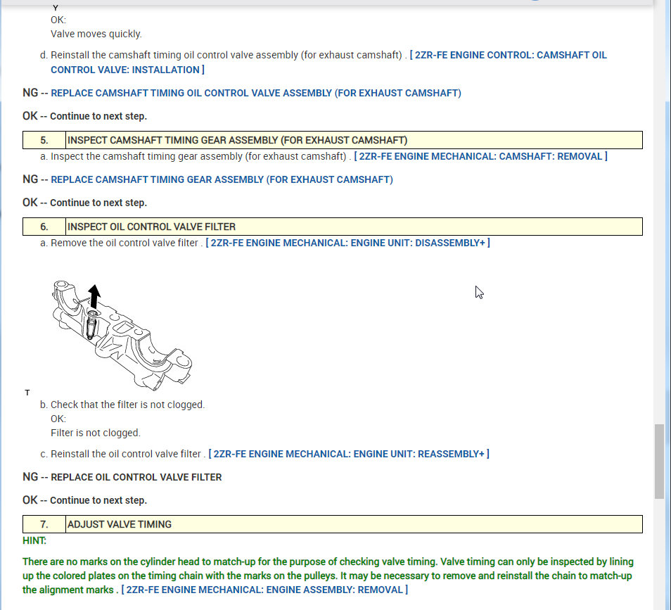

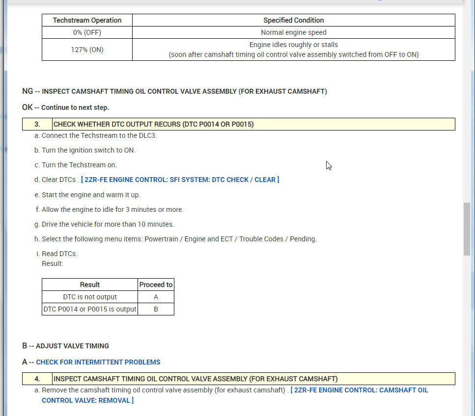

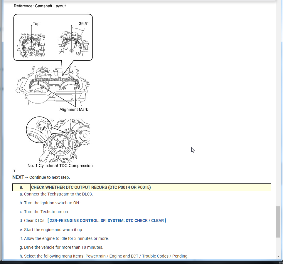

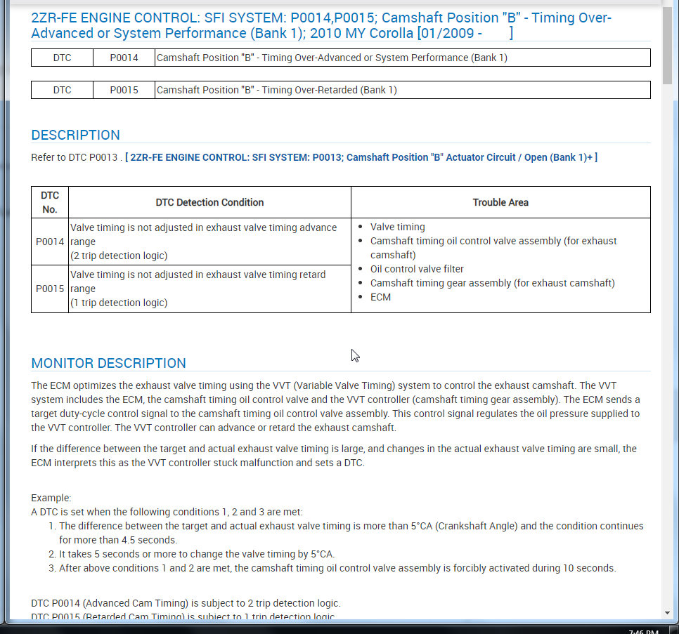

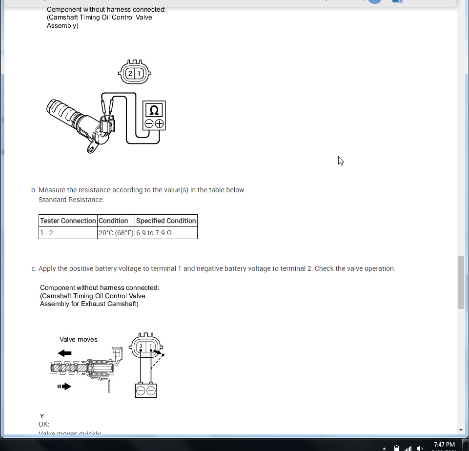

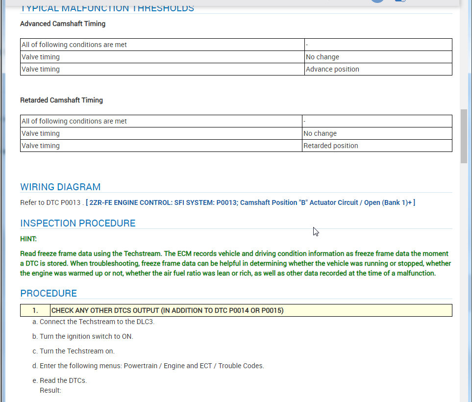

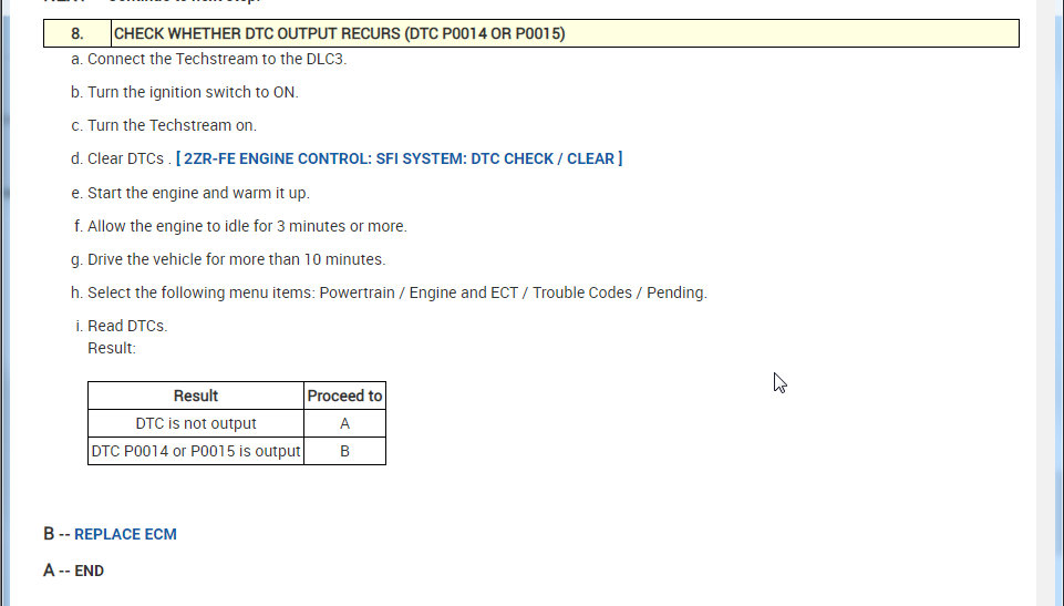

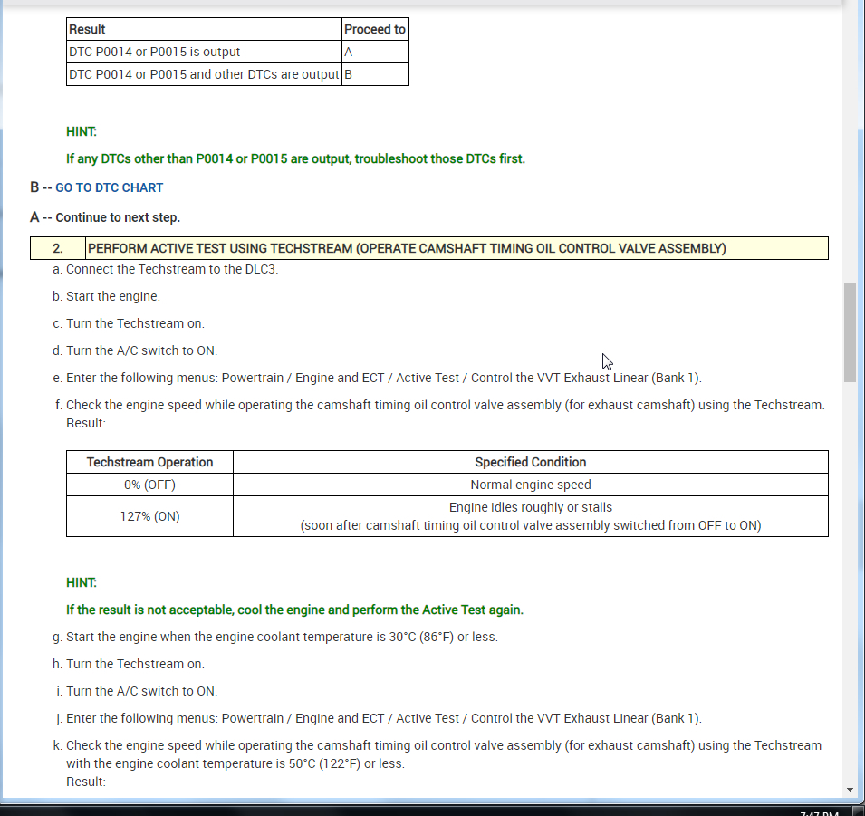

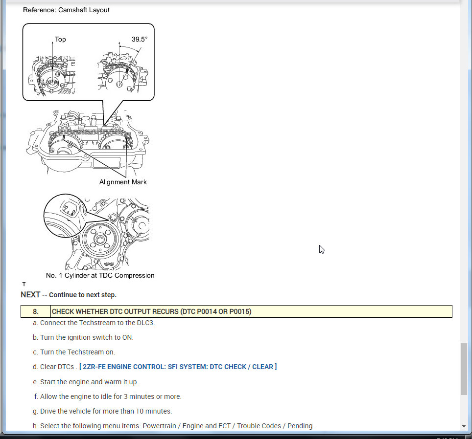

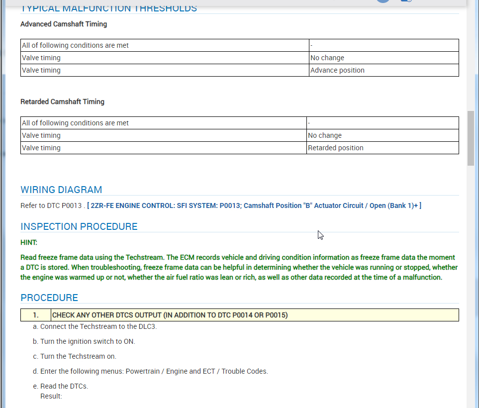

Unfortunately the ECM is seeing the cam out of time. This does not mean that the engine is actually out of time but it is not changing the timing of this camshaft when it is supposed to. So it is telling it to be in one place and it thinks it is not there. This system is called a variable valve timing system.
Here is a guide that will help with this:
https://www.2carpros.com/articles/how-camshaft-variable-valve-timing-works
Below you will find the testing that we need to run through in order to figure out what is needed. More than likely it is a cam sensor but it could be other things so it is a good idea to run through it.
Let me know what questions you have. Thanks
