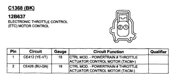

I've attached a picture of the connector for the throttle actuator. The yellow/violet wire is your power, the blue/green is the ground. Check for power and ground on both using this guide.
, let us know what you find.
