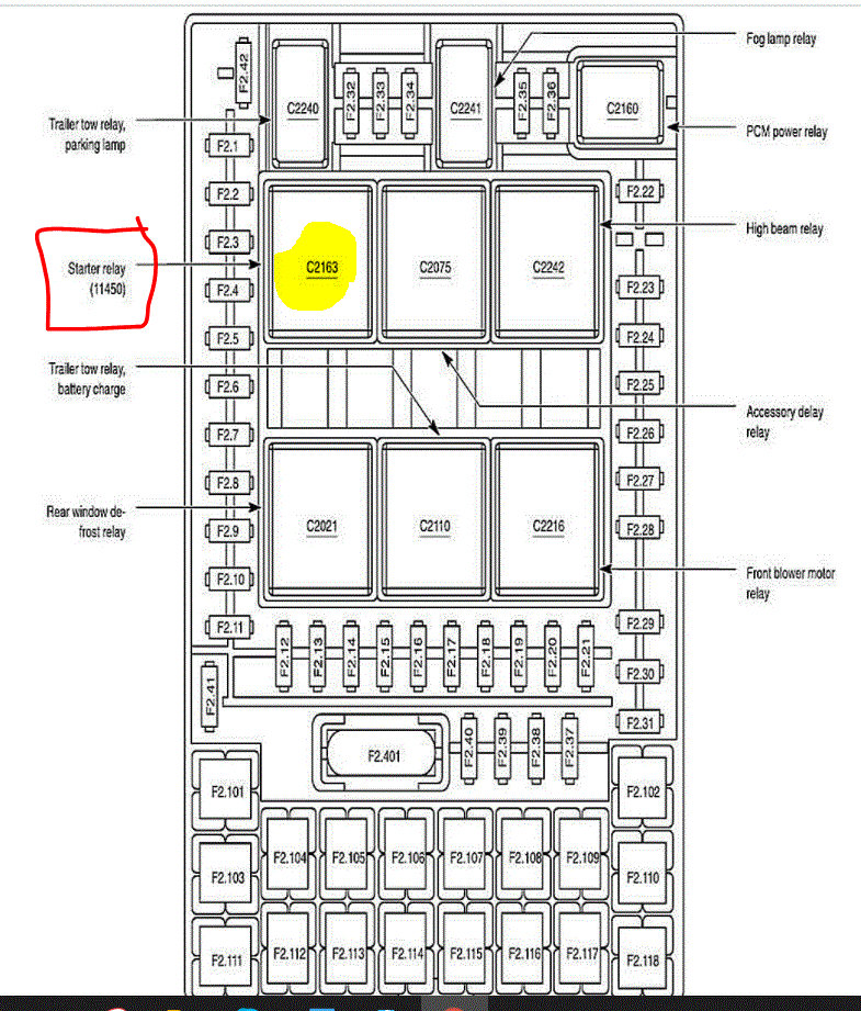

I will do my best to help. I need more information. When you say the vehicle does a "half jerk sound," do you mean the starter stops? If that is the case, a fuse won't make a click, so it is likely a relay.
If you look at pic 1 below, it shows the central junction box. I highlighted the starter relay. Place a finger on it and see if you feel the clicking.
