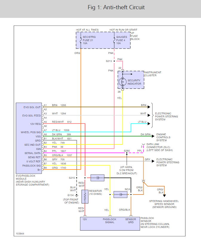

It sounds like the passlock module is having a problem. I would remove it to check for water damage and to see if there is corrosion at the terminals.
PASSLOCK/Electronic Variable Orifice (EVO) Module Right Side Of Instrument Cluster, Behind Air Duct
Here is the wiring diagrams for the system so you can see how ti works. Check out the diagrams (below). Please let us know what happens. Cheers, Ken

Found and air dryer module with low air pressure. Cleaned connections with electrical contact cleaner and air dryer them. Truck started. Waiting for it to rain to see if this works. No moisture or corrosion found anywhere

Danny. Done just what you ask me to do. So far it has been starting every time. It has rained here the last three weeks an it has not failed to start. Did not see any moisture in module or on connectors but something differently work. Thank you so much for y’all helping me. You guys are great.
