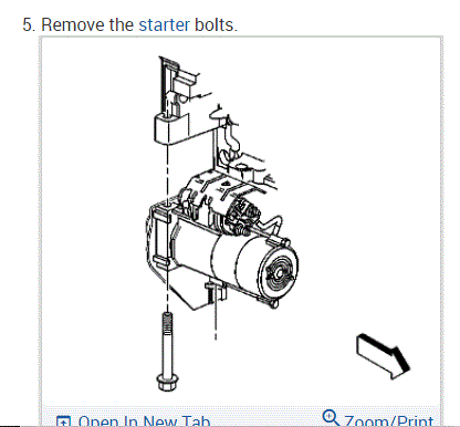

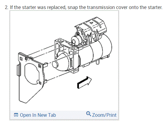

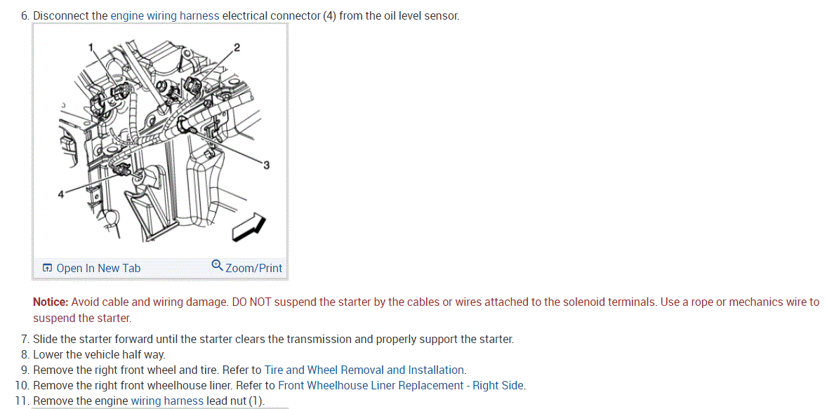

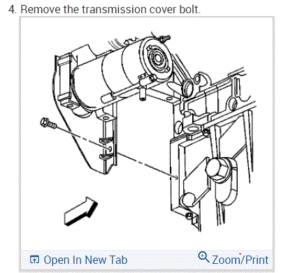

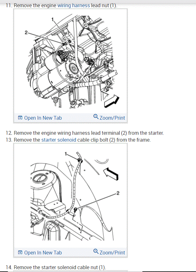

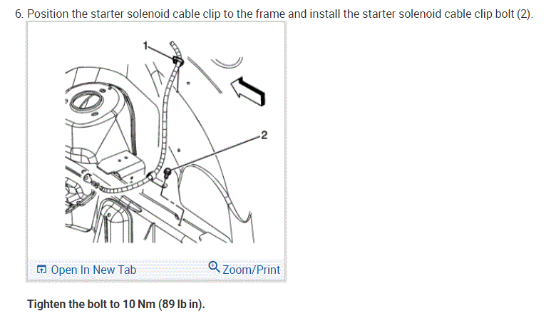

If the starter is turning the engine, it could be a few things. First, take a look through this link. It identifies the most common causes of a crank no start condition.

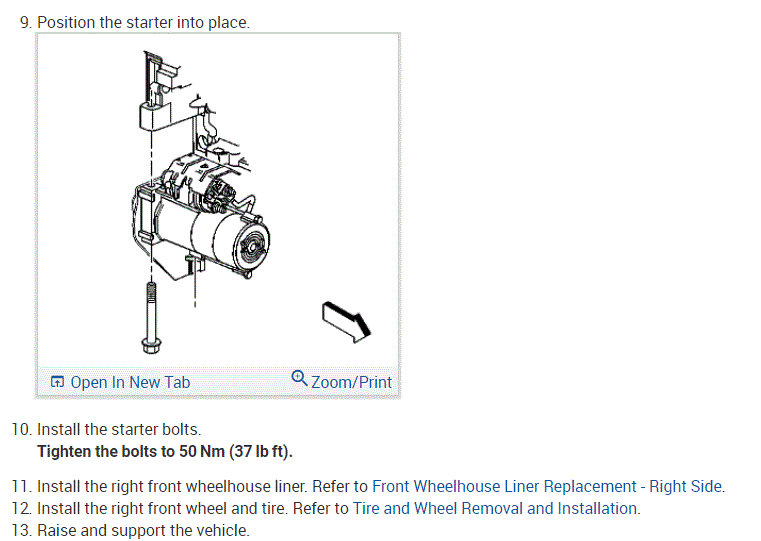

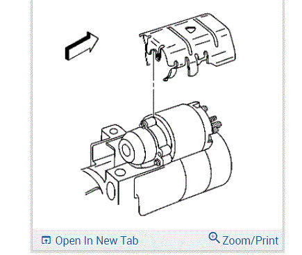

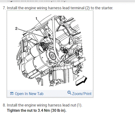

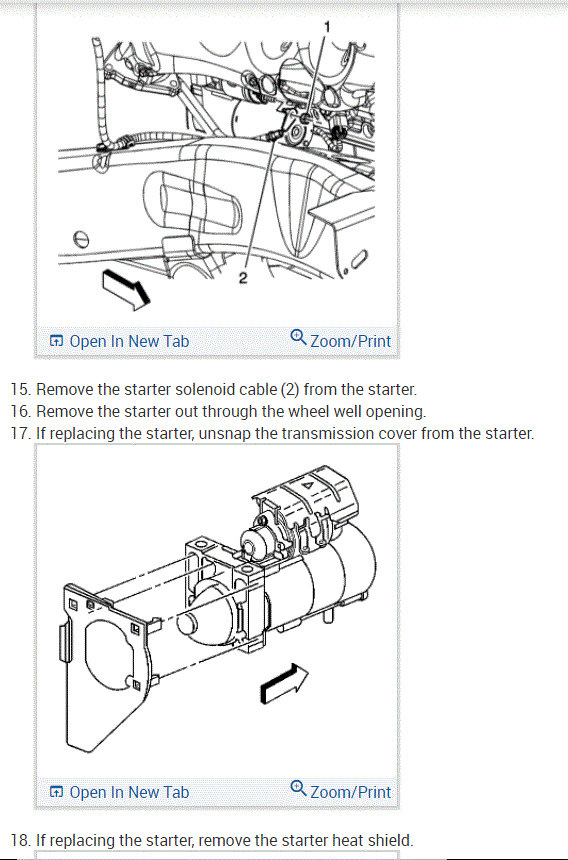

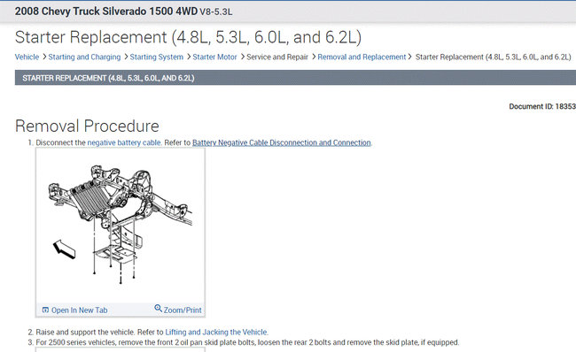

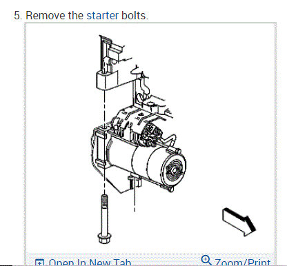

Next, if the starter spins but doesn't turn the engine at all, chances are you need to replace the starter because the Bendix isn't engaging the starter/flywheel.
If that is the case, here is a link that shows in general how it's replaced:

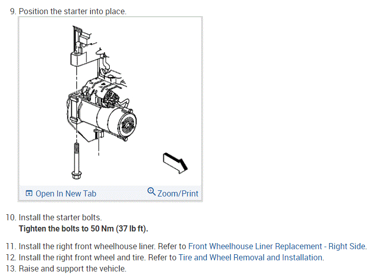

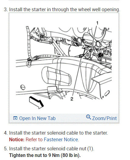

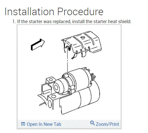

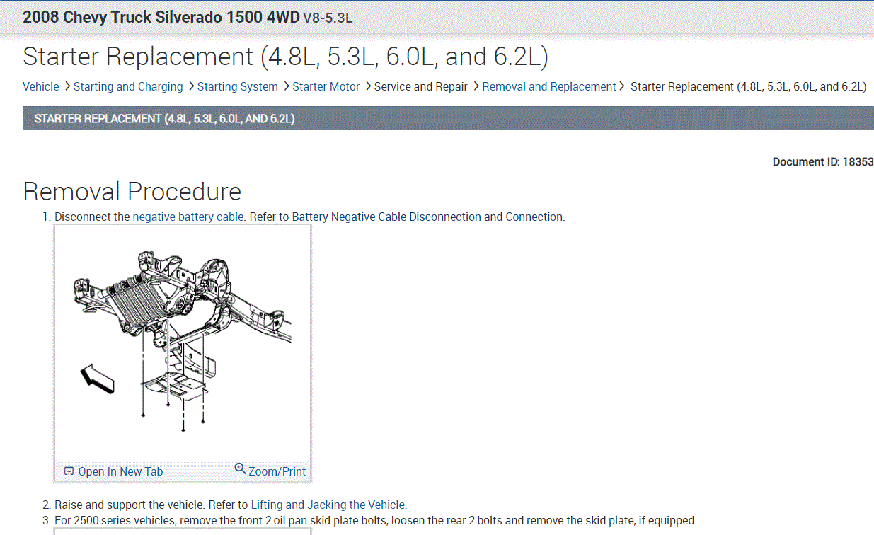

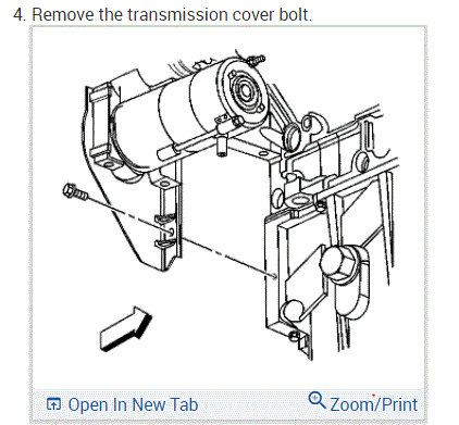

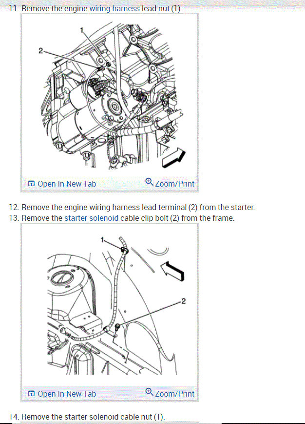

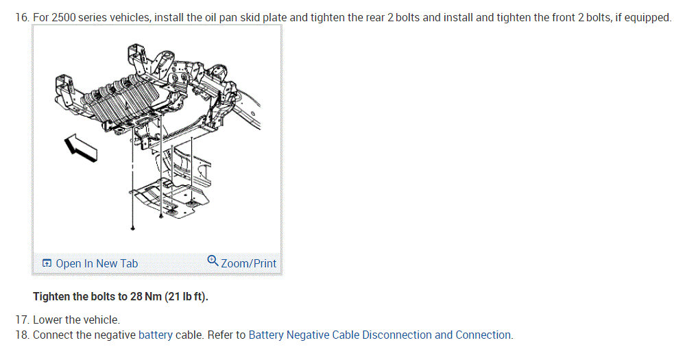

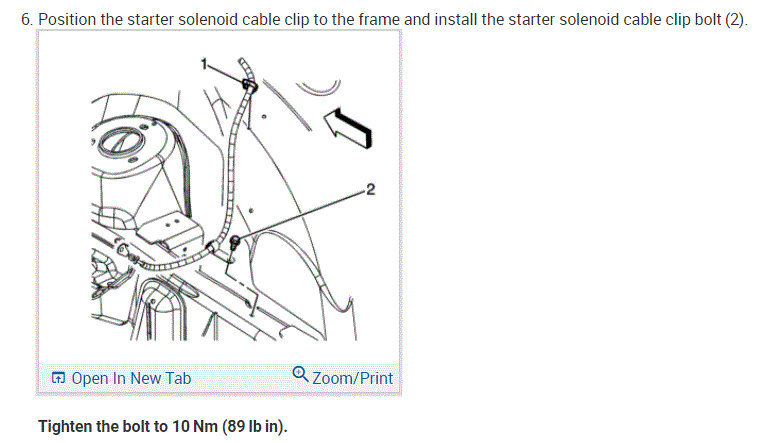

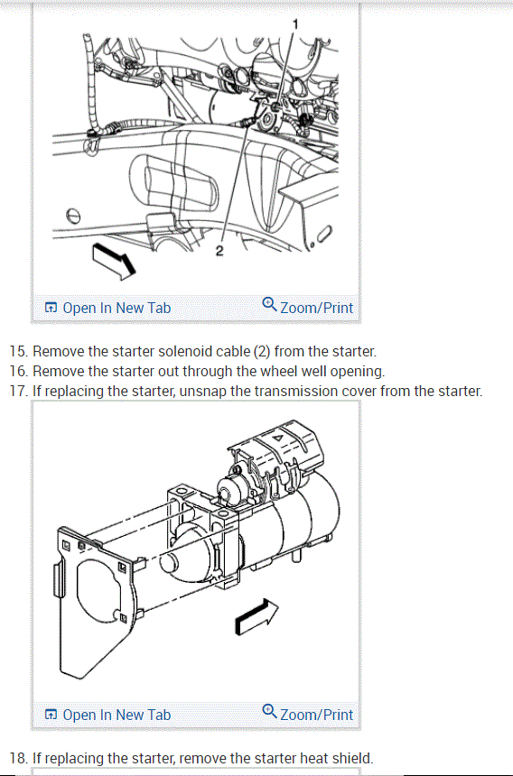

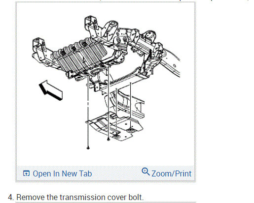

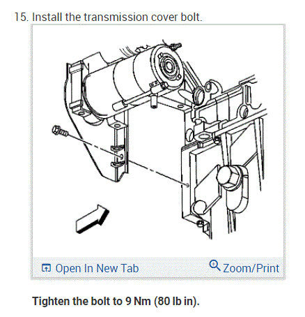

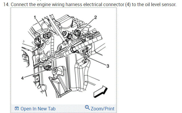

If you look at the attachments below, they provide the directions specific to your vehicle for replacement.
Let me know what specifically is happening so I can better direct you. Also, if it is possible, record what is happening and upload it for me to hear. It may help.
See pics below.
