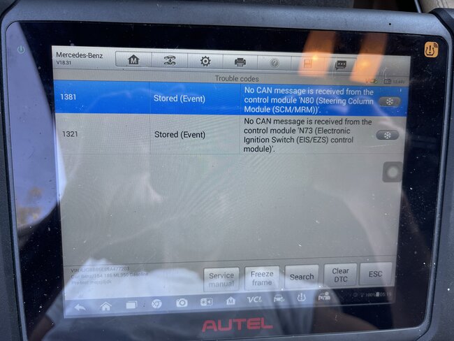

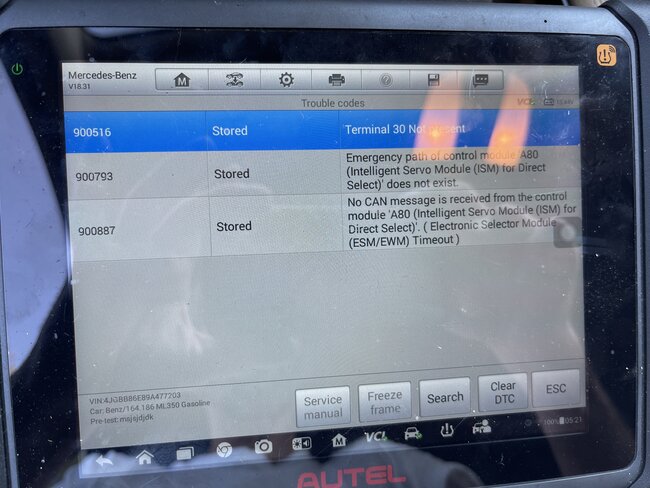

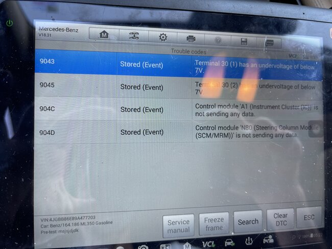

While its still running i scanned it.
Aug 18, 2023 at 6:23 AM

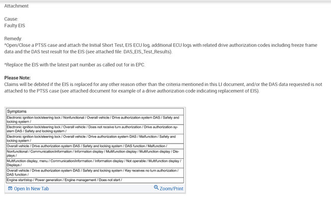

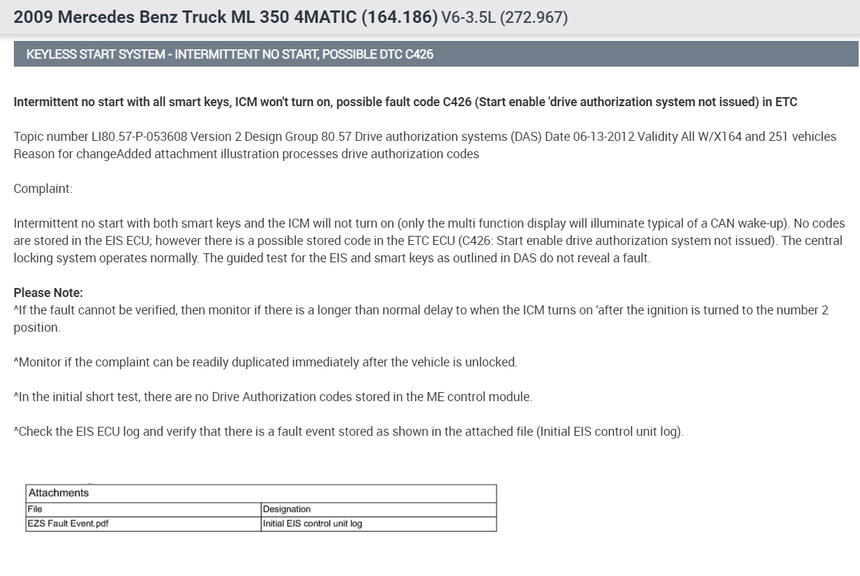

I would start by checking all fuses with the systems on.

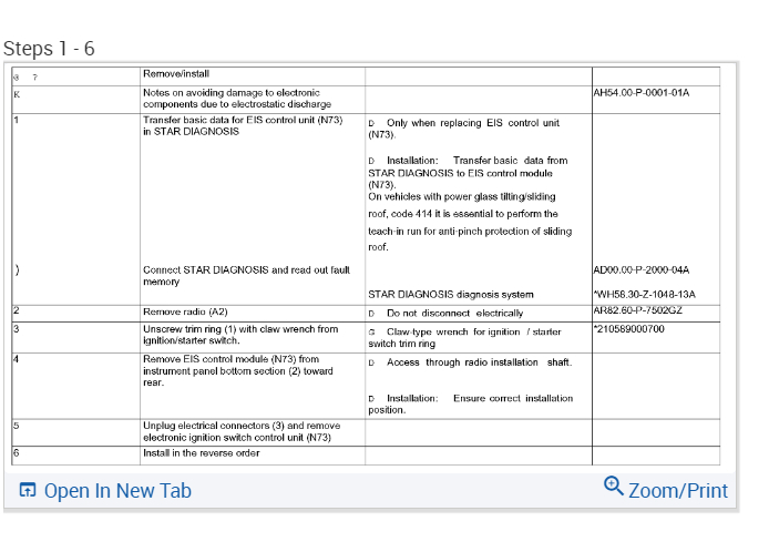

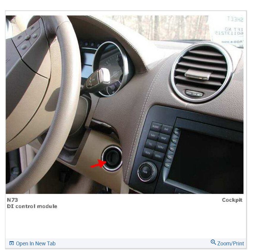

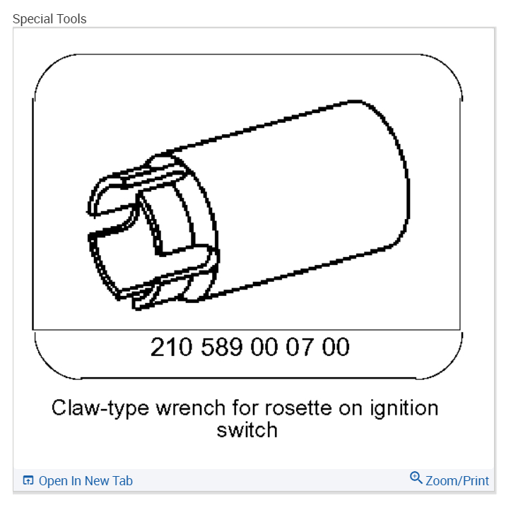

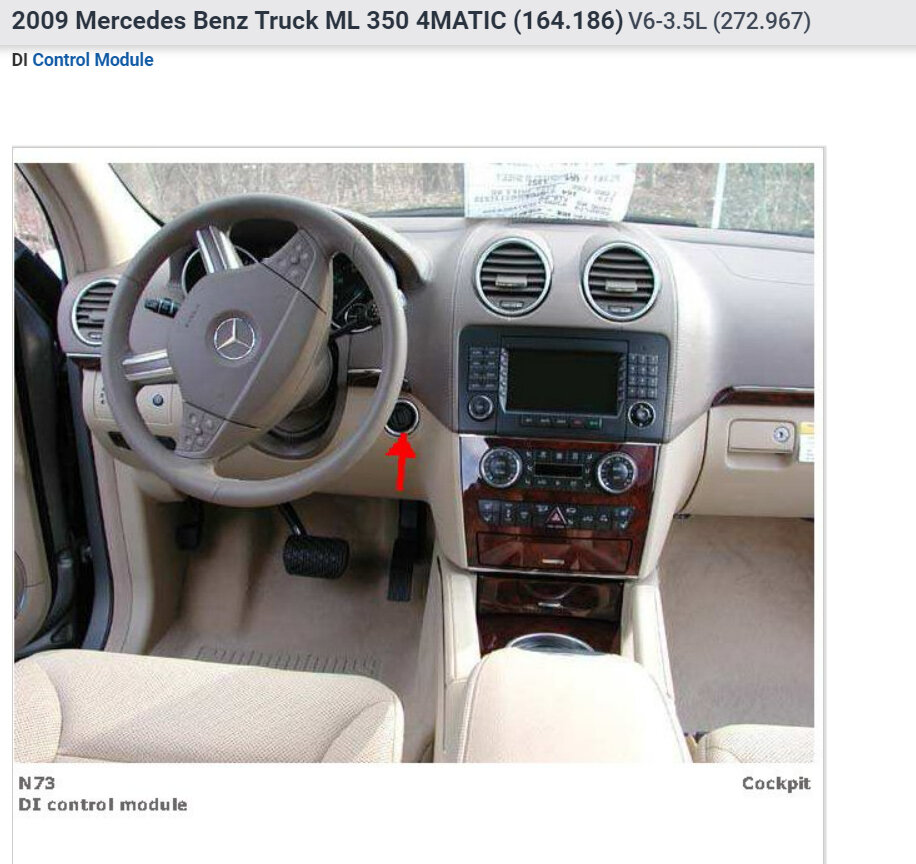

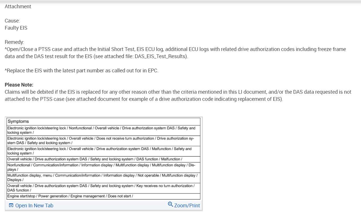

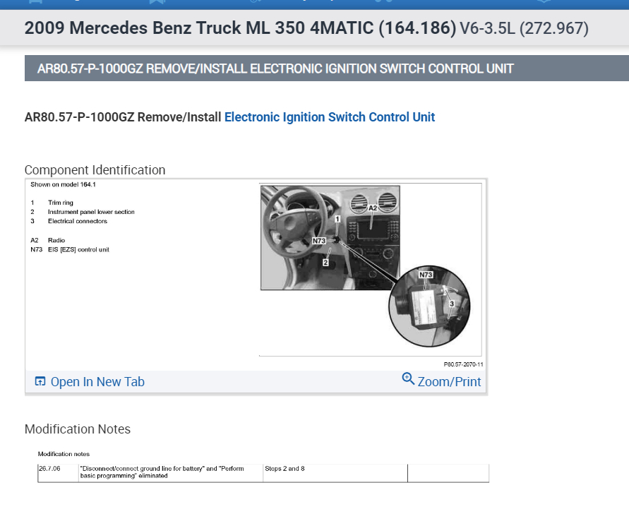

If the fuses are good, it sounds like the EIS needs to be replaced. There is a TSB for this problem which I have attached.
