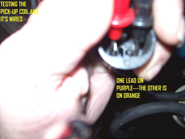

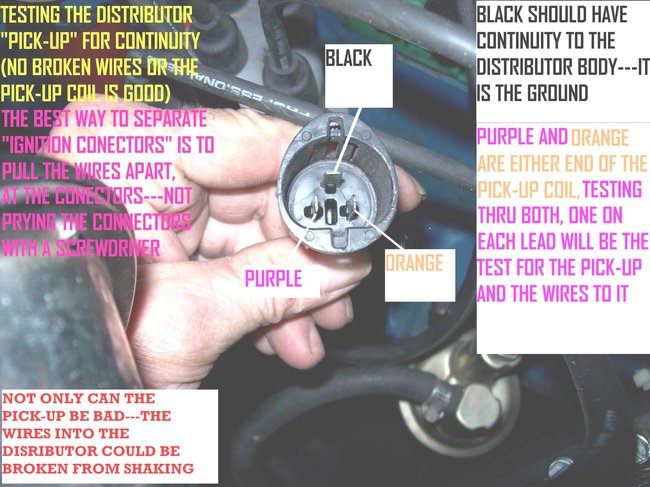

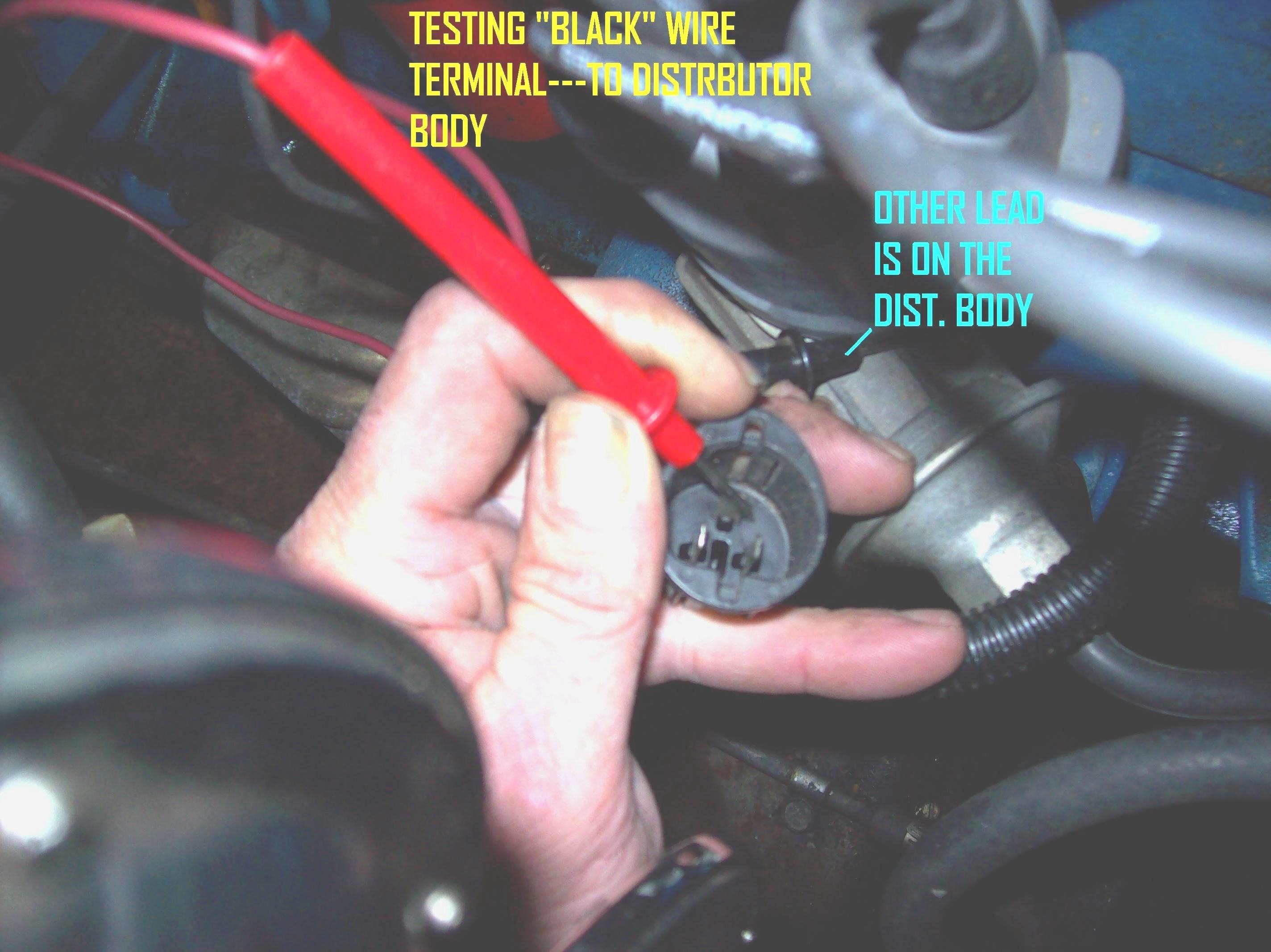

Let's try some pics! One day I'll make better ones.
pic 1) good circuit-continuity
pic 2) bad circuit- no continuity
pic 3)Test 1- black ground to distributor body
pic 4) Test 2 - distributor pick-up coil
pic 5) explanation pic

checked today.
Test 1 good ground have continuity.
Test 2 no continuity. is that a bad pickup in the distributor?

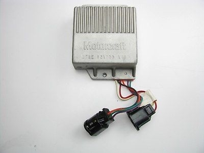

You are sure this is Motorcraft, using this type module below?
I think Omix-Ada markets just that piece (without getting a whole distributor) Let me know, I'll see If I can help find one.
The Medic
Jan 2, 2020 at 4:37 PM
LOST53
  • 8 POSTS
yes that's the ign control module I replaced.

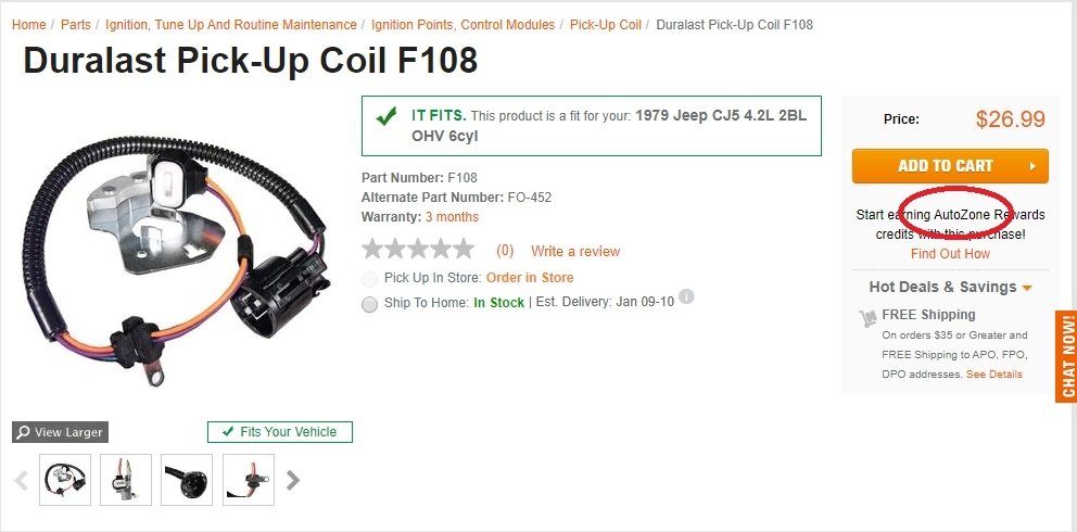

Found one!
Year is just fine.
See my pic
The Medic

Thanks for finding the part. Purchased today and installed. Still no spark no start. I have attached a pic of the new ignition control module and distributor. Still lost since the unit was running. Hoping to get this running. Thank you for all of your help. I know it's difficult doing this over the internet.

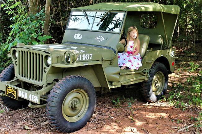

I was proud of my '46 Willys (and all of my "5"s) from day one!
"Willy" was a "field find" right beside an old tractor.
Last pic) My daughter recently threw him a party, she was four when we found him. Willy taught her how to drive when she was 8.
