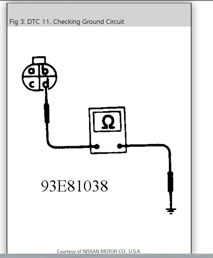

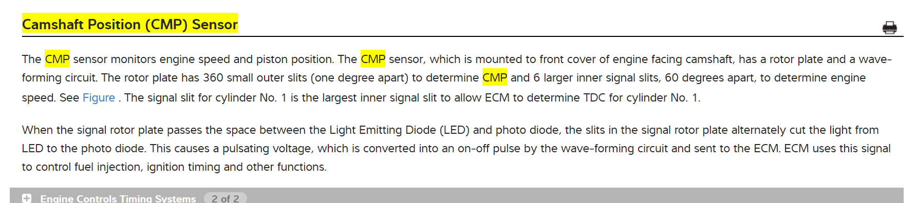

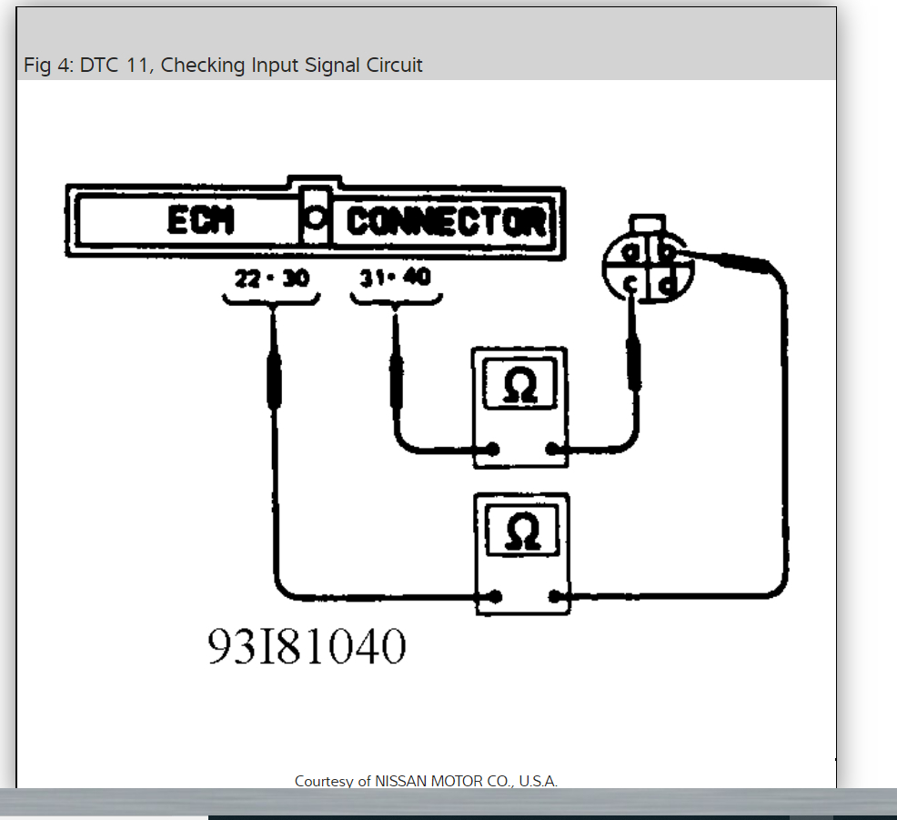

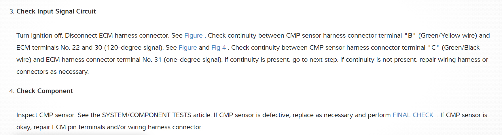

My vehicle shut off on freeway, wont start, no spark. changed the crank angle sensor (camshaft sensor), coil, ICM, distributor cap and rotor, plugs, plug wires. still no spark except in number one cylinder after i crank engine and return key to on position. it is loud and shoots spark out of the boot from 2" away from a ground. what could this be?
