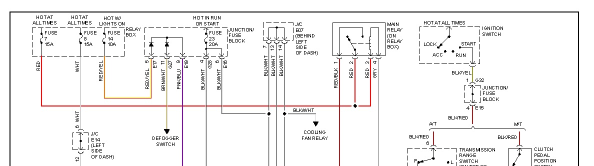

this may sound stupid but did you check the main relay which powers the pcm and the fuses underhood?

timing belt is good and timed correctly. if the relay was out wouldn't it throw a code immediately? that has always been my experience with the pcm. fuses all check good as well. by the way it cranks over very well just no spark it fires one time through the spark tester then nothing no matter how long it cranks

there is no code for the relay.

when it came to me there was no power due to faulty alternator. so the computer has been reset. and what i meant is wouldn't it throw a code for the pcm or one of the control system sensors if no fire is detected. and yes i tested all the relays under the hood and the fuses as well ( was tryin to leave nothing to chance lol) i know when this gets figured out i'm gonna feel like a bozo cause its bound to be something simple that has been overlooked.
