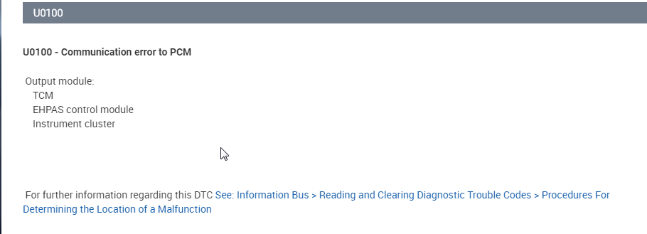

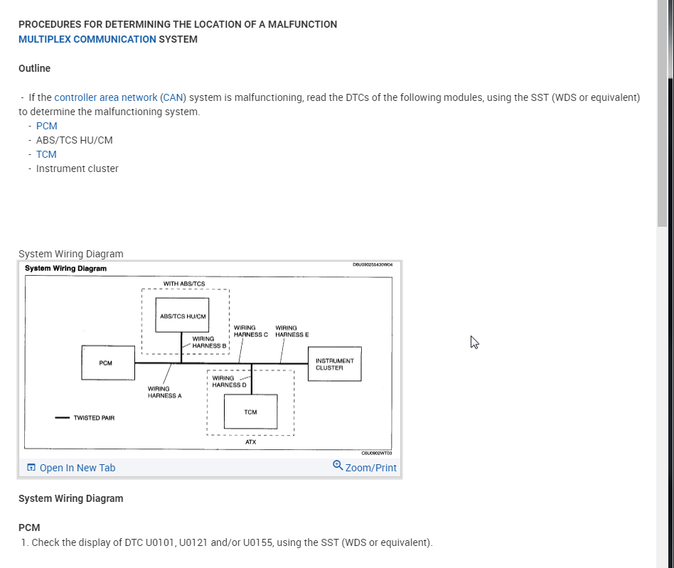

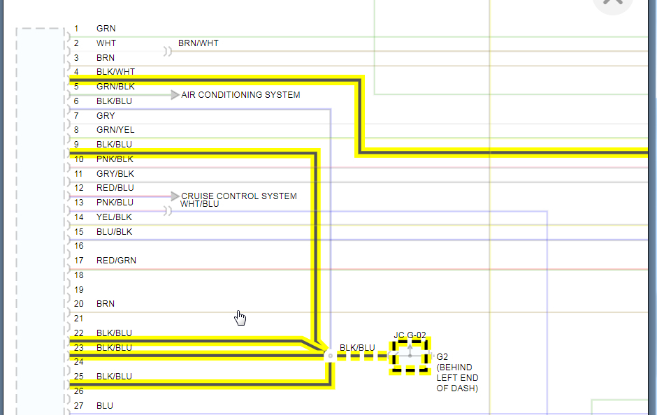

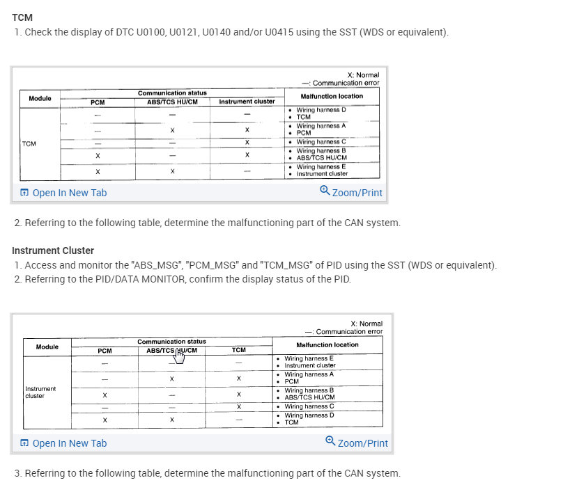

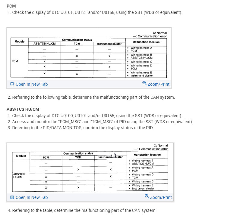

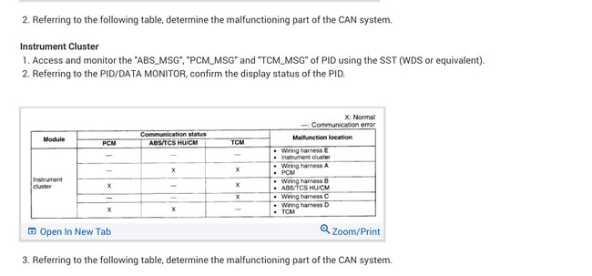

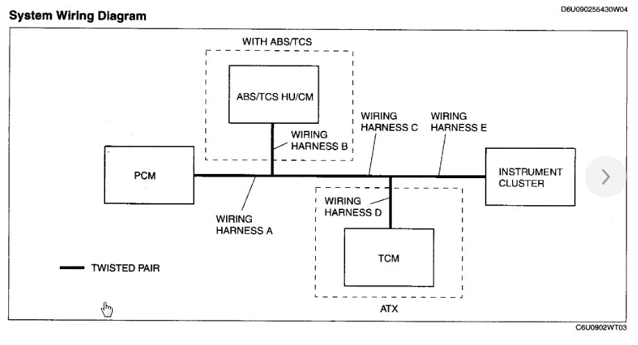

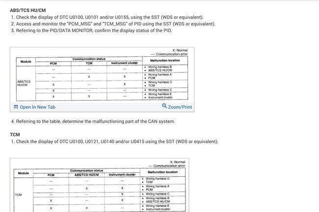

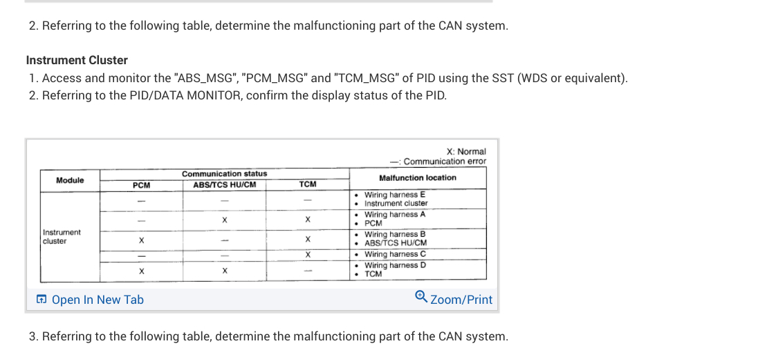

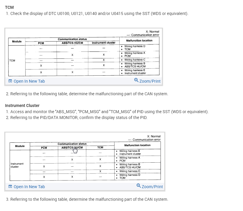

I attached code reader got one code U0100 lost communication with ECM/PCM A
I went immediately checked my ECM wire under hood near fuse box and it fine no burn nothing just crusty gel substance.

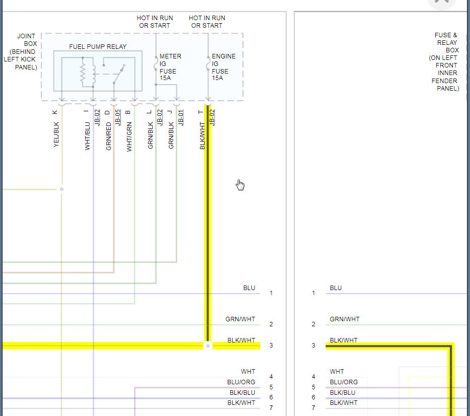

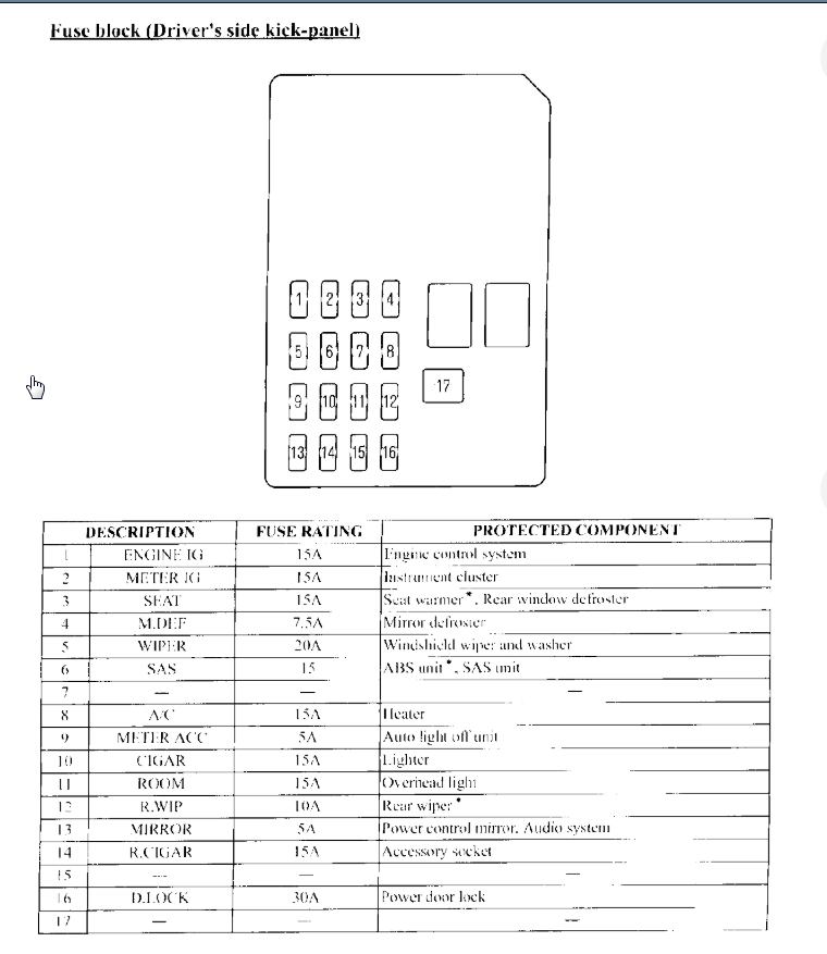

I then tested fuse have no clue it going this right but had key in on position and got read from the fuses except the:
*Injector fuse
*Engine bar fuse
ECM fuse under car on driver side nothing works in the fuse box on driver side just to note but again in not sure if i'm using multi-meter correctly.
I have no idea why my car randomly stop working when it was just working please can someone point me in right direction?
