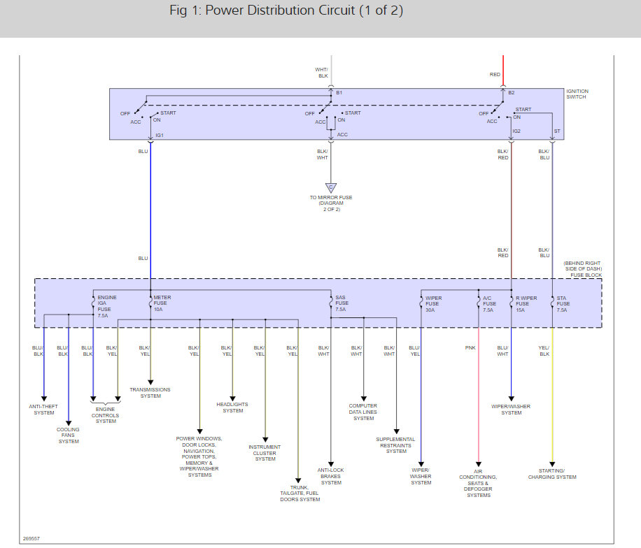

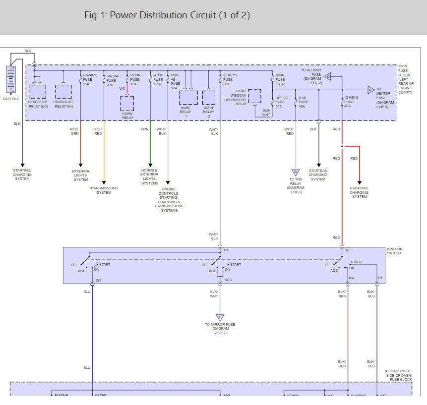

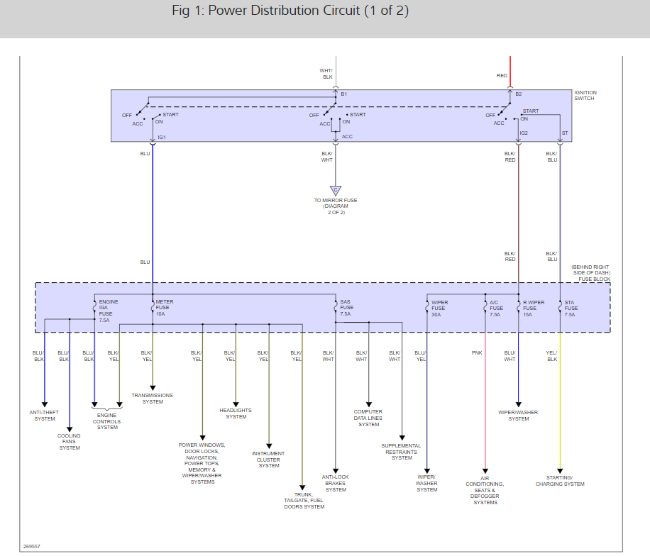

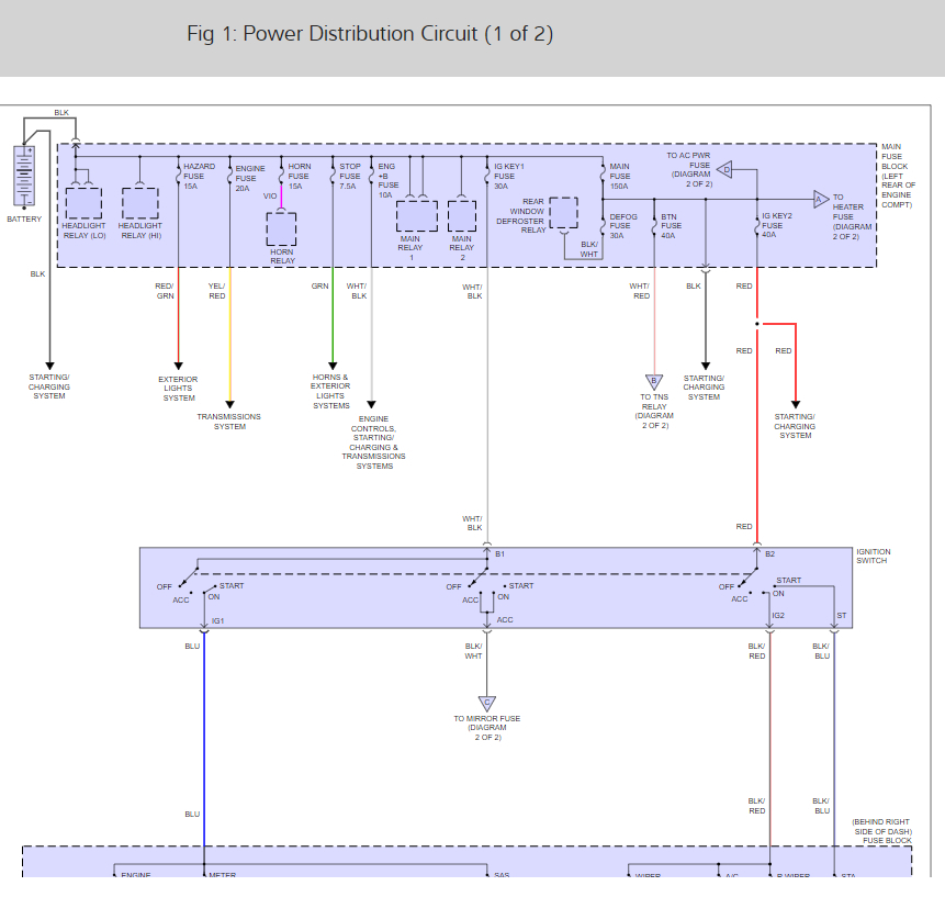

When the ignition position is on the cooling fans are on full blast and when I disconnect the fan relay The TPS sensor starts to buzz. I've already tried jumping the starter relay to make sure it's okay I tried replacing the battery I tried replacing the throttle body and I tried replacing the PCM and nothing has worked yet. Any help is appreciated.
