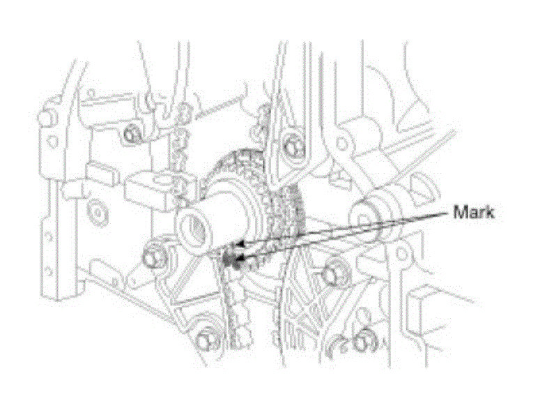

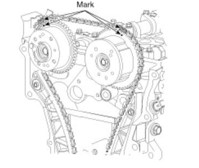

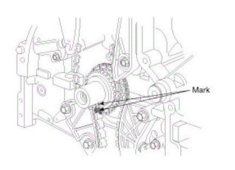

Good afternoon,
The timing chain can fail at anytime. There is no warning.
https://www.2carpros.com/articles/how-a-timing-belt-works
How many miles on the car? It should be changed at 150,000 miles as preventive maintenance so this does not happen.
His test was little out there but accurate. If there is no compression, it is an interference engine which means you have valve damage and possible piston damage. We would also recommend a replacement engine as well.

Ugh... I knew you were going to say that, and also as I expected. just thought a second opinion would make me feel better as I felt his 5 minute test was not thorough enough to determine a new engine. Now if he said low compression would that be the same outcome as no compression meaning I would need a new engine still or could it be something like the timing belt, or camshaft etc., that would be cheaper to fix?
Jul 20, 2020 at 1:18 PM
It would indicate the chain moved or failed but could still cause the same damage.
