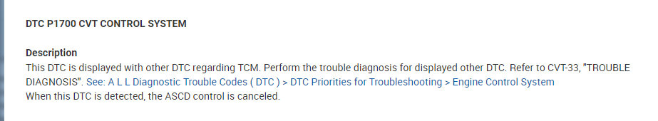

We need to start with the basics and find out if we have spark and fuel to determine what direction to go. The reason is, neither of these codes by themselves is going to cause a no start.
So that mean we need to find out if we have fuel and spark and go from there.

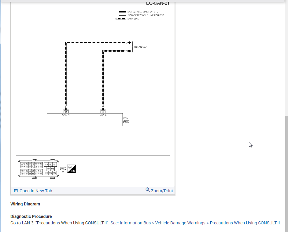

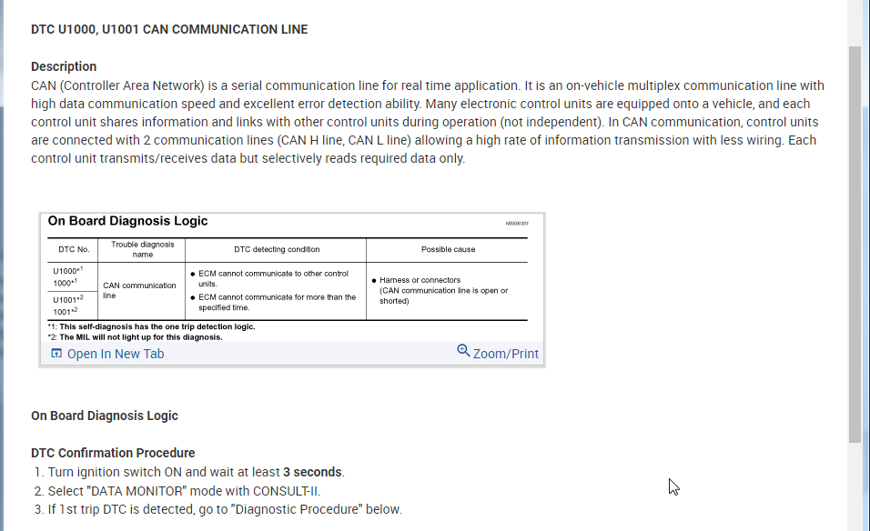

The only one I am concerned with right now is the U code as that is a communication code with the ECM. Here is a guide that talks more about this network as we may need to go down this road depending on what we find with fuel and spark:
https://www.2carpros.com/articles/can-scan-controller-area-network-easy
