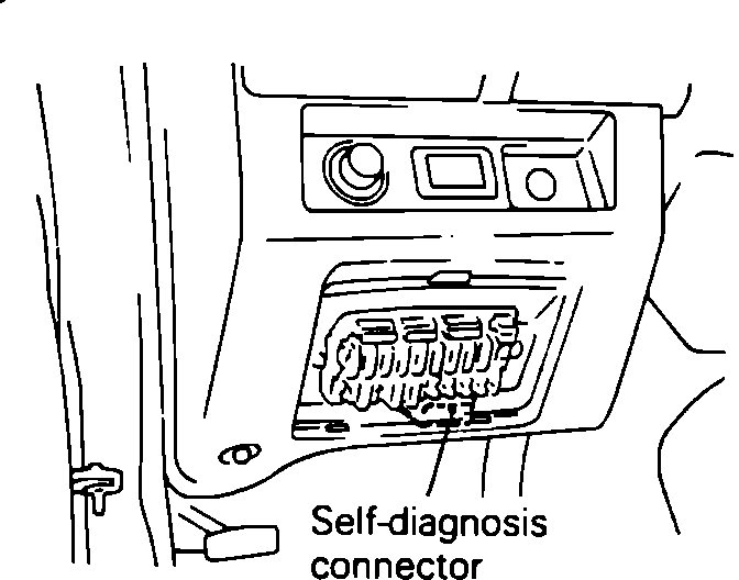

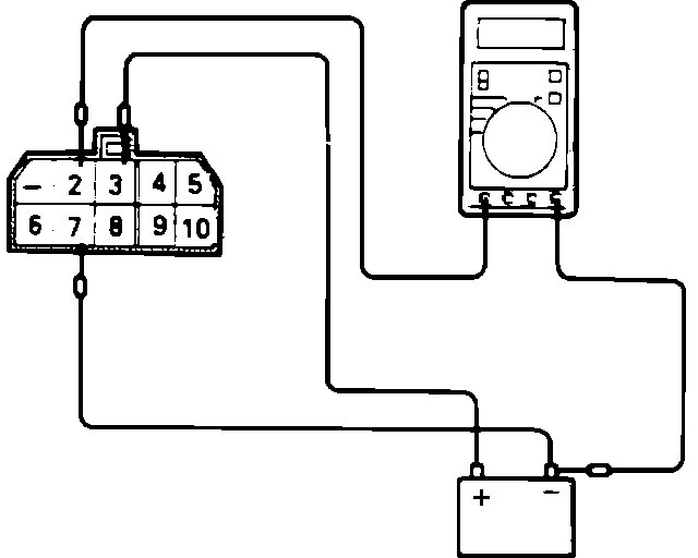

Self-Diagnosis Connector Location
2. Does the ECU output a steady 12 vdc at the diagnostic check connector?

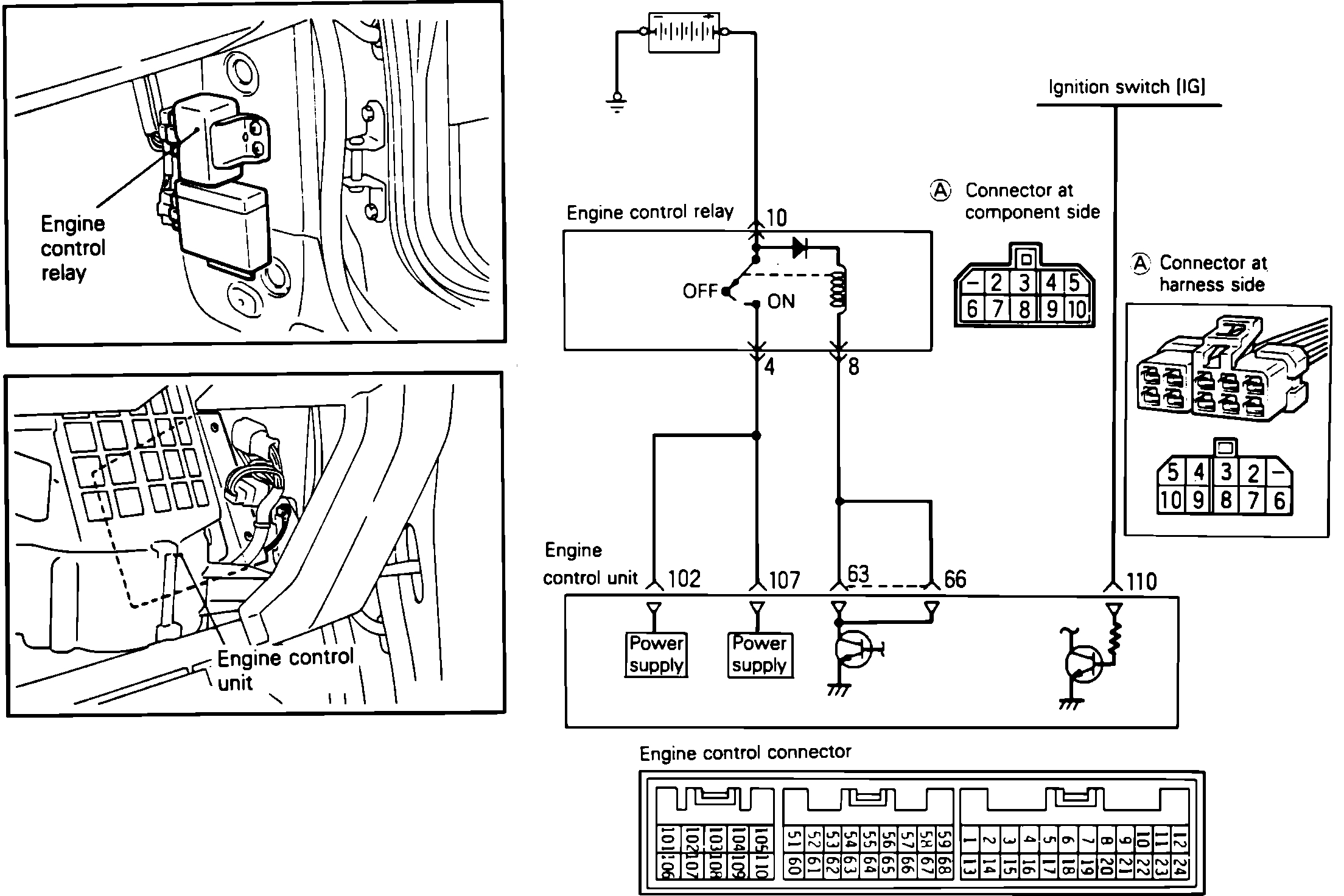

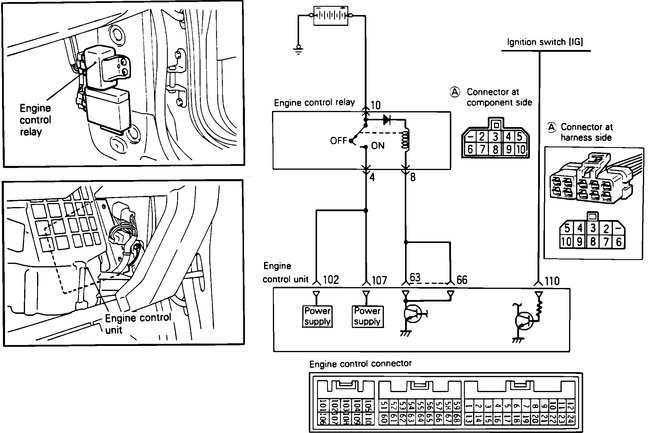

a. If not, and the ECU is suspected to be faulty, check the POWER AND GROUND CIRCUITS test to confirm that the ECU is being supplied with power and ground.
b. If so replacement of the ECU is required.
NOTE: Before replacing a ECU that is found to be faulty, insure that no other condition exists that will damage the new unit. This can be best done by testing the inputs and outputs to the ECU for over voltage/inappropriate power readings or grounds. Use the image in CHASSIS ELECTRICAL DIAGRAMS and the individual component testing procedures to identify the correct readings for each pin. Check all pins (at the harness with the ECU removed) that supply a signal to the ECU, for their correct readings and check all other pins to insure that there are no uncalled for voltage readings or grounds present.

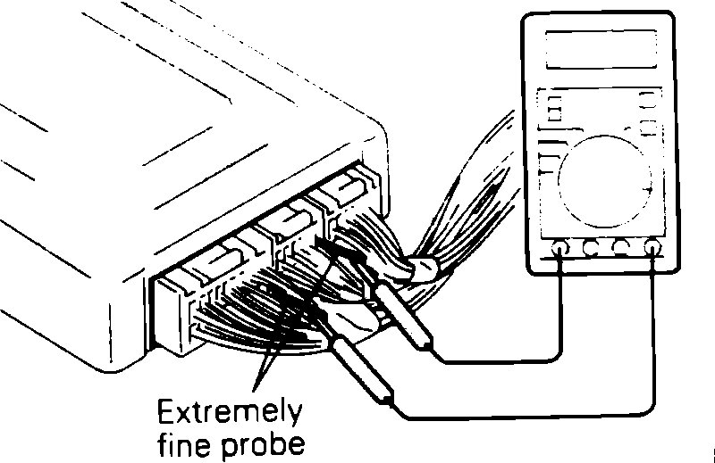

ECU Probing Technique
To test pins using a multi-meter do not remove the connector from the ECU, instead insert a straight pin or needle from the back side of the connector to access each pin.
NOTE: Before replacing an ECU that is found to be faulty, insure that no other condition exists that will damage the new unit. This can be best done by testing the inputs and outputs to the ECU for over voltage/inappropriate power readings or grounds. Use the ECU Terminal Identification image and the individual component testing procedures to Identify the correct readings for each pin. Check all pins (at the harness with the ECU removed) that supply a signal to the ECU, for their correct readings and check all other pins to insure that there are no uncalled for voltage readings or grounds present.
