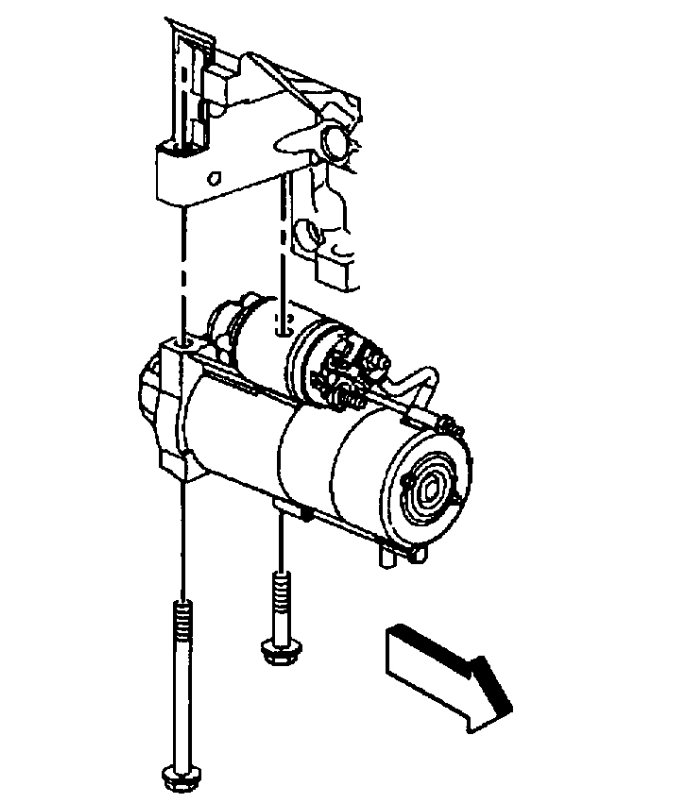

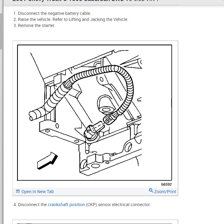

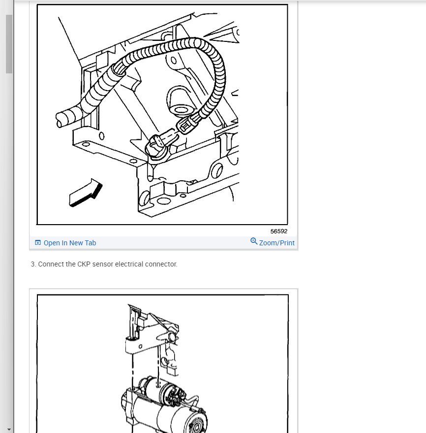

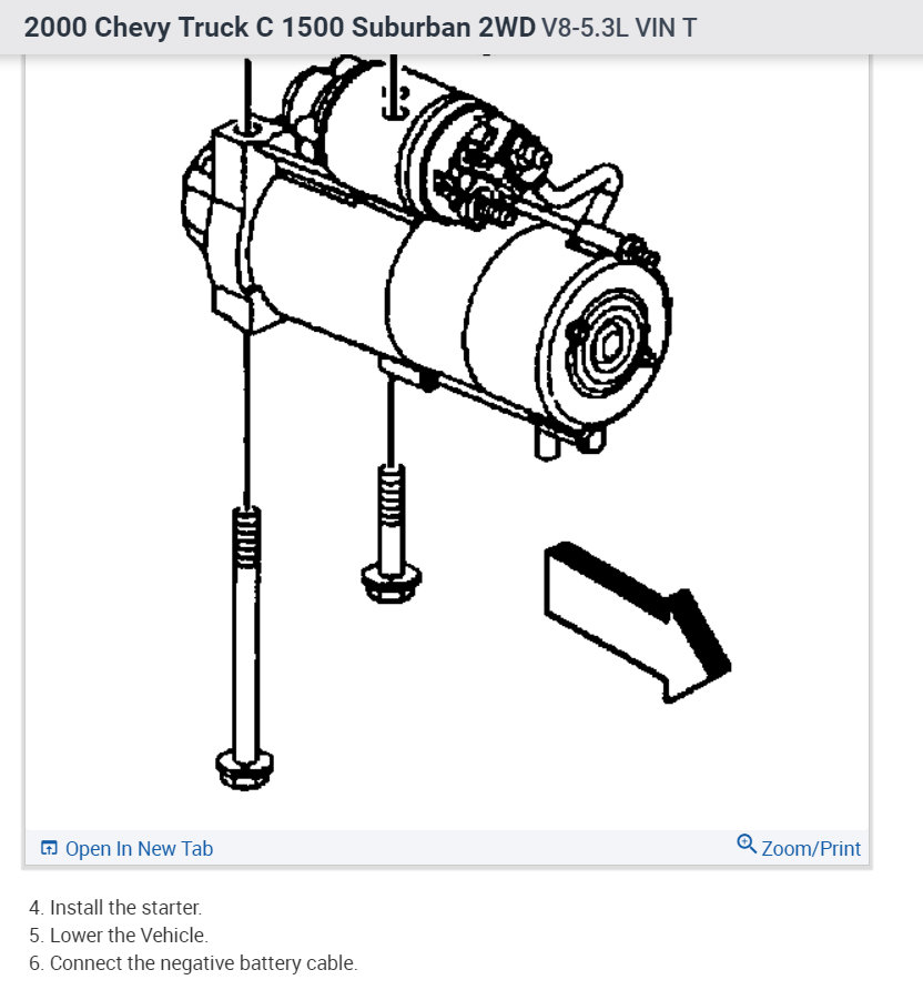

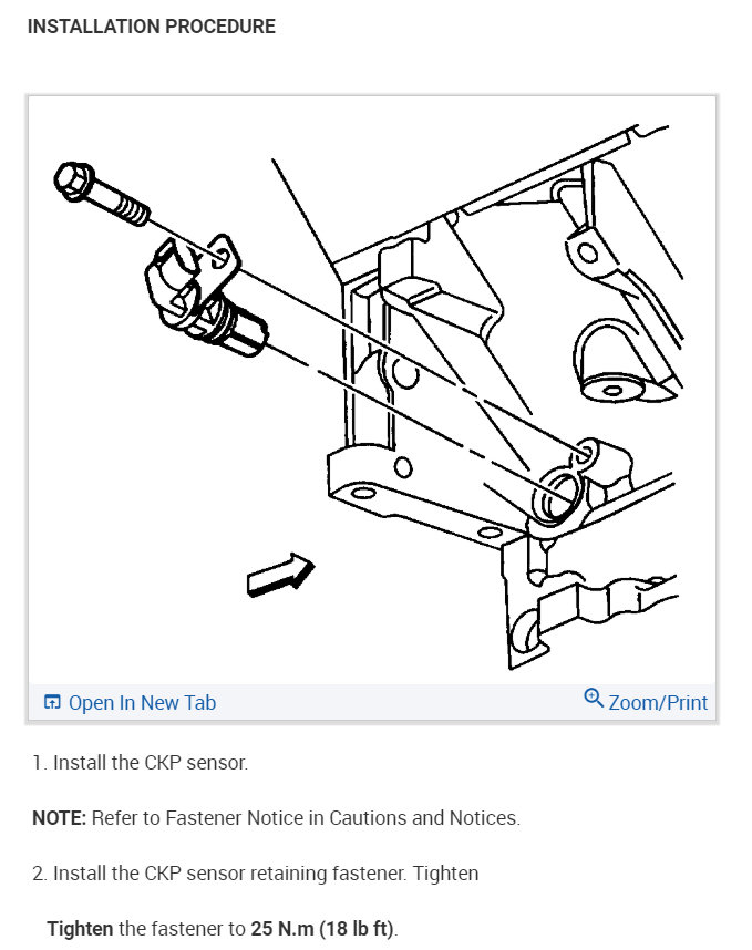

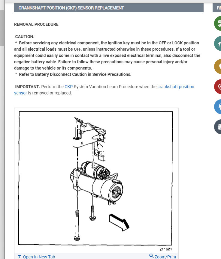

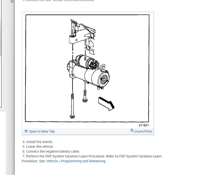

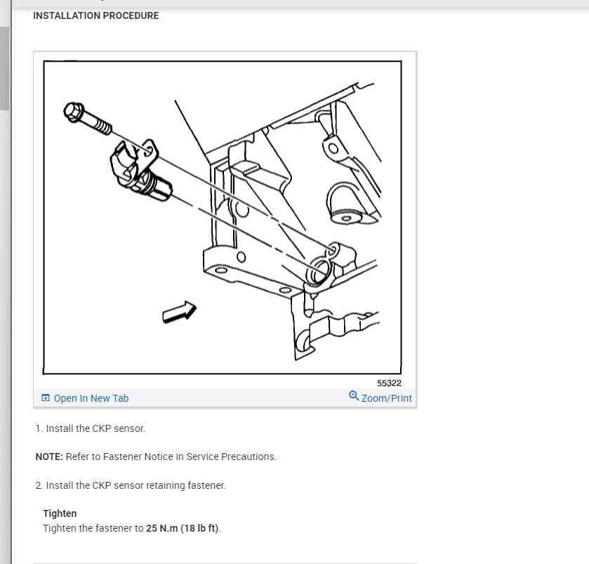

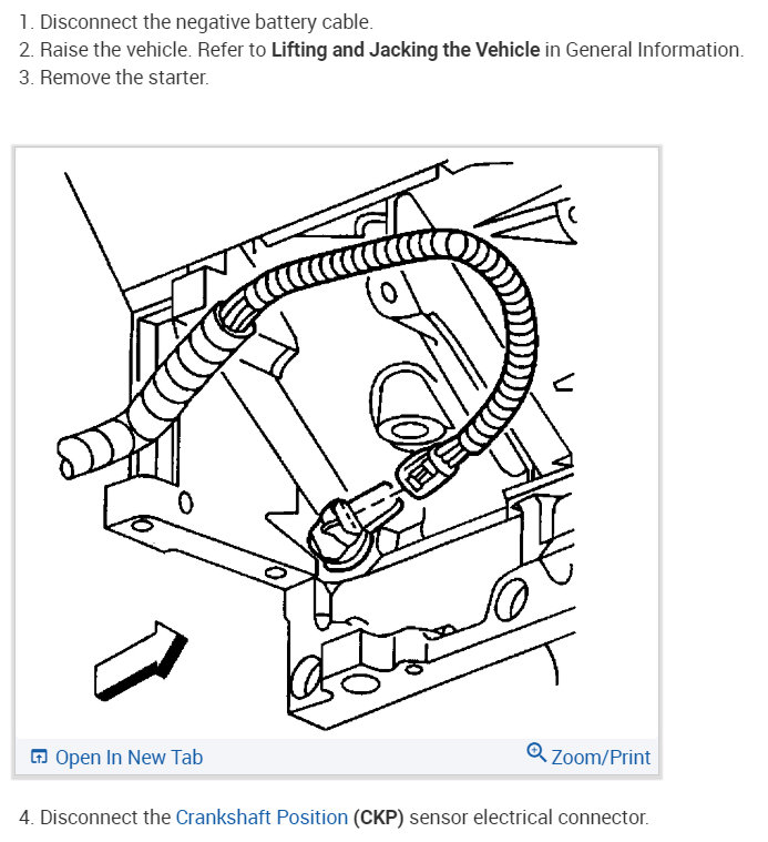

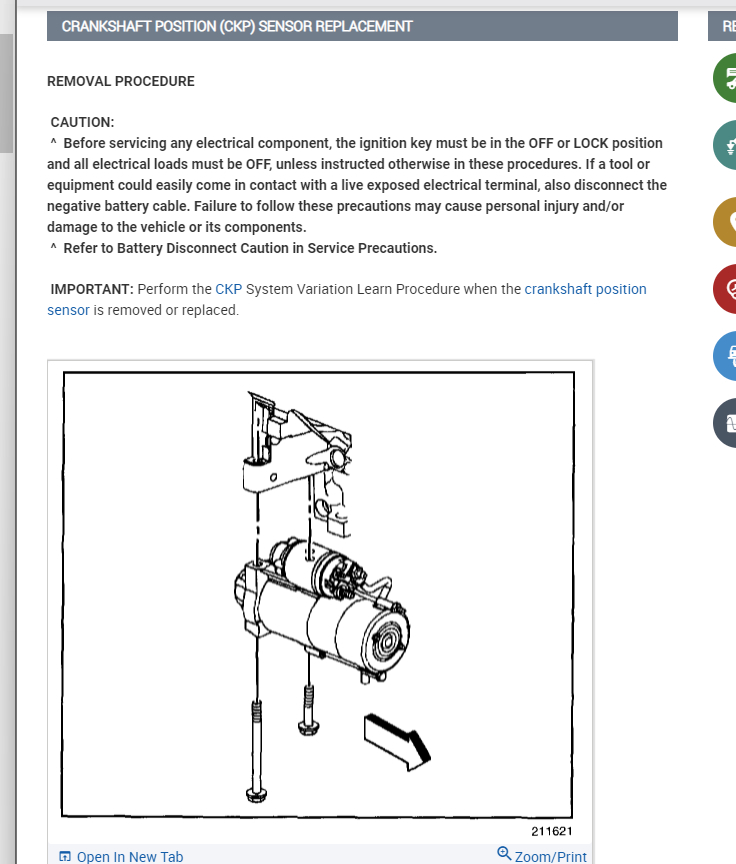

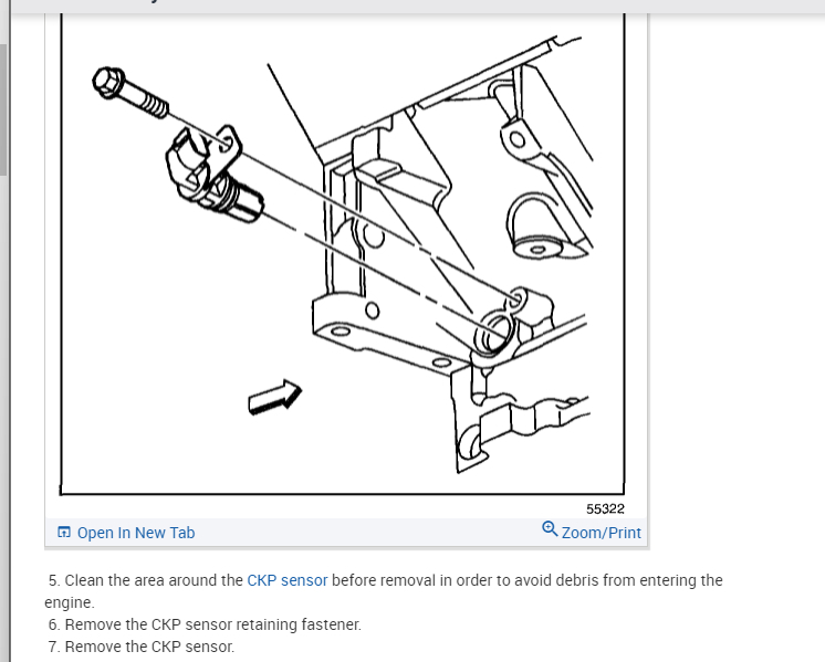

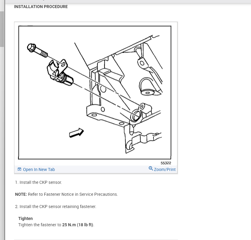

Check out the diagrams (Below). Please let us know what you find. We are interested to see what it is.
