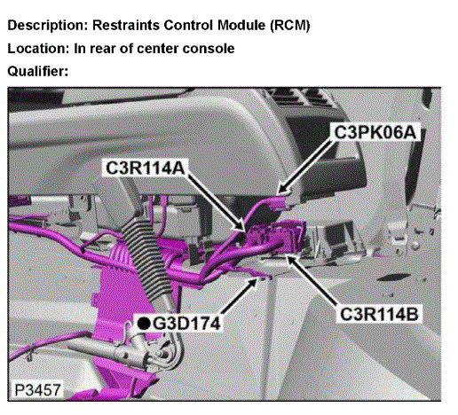

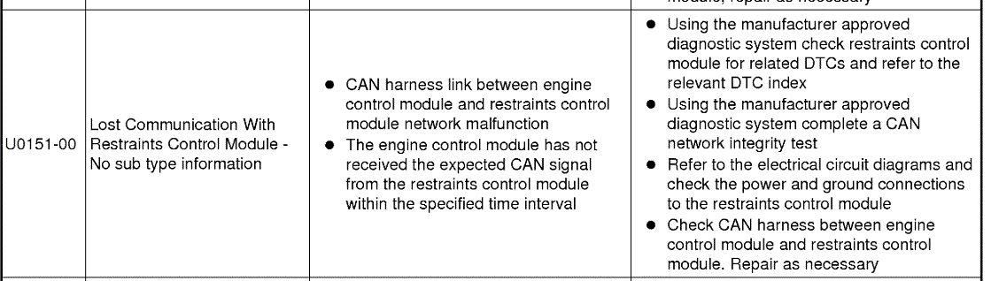

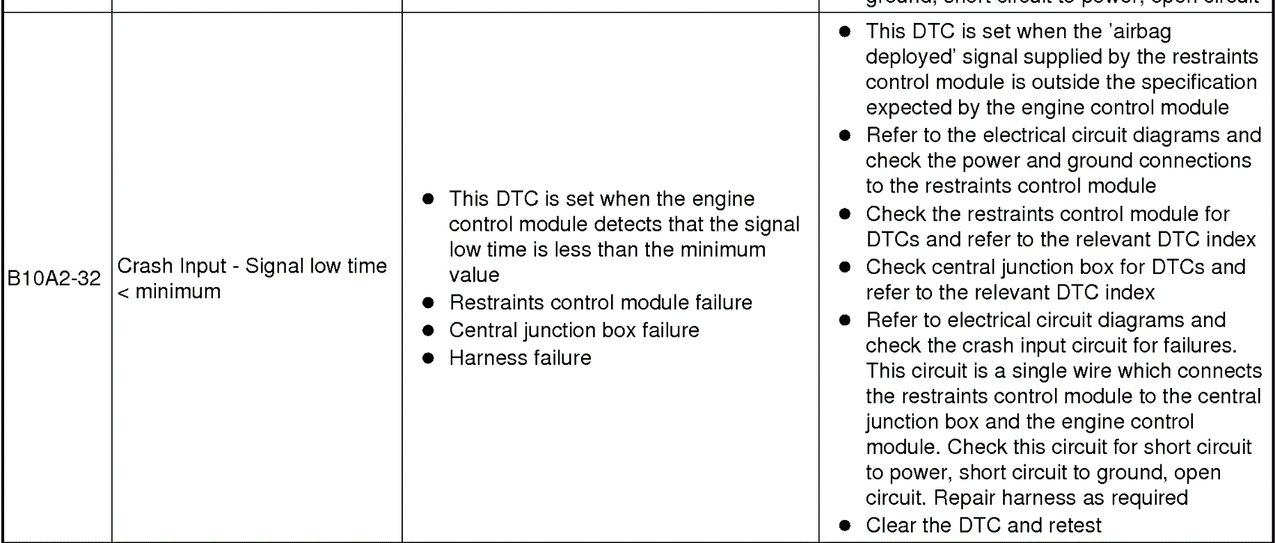

I looked up the codes you found and see they are all related to a break down in the CAN communication system. CAN stands for computer area network. Based on the codes, I feel the issue is related to the restraint control module's inability to communicate with the engine control module (ECM) . The module is in the rear of the center console. See pic 4.
What I suggest is to first check to make sure there is nothing disconnected or loose. I have no idea how bad the accident was, but make sure all wiring is still intact.
Let me know what you find. Also, if possible have the CAN bus system scanned. Here is a quick video that shows how it's done. Also, this procedure is mentioned in pic 3 as a means to locate the break down in communication.

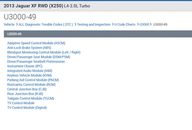

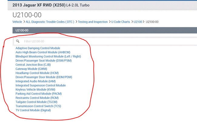

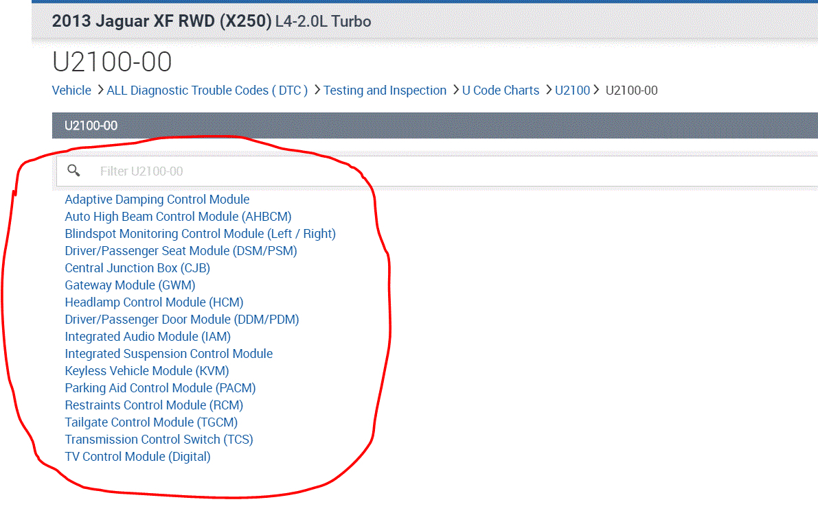

The codes you have are very vague simply because there are many different components associated with them in the CAN system. Take a look at the two pics and you will see what I am saying. If you do get your hands on a CAN scan tool, it will indicate where the break down is within the network.
Pic 1 is relevant to a U2100-00 and pic 2 is relevant for a U3000-49.
