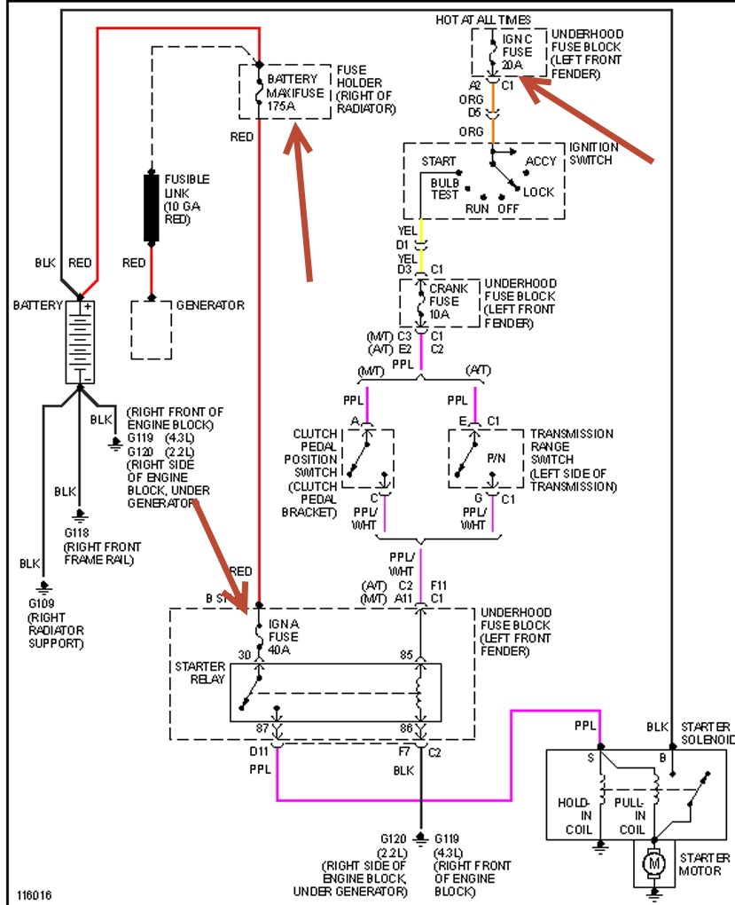

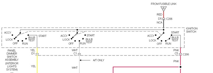

It sounds like the battery cables are dirty this guide can help us.

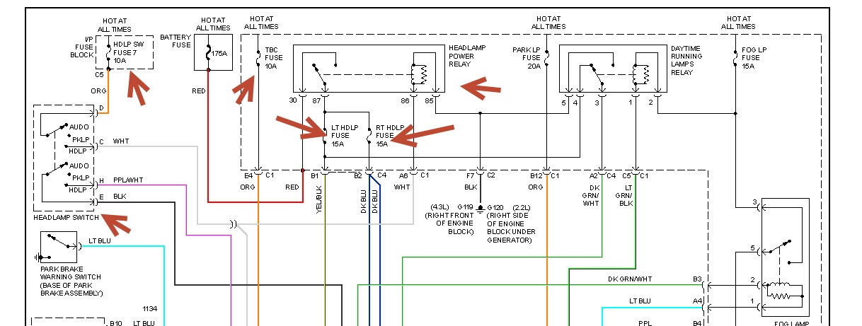

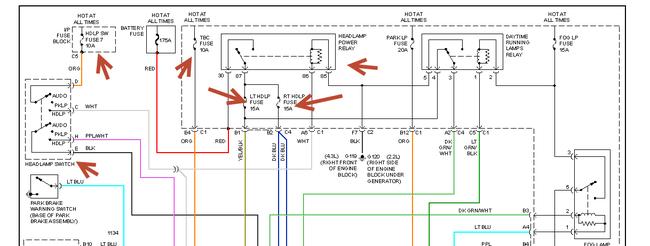

or you probably hooked the wire to the wrong place for one check the things I've pointed out in first pic second pic is where wires go to headlight switch and what fuses to check. Check out the diagrams (Below). Please let us know what happens.
Jan 30, 2021 at 8:44 AM (Merged)

All fuses are good. The only thing that was disconnected was the harness from the junction box under the dash.
HMAC300
  • 48,601 POSTS
then make sure the junction box was connected correctly and pins are not bent going into the wrong place your problem has to be in that area.

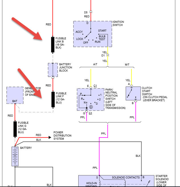

JDL
  • 16,098 POSTS
Just to add, fusible links A & B are voltage to ignition switch. Those links are at batttery junction box, my info says, left rear of engine for junction box.

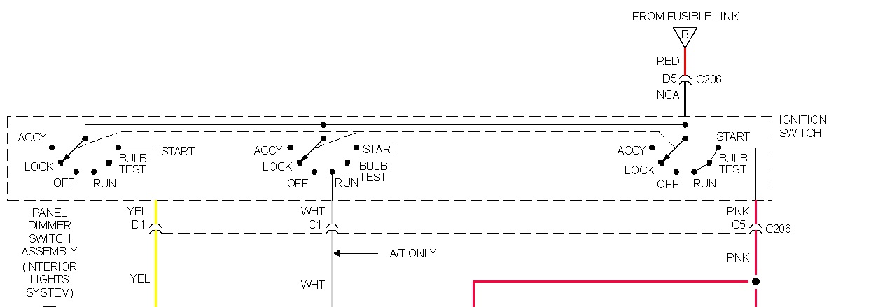

JDL
  • 16,098 POSTS
There should be two red wires that supply feed to ignition switch. In the diagram, voltage feed to ignition switch are on top, feed from ignition switch on bottom. Check the ignition switch wiring.

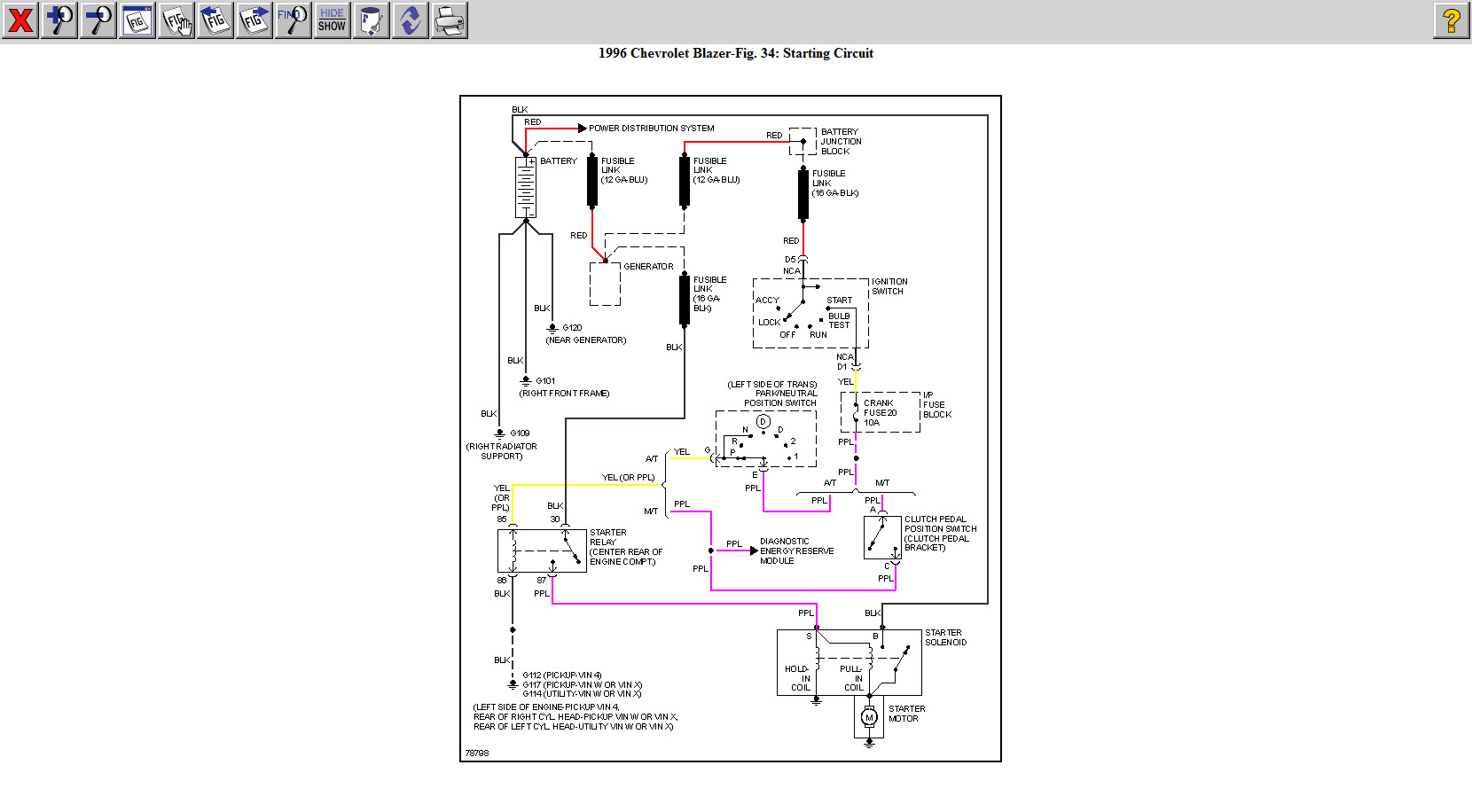

1996 chevy blazer, car has no power at all. battery is ok, no power to anything. all fuses ok. alternator was replaced 1 week ago.
Jan 30, 2021 at 8:45 AM (Merged)
HMAC300
  • 48,601 POSTS
check the fusible links ( they are usuallysmaller wires connected to larger ones.) i've sent the schematic along.

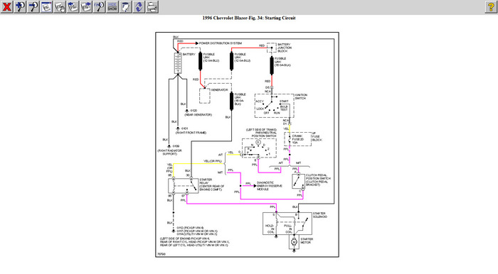

HMAC300
  • 48,601 POSTS
Shoot forgot to send picture. Sorry see picture as well.
