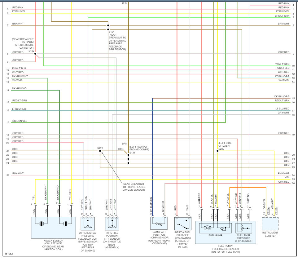

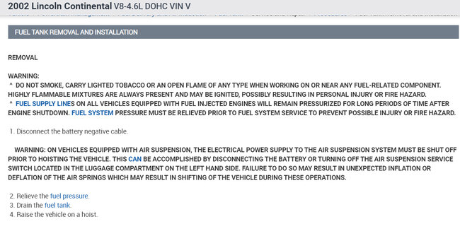

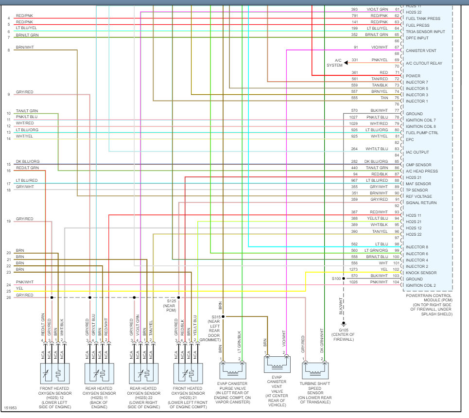

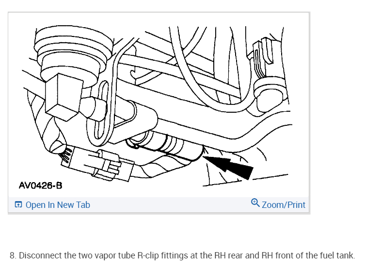

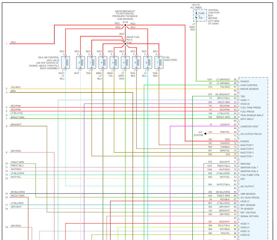

Is there an access panel to the fuel pump under the seat or does the tank have to be dropped? Which fuses to test before assuming pump is bad? Coil packs are stuck on plugs, all they do is stretch, and I'm worried the connector will pull out. Managed to remove one and the plug. Car tried to fire with gas down the cylinder. Thinking the pump is shot. Can't hear it running in tank but don't know if it's getting power. Inertia switch isn't tripped. Fuel shut-off switch in trunk is on. Checked most of fuses in battery junction box and a few in fuse panel under dash.
