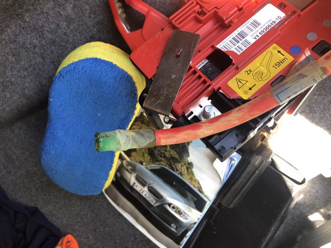

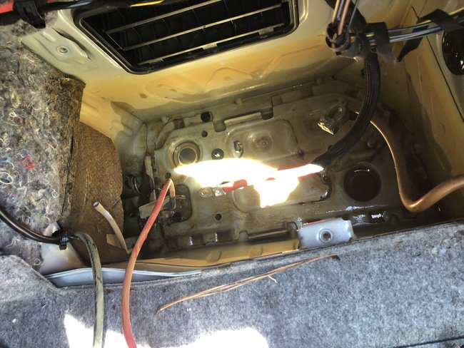

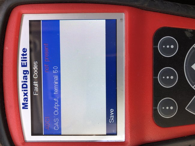

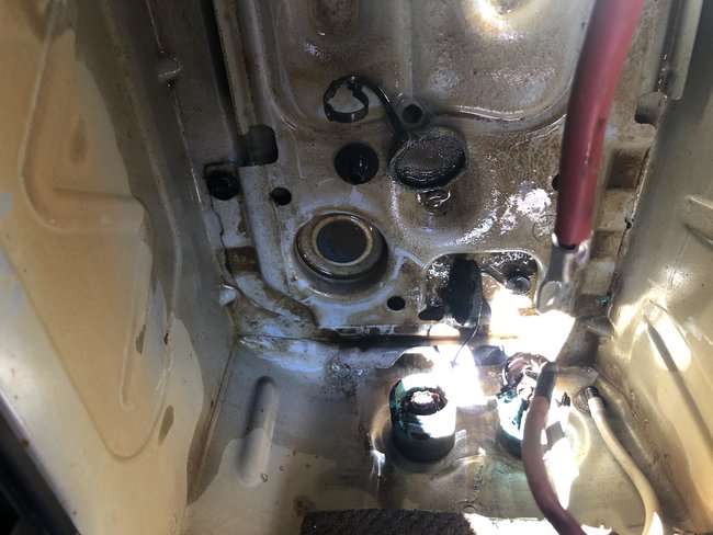

Friend of mine's car, wouldn't start but everything lights up on dash. i wasn't where the car was he scanned it and i saw a starter operation code present. it's almost always a starter code. I changed many of them. changed the starter still not turning over but there is a click from the starter when i tried to start it. It has a push button start. The starter operation code is not there anymore no other codes. But once when i tried to start it it gave this code. I also had a jumper on the battery in case it was weak but it isn't.
