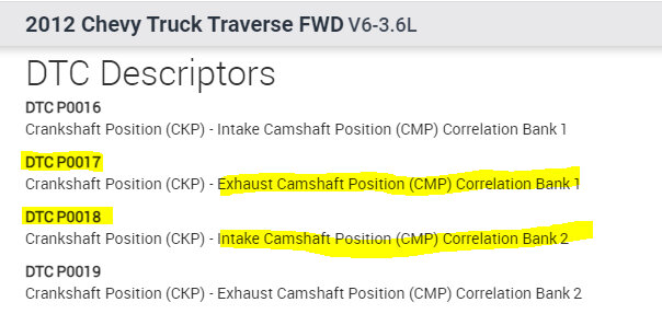

i finally got the car to run and it ran poorly, after i shut it off i checked for codes and got poo17 and poo18 codes. Does that mean i need to replace the timing chain or put new crank and cam sensor in?
Oct 24, 2023 at 6:41 PM

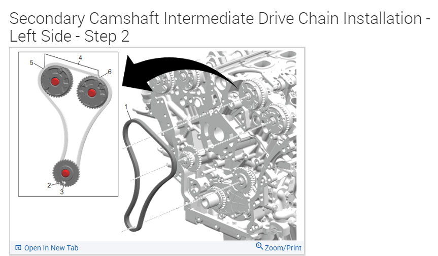

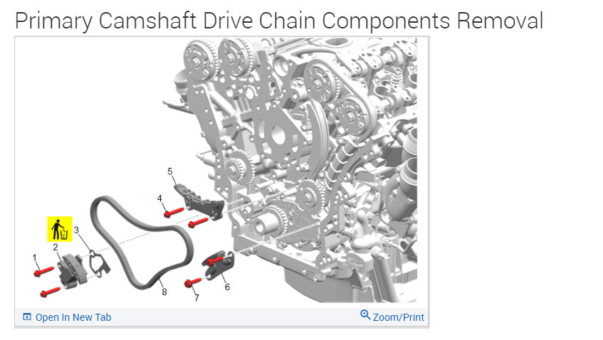

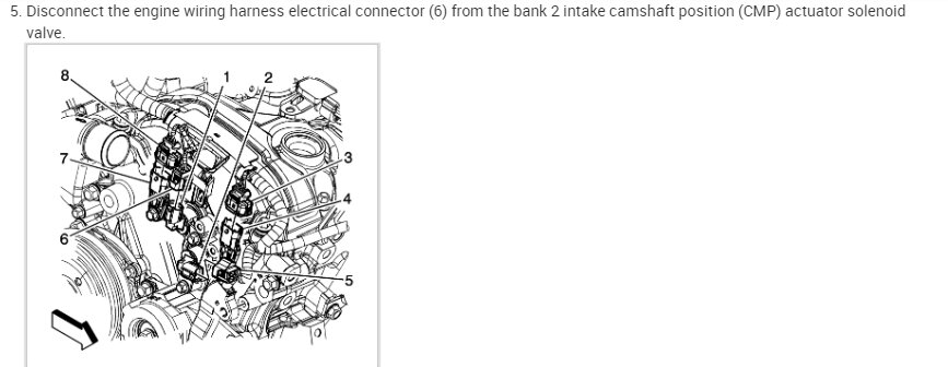

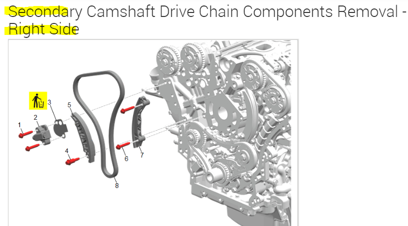

If they both came on at the same time, I suspect it is either a stretched chain issue, a chain tensioner, or a chain jumped time.
There are three timing chains on this engine, a primary, a left secondary, and a right secondary. See pics below.
Here is the odd thing, I question if it is a secondary chain because each bank (or side of the engine) has a related code. So, my first suspect is the primary chain either lost tension or is a tooth off.
On the other hand, is the engine oil clean and full? There could be a hydraulic issue with the variable valve timing, but both sides failing at the same time is odd. Ugh. This won't be an easy one. LOL
I suspect the timing chain cover needs to be removed for inspection of the chains, tensioners, and correct timing.
Let me know your thoughts.
See pics below.

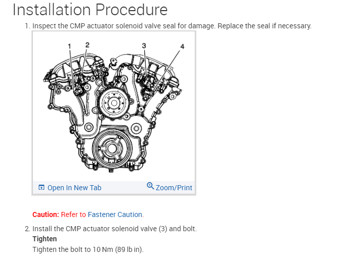

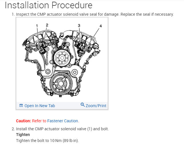

I thought about changing the VVT solenoids and checking the car to see if i get the same codes, if i do then i know to check the timing chain, also i would have new VVT solenoids. I know that would be more money but at least i know it has new VVT solenoids in it, or should i just go ahead and check the timing chain?
Oct 24, 2023 at 7:41 PM

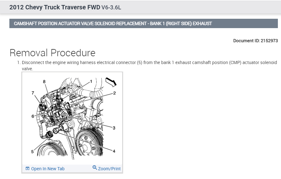

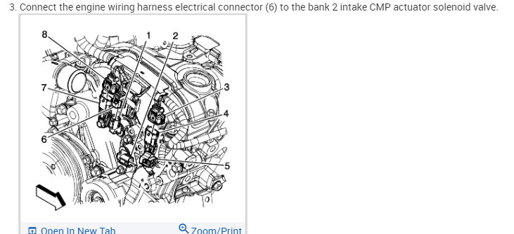

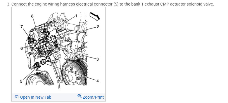

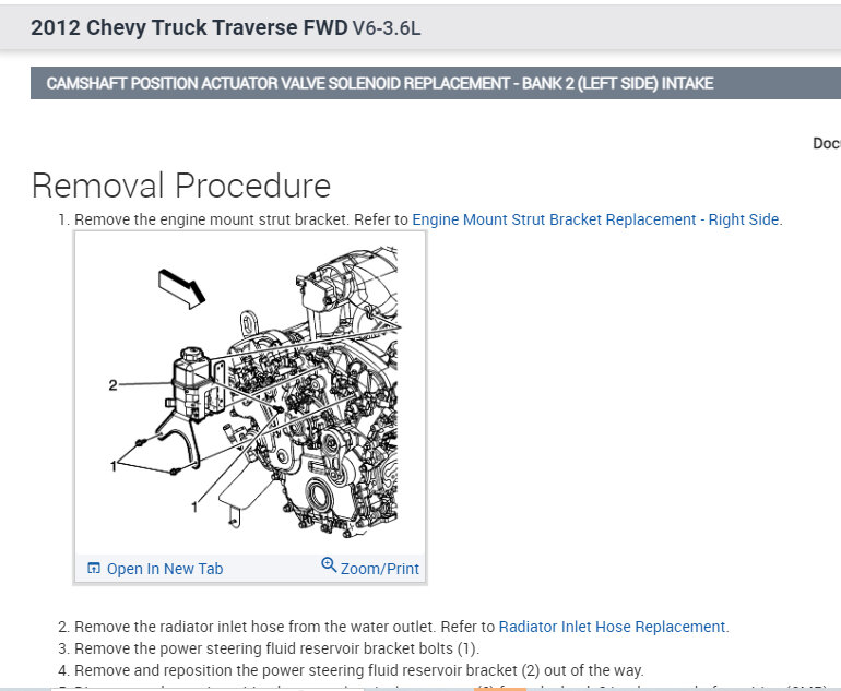

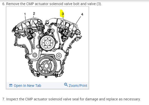

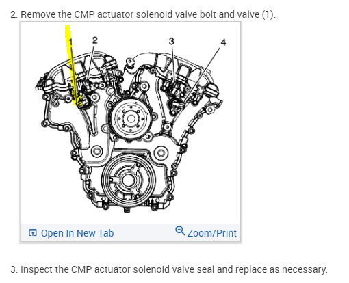

That would be easier. LOL However, the bank two intake actuator is a bit of a pain. LOL I attached the directions below for both and identified the ones in question.
Let me know how things work out for you. Also, make sure the oil is clean and full.
See pics below.
Oct 24, 2023 at 8:02 PM
