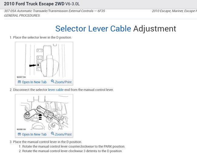

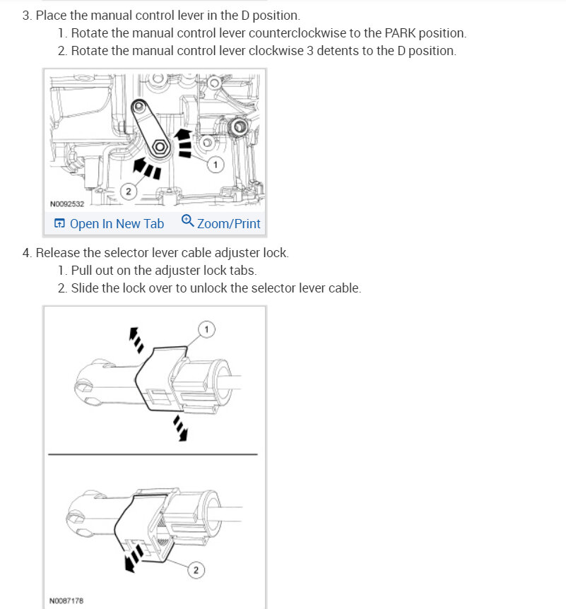

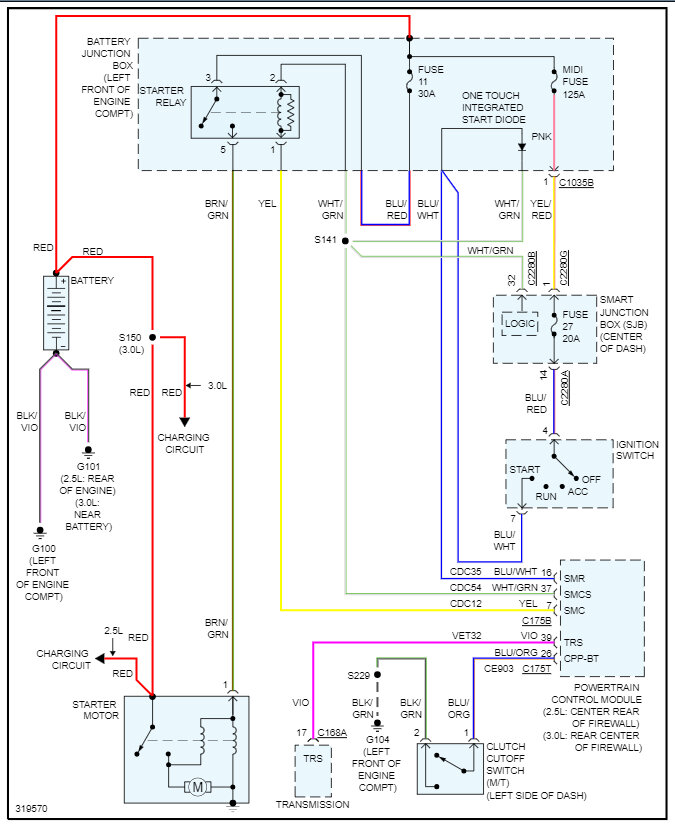

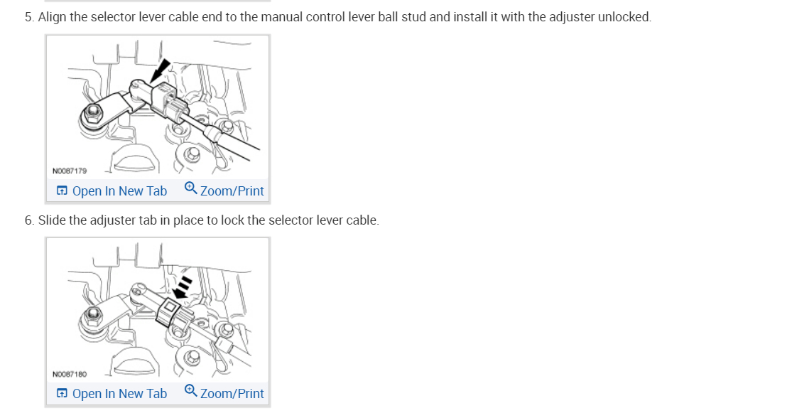

It sounds like the adjustment is off, please hold the key in the crank position and move the gear selector throughout the gear range to see if the starter kicks on. Here is how to adjust the shift cable in case you need it and I have included the starter wiring diagrams so you can see how the system works.

If the shift cable is off, I guess it doesn’t put the lever arm on the transmission in the right spot to crank? When the cable is not attached, I can place that arm to park position, then I can push it a little further, but it is spring loaded to return to park.

Yes, this is true, can you move the shifter and get it to crank over, you can use the wiring diagrams above to see where you are losing the signal to the starter.

As far as all the other tests I’m trying to work through them. When I check all the wires going into the PCM, am I testing for voltage to ground? Are any of those test continuity test? That is what’s holding me back from testing, but I’ll get back on it today.
When I test the relay seat, I get 12 volts at terminal 3. Terminal 1,2,5 all have continuity to ground. So I assume I just need to trace back from there to see why positive voltage isn’t being supplied to one of those terminals?
