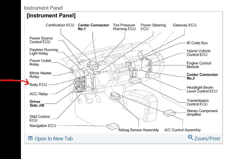

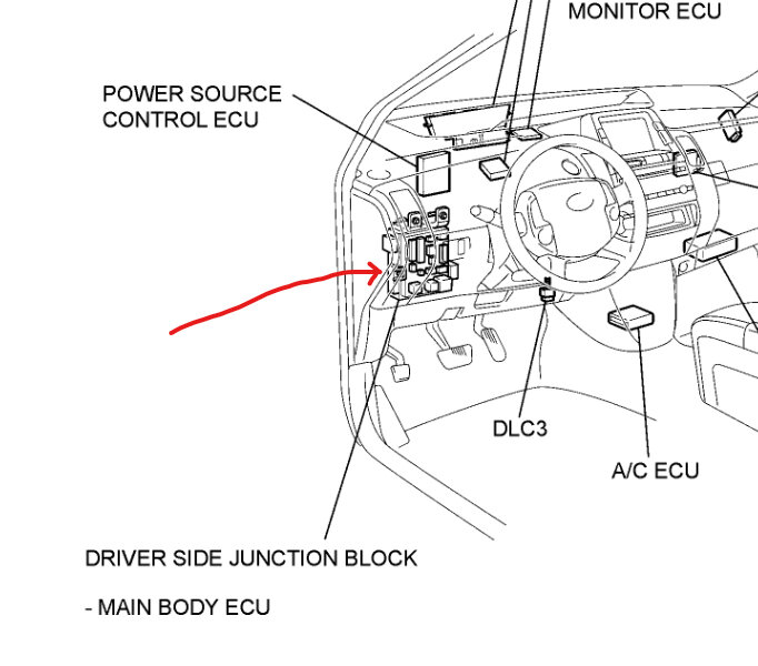

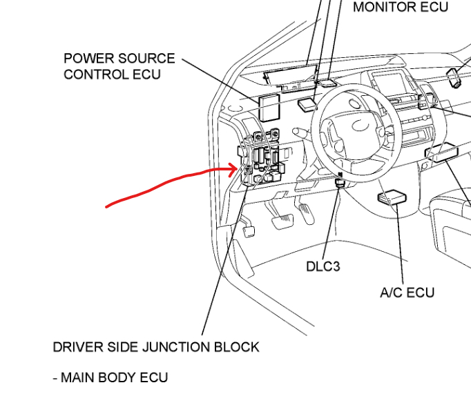

This sounds like the BCM when out, but to be sure let's run a CAN scan which is easy. You can get a CAN scanner (Controller Area Network) from Amazon for about $32.00.
here is a video to show you how:
https://youtu.be/u-4syLc-ifQ
and
https://www.2carpros.com/articles/can-scan-controller-area-network-easy

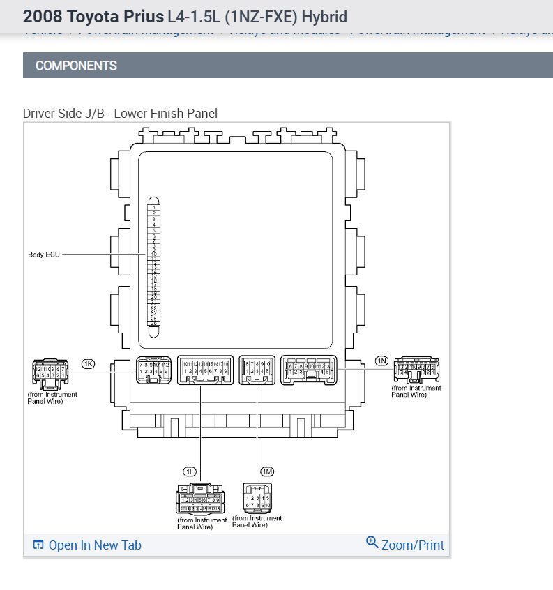

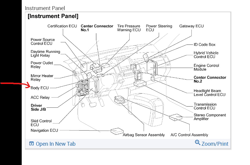

Here is how to change the BCM out which you can search Google or eBay for a rebuilt unit that comes preprogrammed. Check out the images (below). Please let us know what happens.

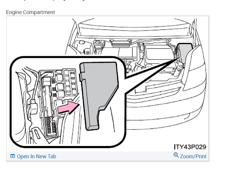

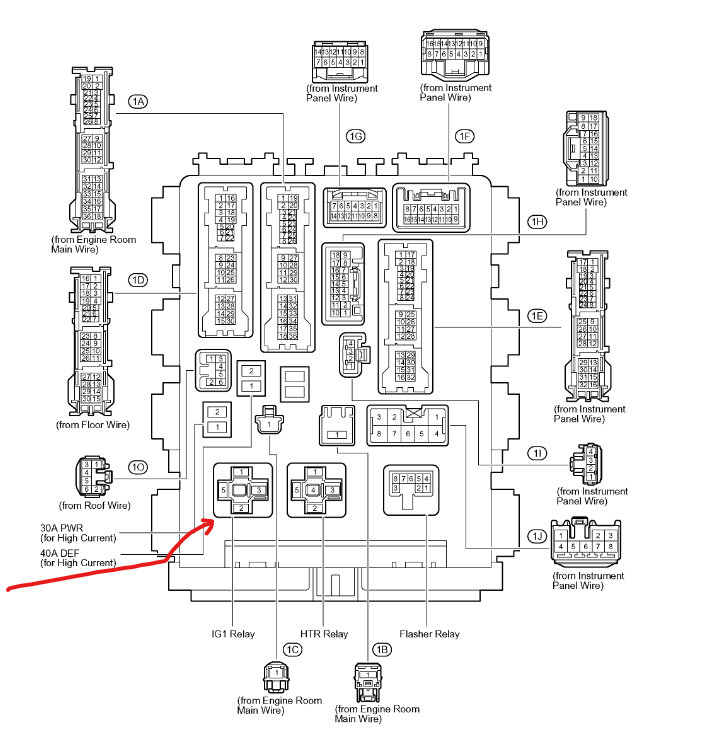

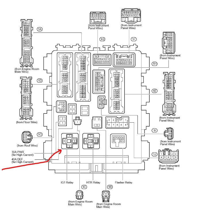

There is an IG2 relay I would swap out which supplies power to the system that is not working. The relay is located in the fuse panel under the hood on the left side.
Here is a guide to help you test it and the location in the images below:
