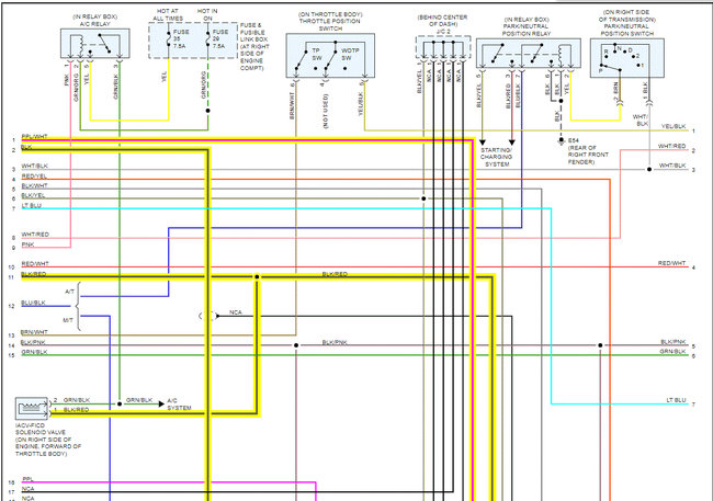

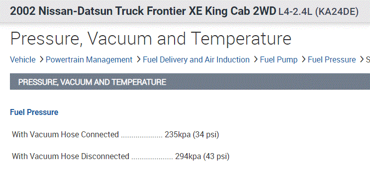

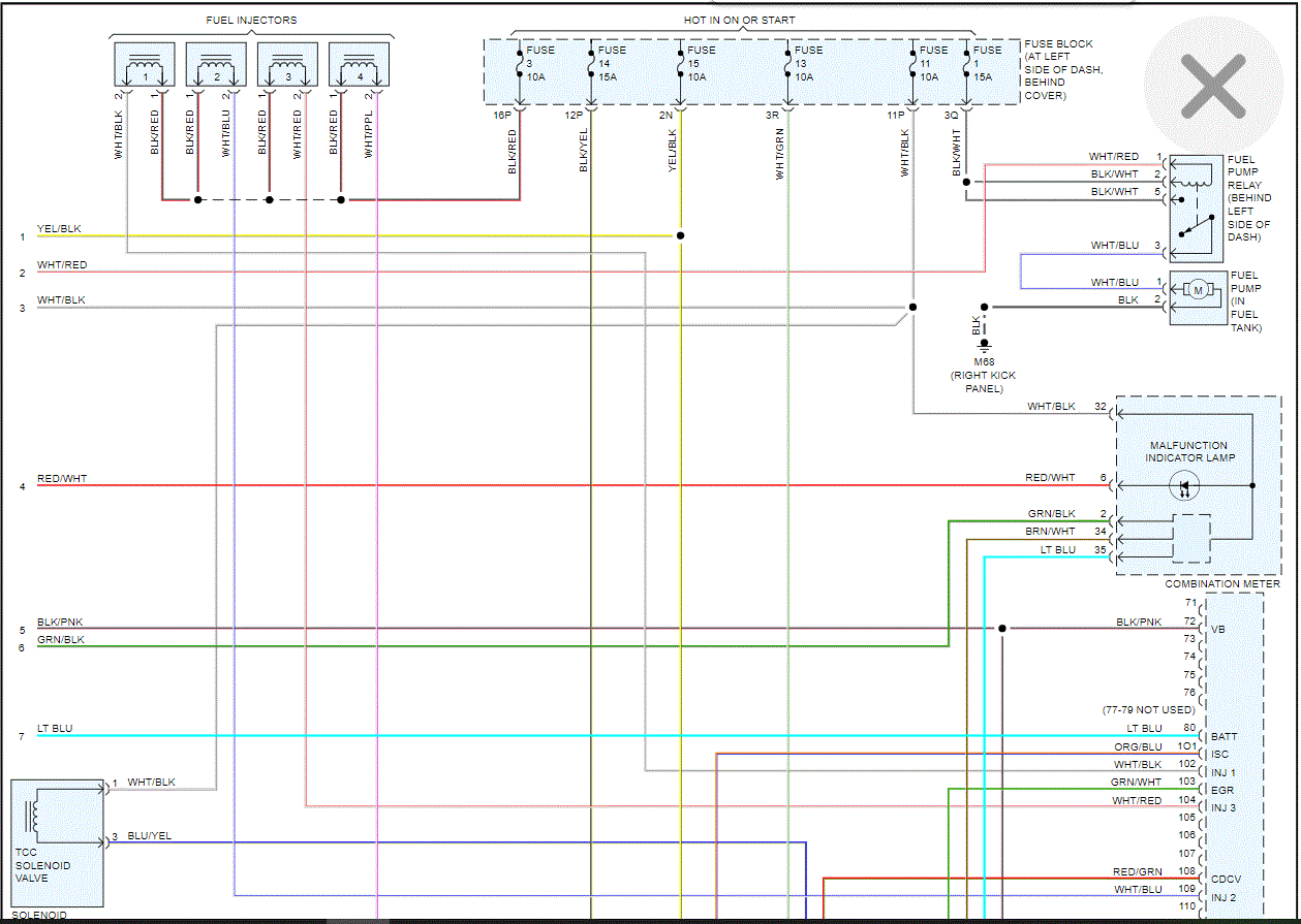

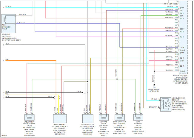

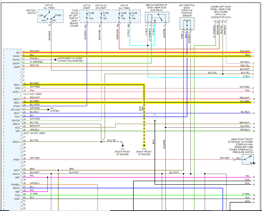

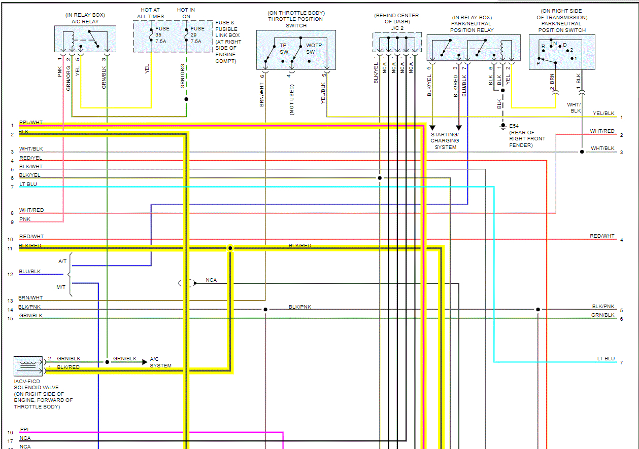

Okay, new parts already; crankshaft sensor,plugs,wires, distributor cap and button and battery. I stopped at a stop sign and it shut off no warning. I had to b towed home since then I've replaced parts above with no luck still doing exactly same thing. It's getting fire and fuel at least to the injectors but not sure about any farther . .Please tell me what to do now.codes on meter was p0303,p0128 and p0113.
