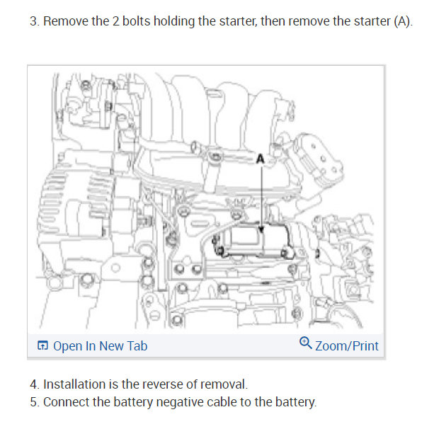

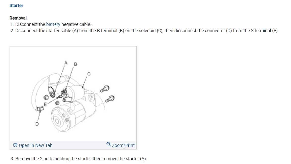

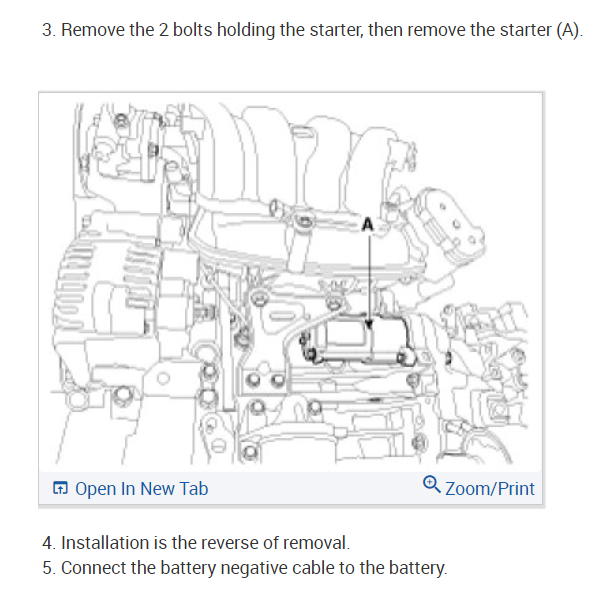

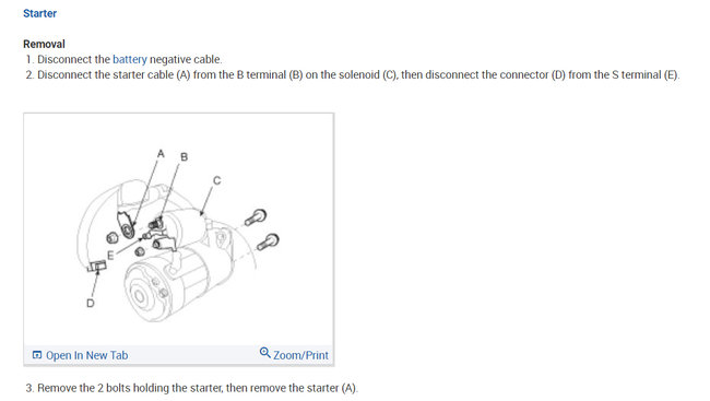

What is the battery voltage? Check it with a voltmeter. I attached a guide for you to review.
You may have a bad battery but we need to start there.
Beyond that, one single click could indicate a failed starter motor. I attached the procedure for you for the starter below.
