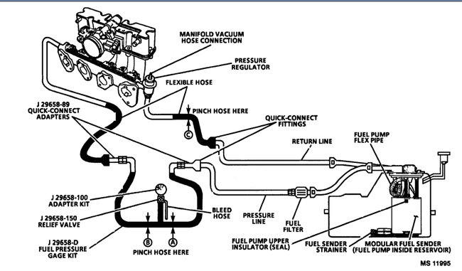

The car starts for a second then shuts down like it's out of fuel but you can hear the fuel pump kick on. could it be the oil?
Mar 19, 2021 at 12:57 PM
Good afternoon,
This could be security if the light stays on after 10 seconds with the key on. I attached the reset for you.
https://www.2carpros.com/articles/how-to-reset-a-security-system

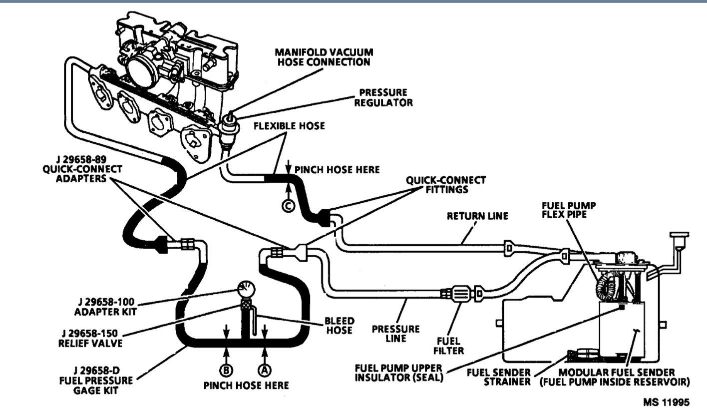

Beyond that, I would check the fuel pressure to be sure there is enough fuel to the injectors.
When the ignition switch is ON (Engine off) and the fuel pump is running, the fuel pressure indicated by the fuel pressure gage should be 284-325 kPa (41-47 psi).
As far as the oil, no, it is not the oil.
