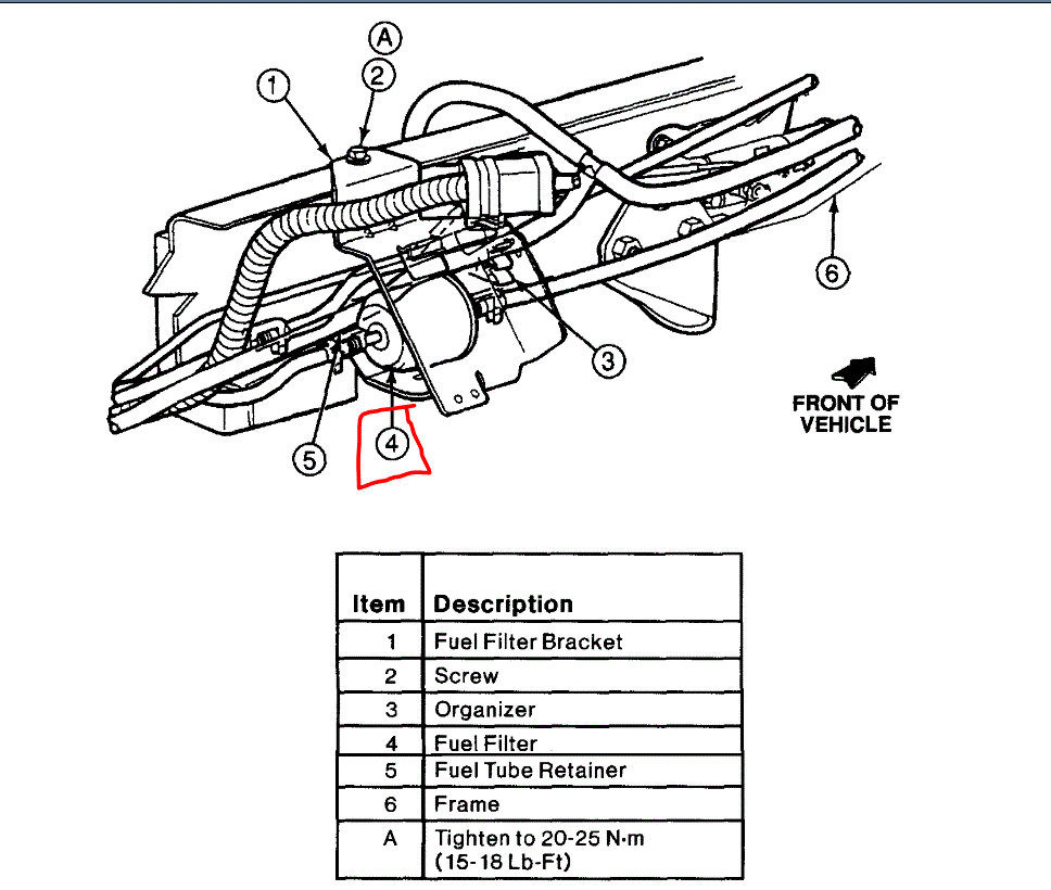

If you aren't getting fuel to the fuel rail, that is the problem. You said you hear the pump running but if there is no fuel at the rail, chances are the pump is bad. Even though it is running, it may not be producing enough pressure to run the engine.
Also, have you checked the fuel filter to make sure it isn't plugged? I attached a pic below if it's location. It's along the frame rail, driver's side.
Let me know. Also, I need to know if you have dual fuel tanks.

It has duel tanks and already changed fuel filter.
Jan 16, 2021 at 12:25 PM
If the filter is new, disconnect the supply end of the filter (from pump) and place a rubber hose over the other end of the filter and place that into a fuel tank. Turn the key on to prime the pump. See if you get any fuel.
I suspect the pump is bad. You can try what I said above or remove the pump and bench test it.

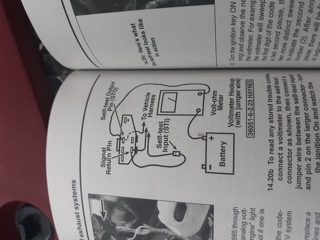

I had fire until the neighbor guy next door tried a test on the outside using a jumper wire and a meter but after that is when I lost getting spark to coil.
What kind of a test? what was he connected to? and any info you can provide that may help me.

This is test I was telling you about:
He was trying to retrieve codes. However, you don't need to connect to the battery, so I'm not sure what has happened.
Do me a favor. Follow this link and see what codes are found:
https://www.2carpros.com/articles/ford-lincoln-mercury-obd1-1995-and-earlier-diagnostic-trouble-code-definition-and-retrieval

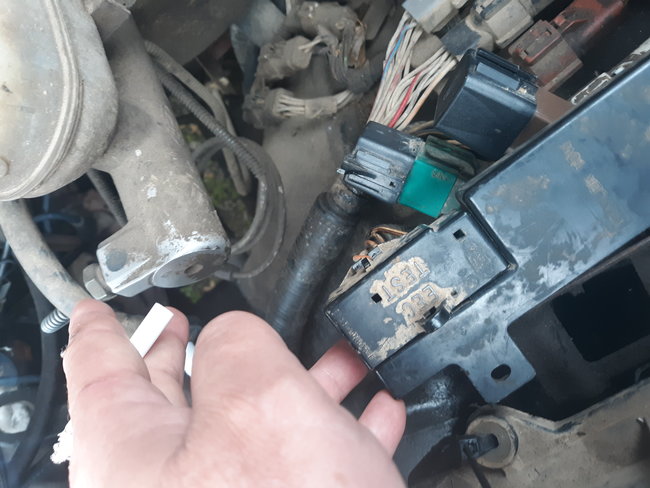

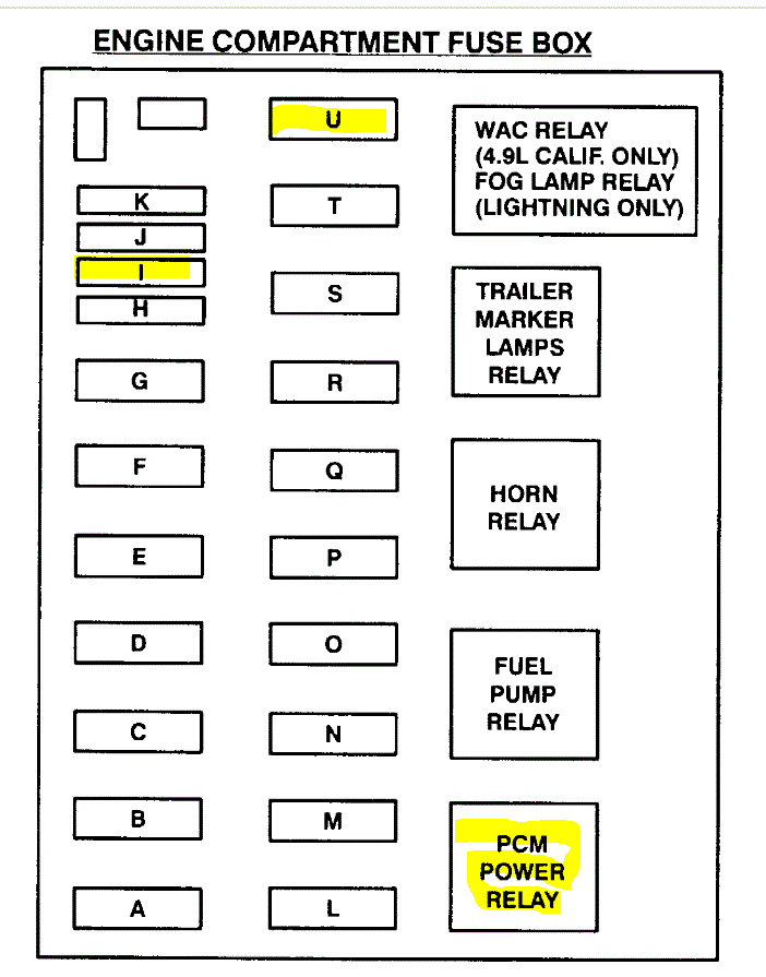

Also, in the under hood fuse box, locate the EEC relay/PCM power relay. Switch it with a different relay with the same part number. Also, I need you to check two fuses. See the attached pic for locations.
Let me know what you find. Also, I need to know if the fuel pump is turning on.

Okay, sorry taken so long to get back. so changed MAP sensor and module on side distributor fuel pump relay. also truck fired right up timed it got it in time. the only deal is got to give it gas to keep running.

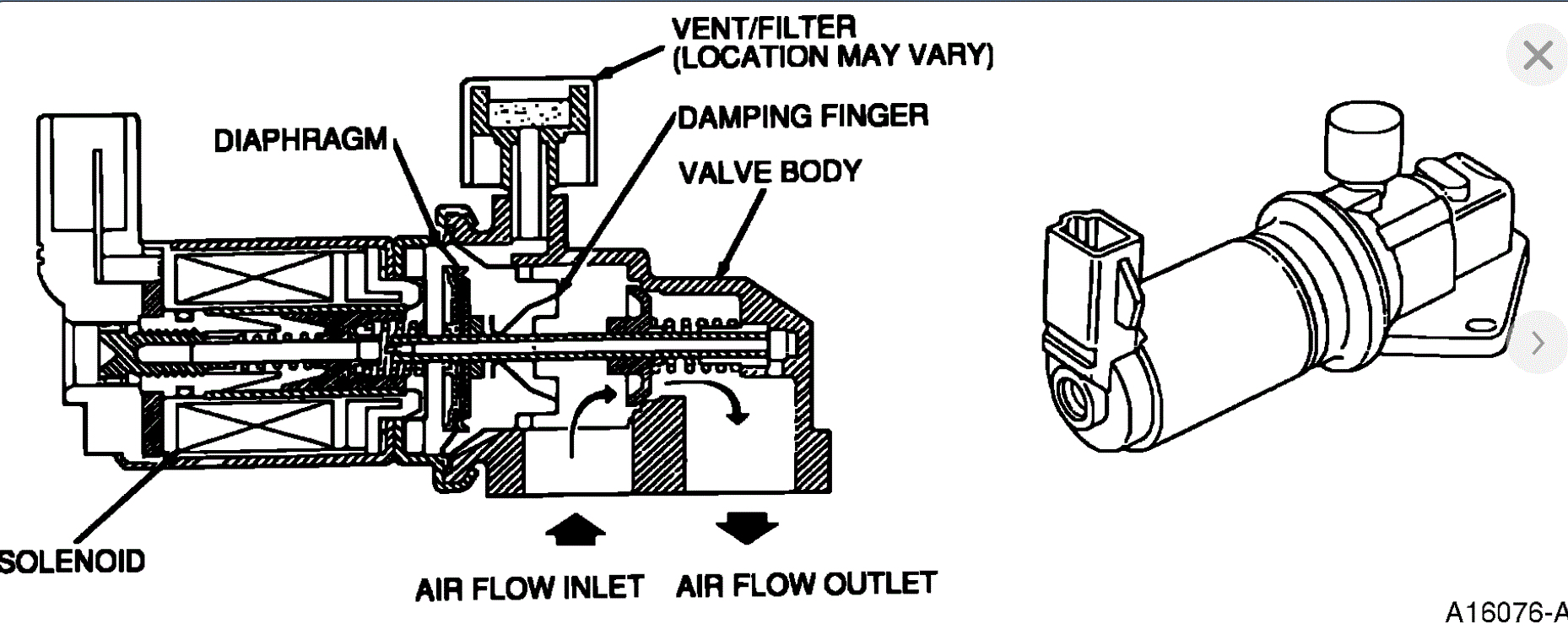

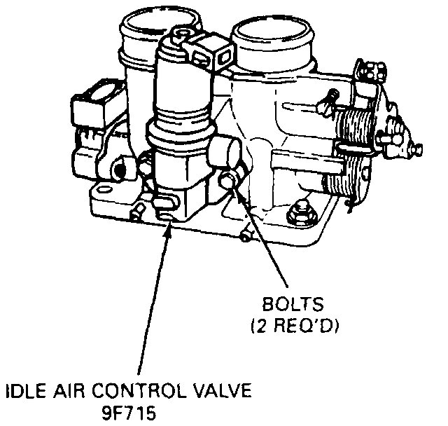

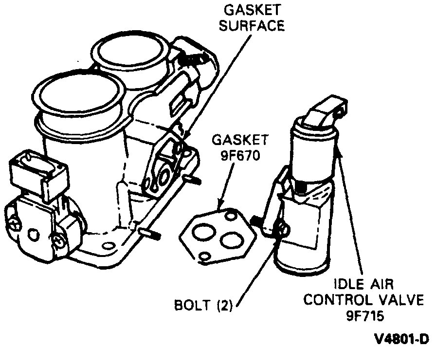

Sounds like you made progress. As far as the low idle, have you checked for engine vacuum leaks? You have been working on it for awhile, so it's possible that something was disconnected. That is what I would check for first. Here is a link you may find helpful:
Next, the idle speed is controlled by the idle air control valve. It is located on the throttle body and responsible for maintaining engine idle speed. I attached a pic if it. See pic 1.
Here is a link that explains how to service one:
https://www.2carpros.com/articles/idle-air-control-valve-service
Here is a link that explains in general how one is replaced:
https://www.2carpros.com/articles/how-to-replace-an-idle-speed-control-motor-iac

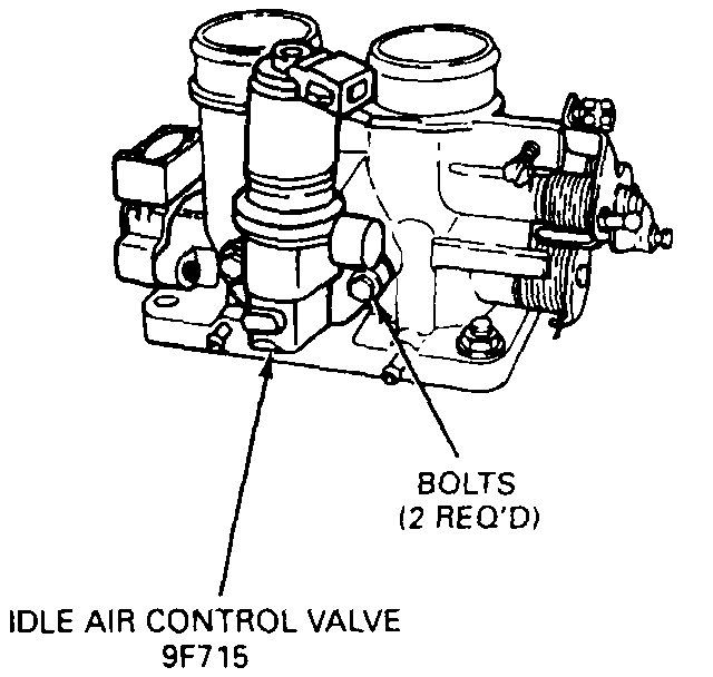

Here are directions specific to your vehicle for replacement. The remaining pics correlate with the directions.
__________________
1995 Ford Truck F 150 4WD Pickup V8-302 5.0L
Removal and Replacement
Vehicle Powertrain Management Fuel Delivery and Air Induction Idle Speed/Throttle Actuator - Electronic Service and Repair Removal and Replacement
REMOVAL AND REPLACEMENT
Idle Air Control Valve
pic 2
REMOVAL
1. Disconnect negative battery cable.
2. Disconnect the Idle Air Control (IAC) valve assembly connector from the wiring harness.
3. Remove the two IAC valve retaining bolts.
4. Remove the IAC valve and gasket.
IAC Valve and Gasket
pic 3
INSTALLATION
NOTE: If scraping is necessary, be careful not to damage sealing areas of IAC valve or throttle body gasket surfaces, or drop material into throttle body, or intake manifold.
1. Make sure that both throttle body and IAC valve gasket surfaces are clean.
2. Install gasket and IAC valve.
3. Install retaining screws. Tighten to 8-11 Nm (71-97 in lb).
4. Connect electrical connector for the IAC valve.
5. Reconnect negative battery cable.
NOTE: When the battery has been disconnected and reconnected, some abnormal drive symptoms may occur while the powertrain control module relearns its adaptive strategy. The vehicle may need to be driven 10 miles or more to relearn the adaptive strategy.
Let me know if that helps.

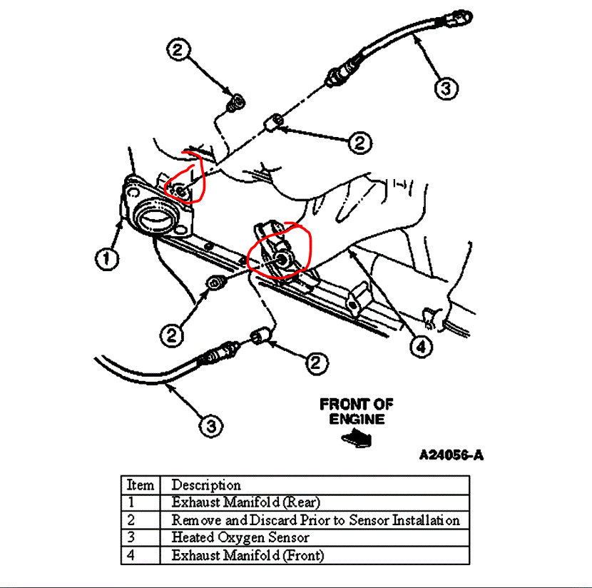

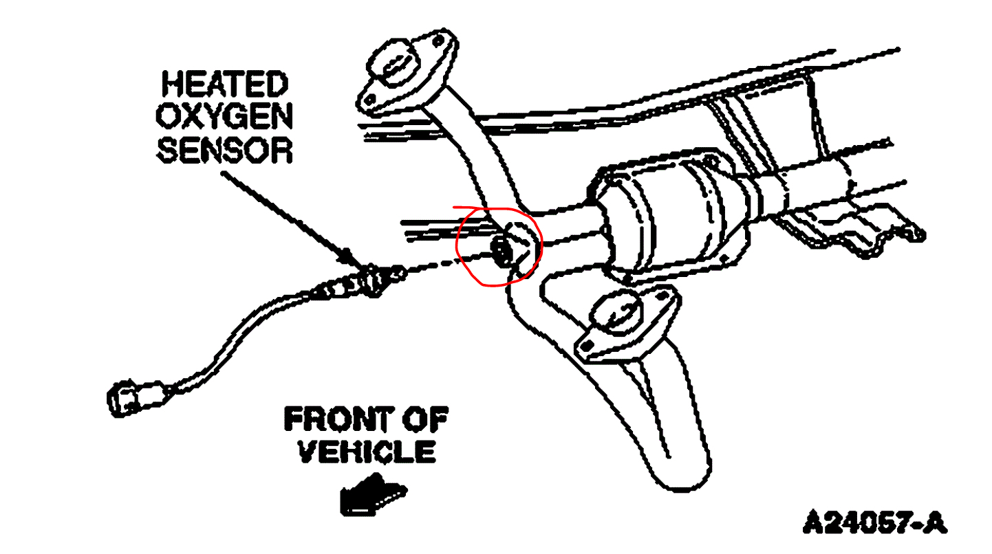

The 153 and 154 are both o2 sensor related and specific to the same sensor, bank 2 sensor 1. Have you replaced that sensor? It is a heated oxygen sensor. There is no activity, so either there is a sensor issue or the wiring/ECM issue. The 42 is related to the bank 1 sensor 3.
Interestingly, I also found code 42 could be related to a constant rich fuel mixture. Have you checked fuel pressure?

There are three of them. Banks 1 and 2 are at the end of the exhaust manifold. Sensor 3 is where the Y pipe comes together. See the attached pics.
