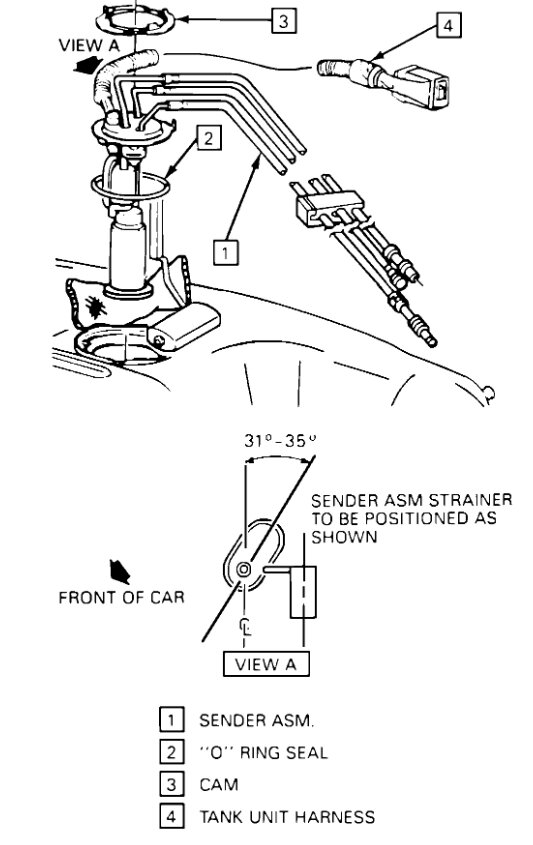

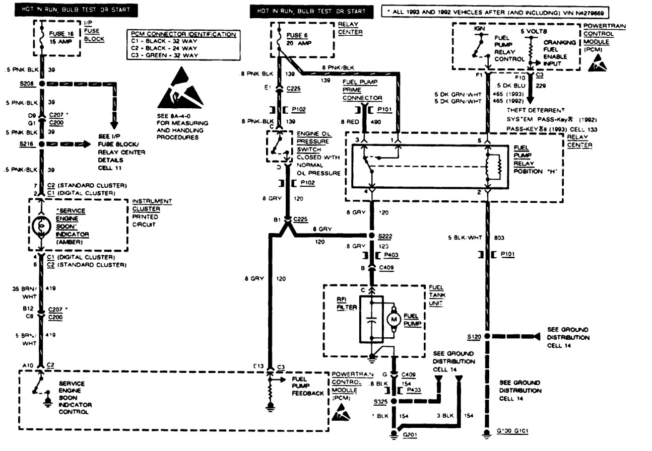

Congratulations! Can you upload images of the car, I love barn finds. It sounds like the fuel pump or old gas is getting you on this car. I would drain the tank and drop it, then replace the fuel pump and flush the old fuel out, then reassemble it and refill it with new fuel. That should fix it. Check out the images (below). Please upload pictures or videos in your response
