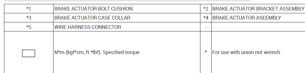

Did all these problems happen at once? I would check the brake fluid and the brake pads, but I have seen the ABS control module go out and cause this issue. For the ABS and traction control the speedometer issue will cause these warning lights to come on because they are all produced by the ABS control module. We should do a CAN scan to confirm the issue. You can get a CAN scanner (Controller Area Network) which will work on most cars from Amazon.
Here is a video to show you how:
https://youtu.be/u-4syLc-ifQ

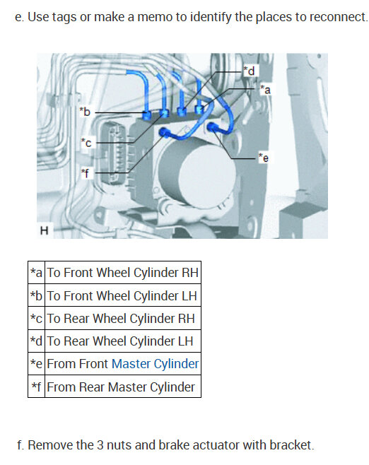

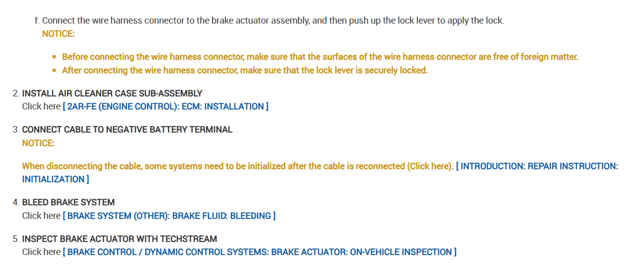

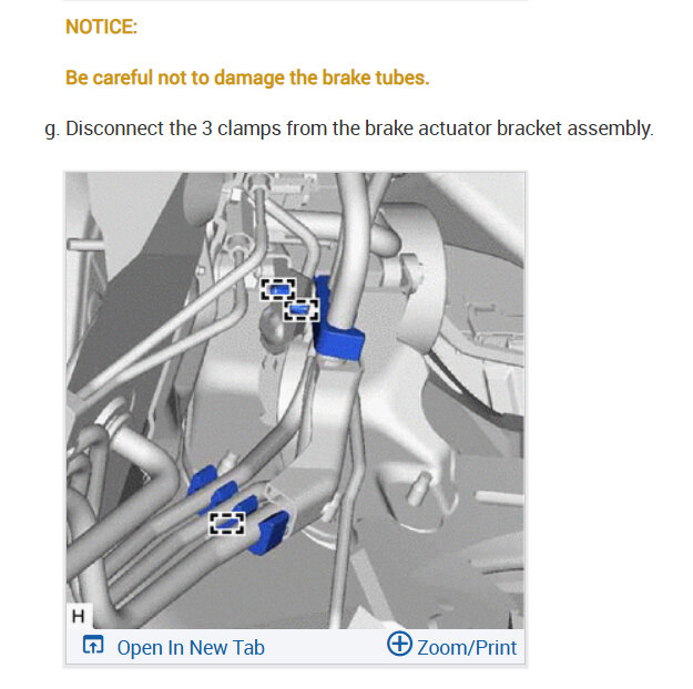

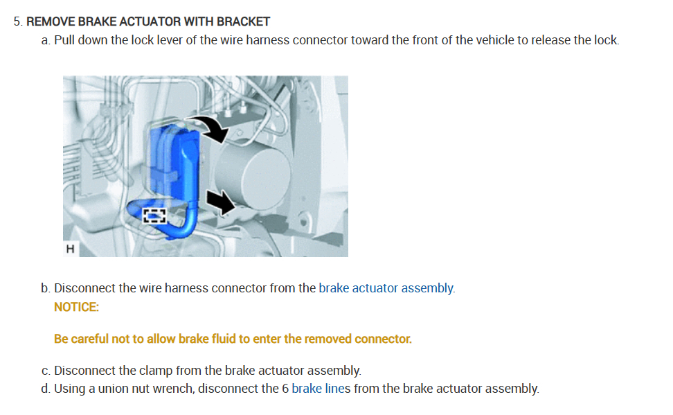

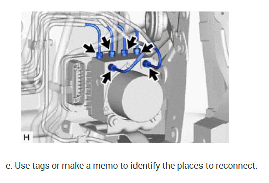

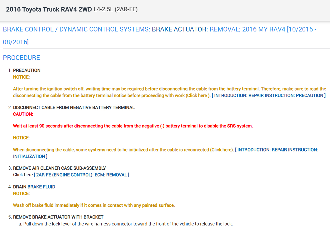

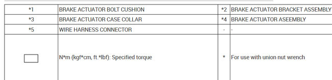

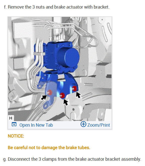

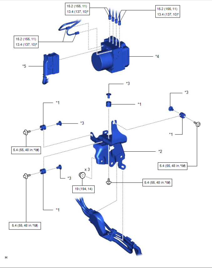

Here is how to change the module out in case a code comes up for it. Check out the images (below). Please let us know what happens.

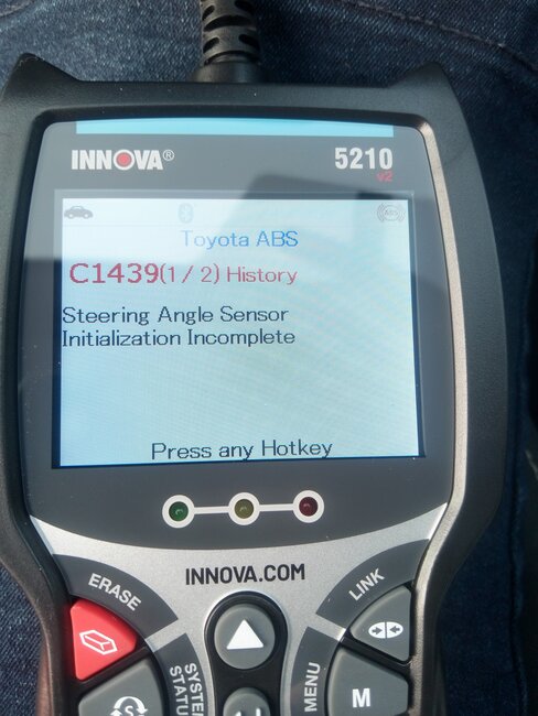

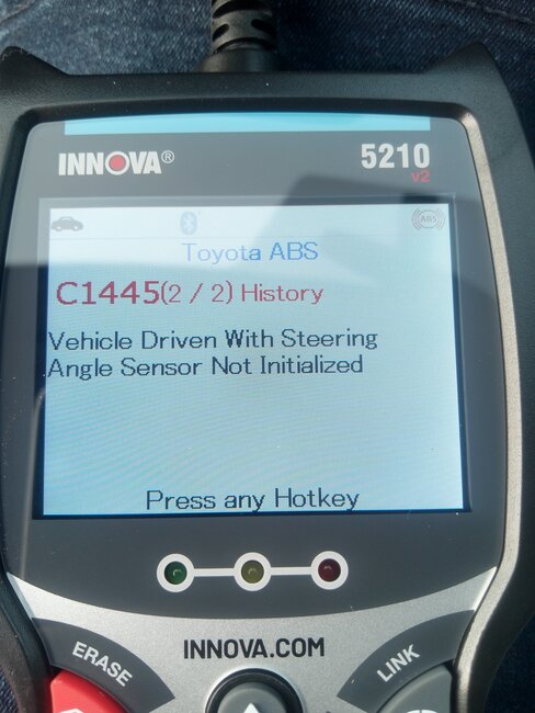

Bought a CAN scan tool and have photos of results. Erased all codes and now everything works properly even the radiator fan comes on without jumping the relay, which I thought was corrected when I replaced the temperature coolant sensor, but was not. Haven't driven it much to see if issues come back yet.

Also, P0500 was showing and there is live data that you may want the info on. Let me know what info to send? Thanks for your help.
Jun 1, 2025 at 10:06 AM
It sounds like the spiral wire can be bad, but you should try a zero point calibration for the steering angle sensor which you should be bale to do with the CAN scanner. Just navigate to the ABS system and find the prompt for it. It should tell you to turn the car on without starting the engine with the steering wheel straight. Then follow the instructions on the scanner. If the code does not clear I would replace the spiral wire.
