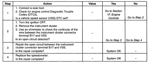

I have replaced vehicle speed sensor,speedometer and still have no speed readings.
All parts were purchased brand new but i am still having the same problem.
Any and all help is appreciated.

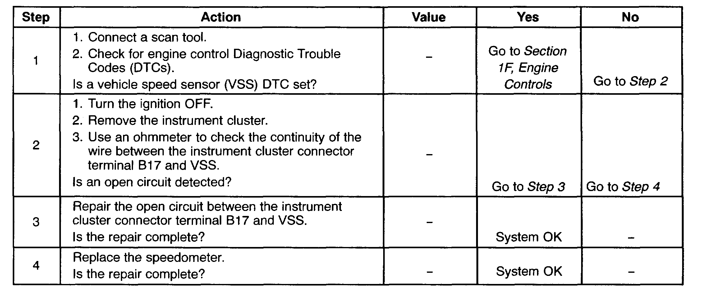

You must have an open circuit between the vehicle speed sensor and the cluster. I attached a diagnostic flow chart that explains which pins to check on the cluster. You will need to check for continuity so you will need a digital multi-meter. Take a look through the chart and let me know if it helps or if you have other questions.
