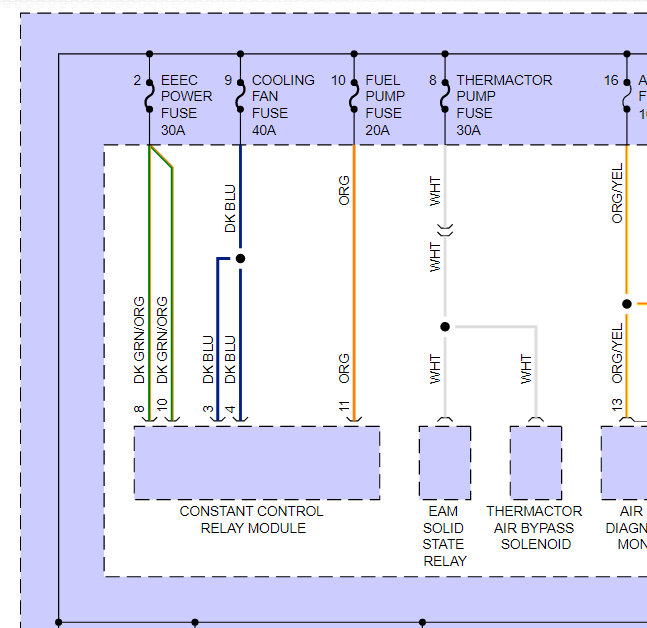

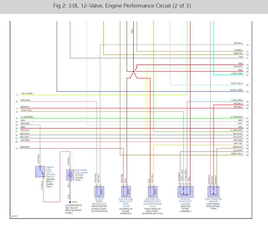

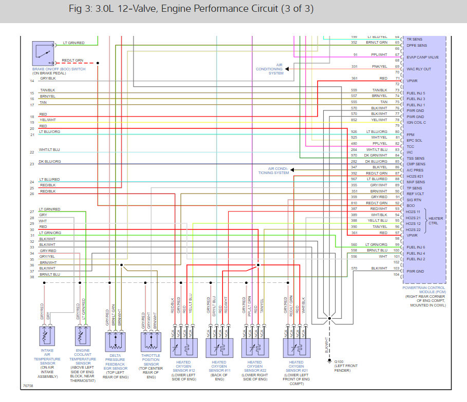

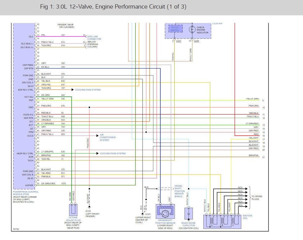

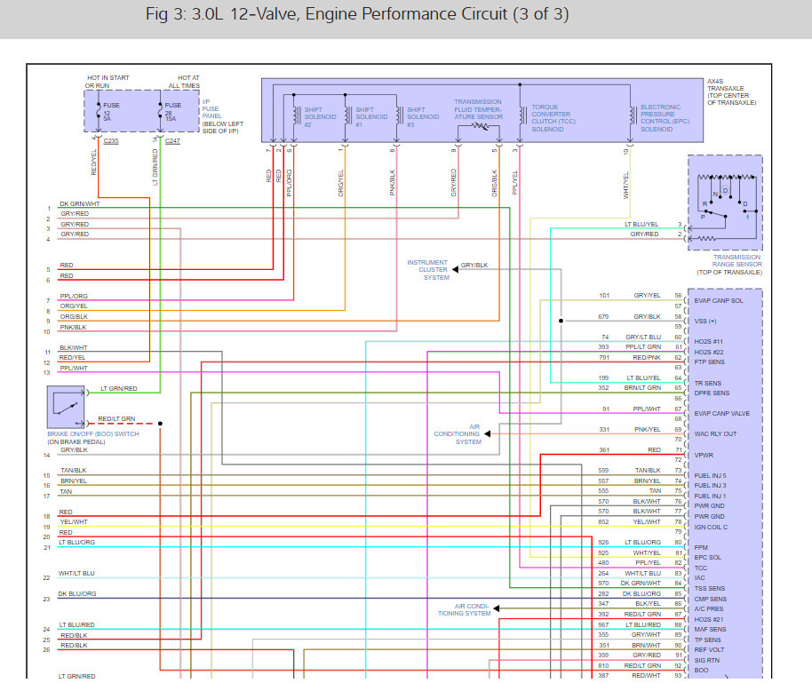

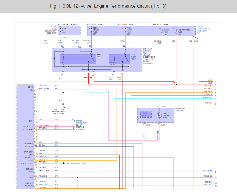

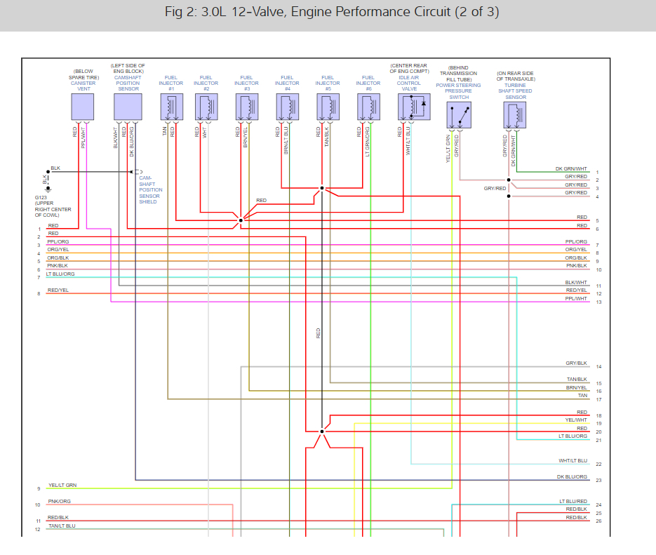

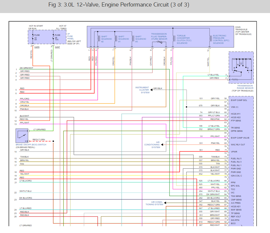

Did you replace the CCRM? These had problems for Ford. There are three fuses that run the CCRM which are in the diagrams below. Here are the wiring diagrams for the engine and CCRM so you can run some tests, also I have included a guide to help with the testing.
Aug 12, 2022 at 12:25 PM

It sounds like it, if the CCRM has power and a good ground it should work did you check to see if the fuse #2, 9 and 10 have power?
Aug 15, 2022 at 11:27 AM
