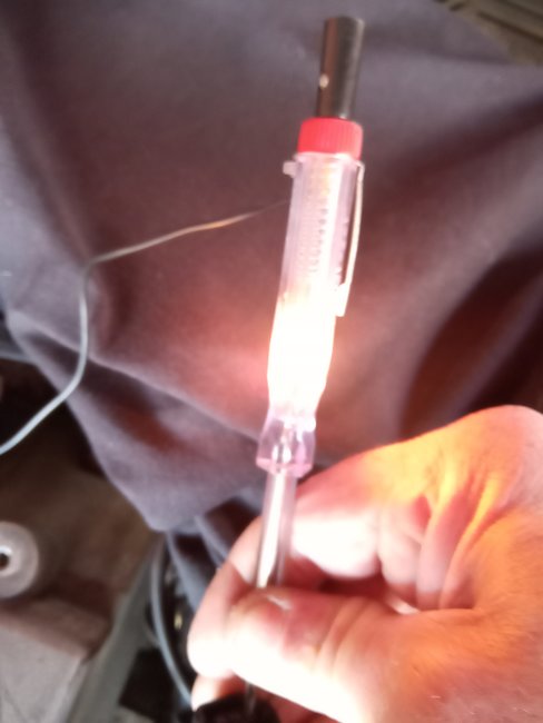

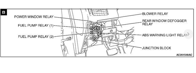

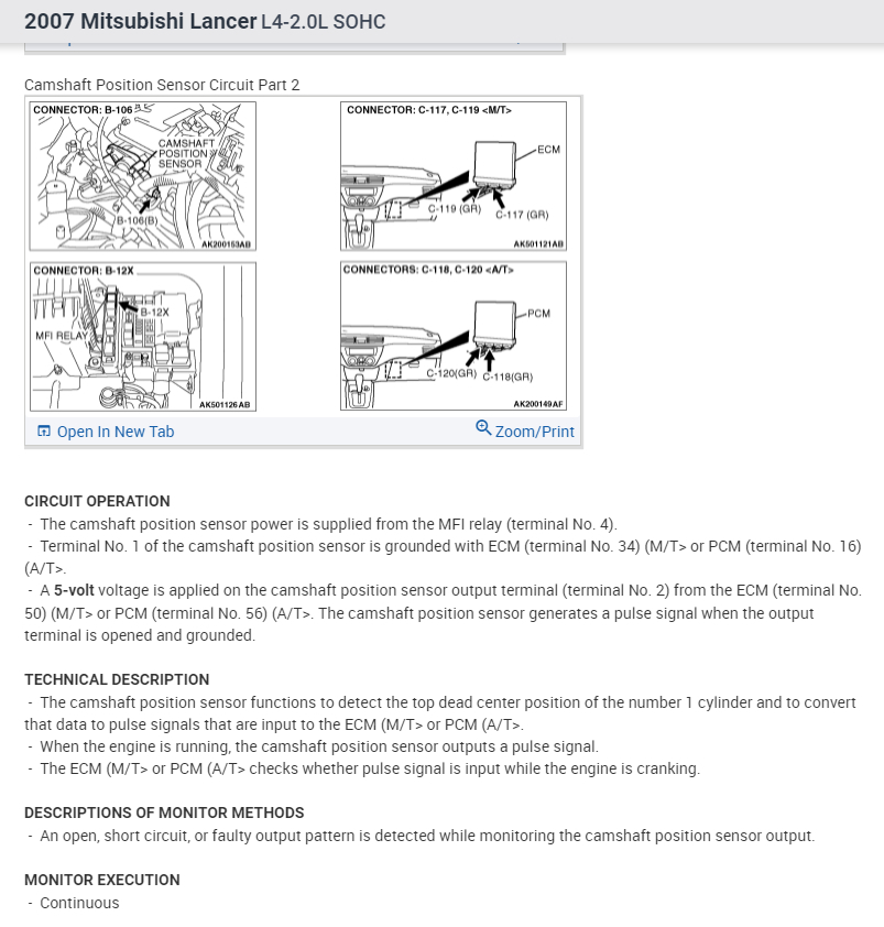

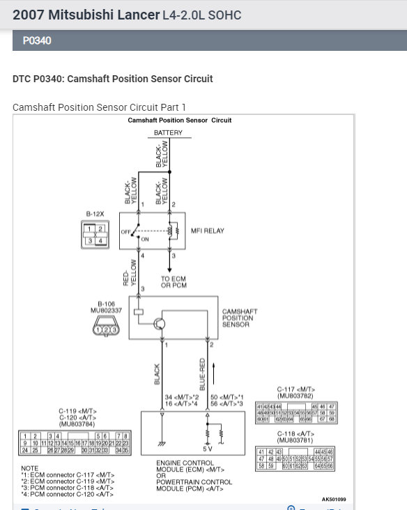

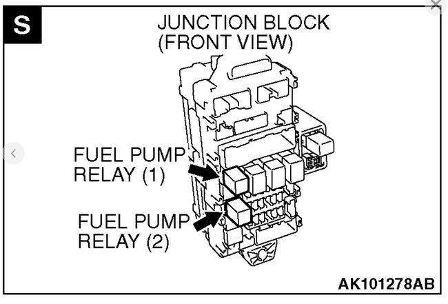

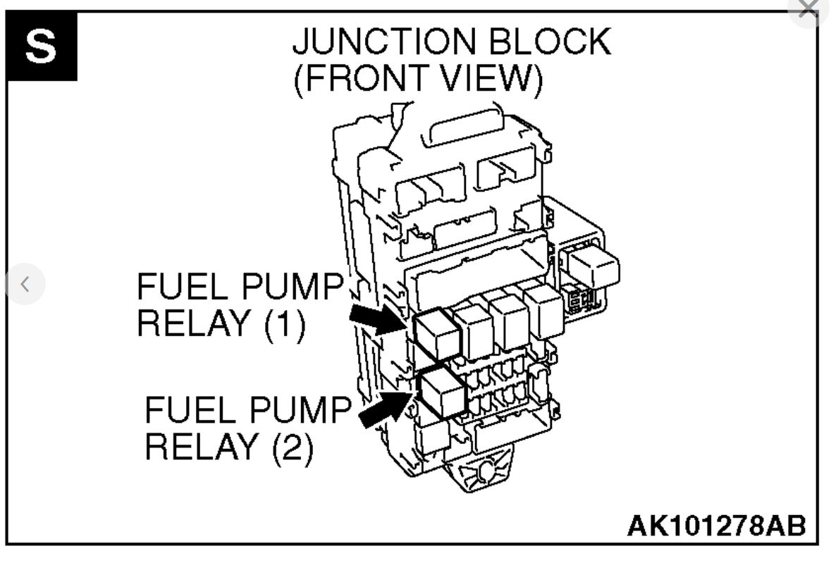

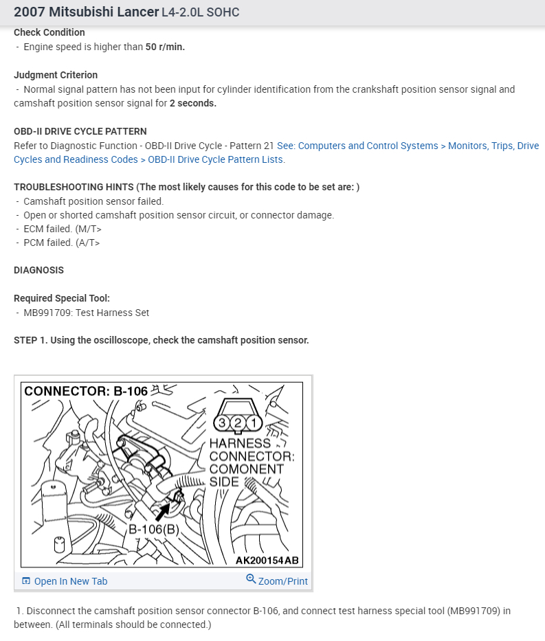

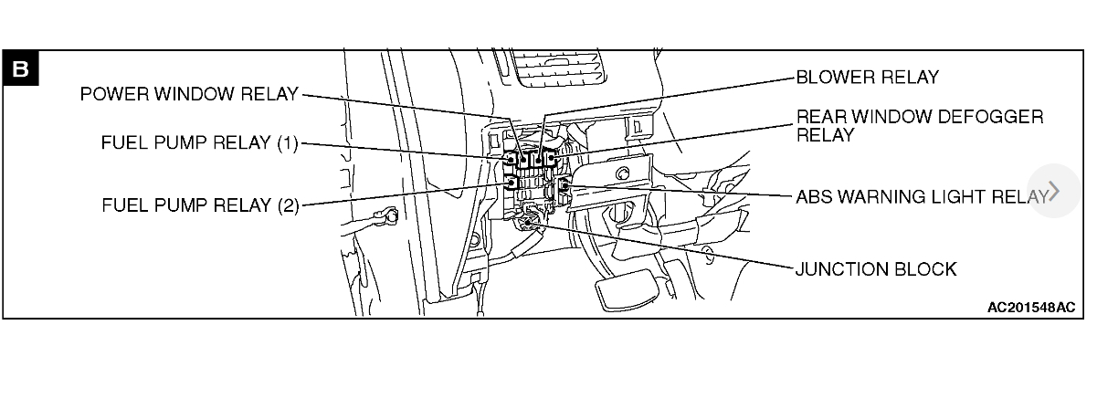

The car stalled at the lights. Towed it home it turns over but has no spark, no fuel pump, and when you turn the key checked the fuses and battery is good.

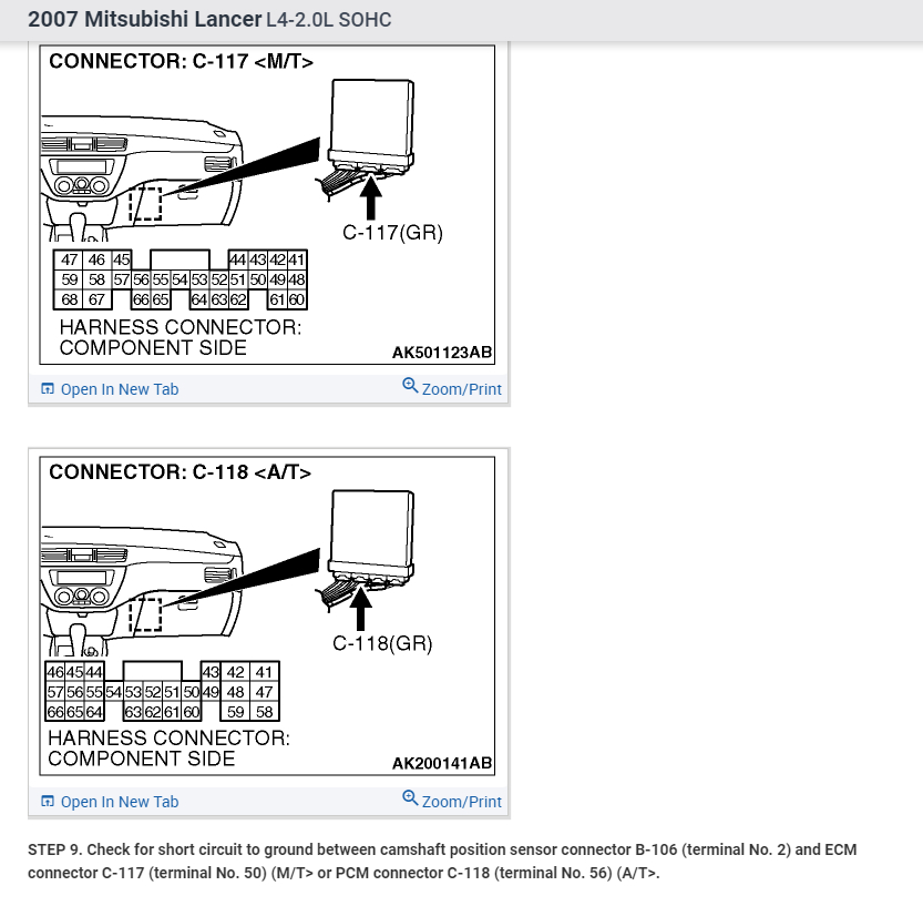

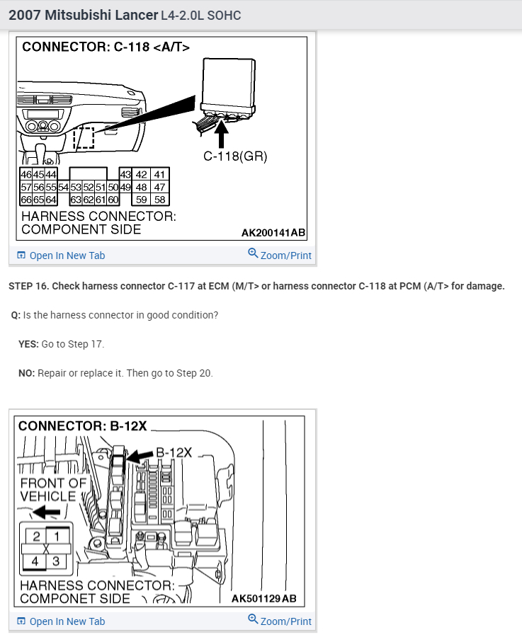

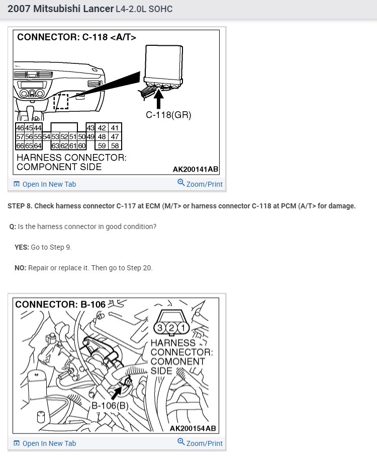

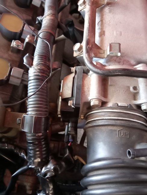

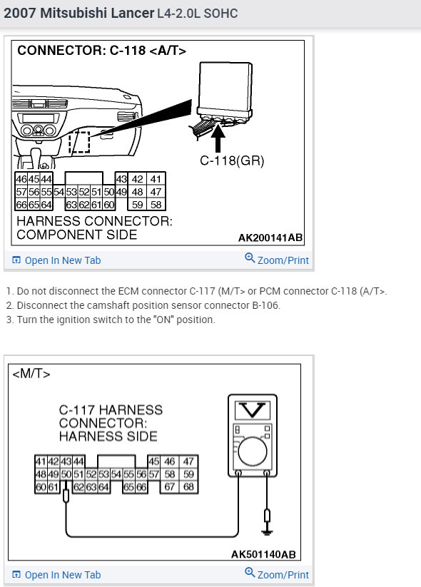

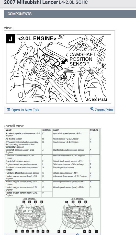

Purchased a cheap OBD2 scanner and have the code p0340 camshaft position sensor a circuit bank 1.
I'm ordering a new one, hopefully that is the problem.

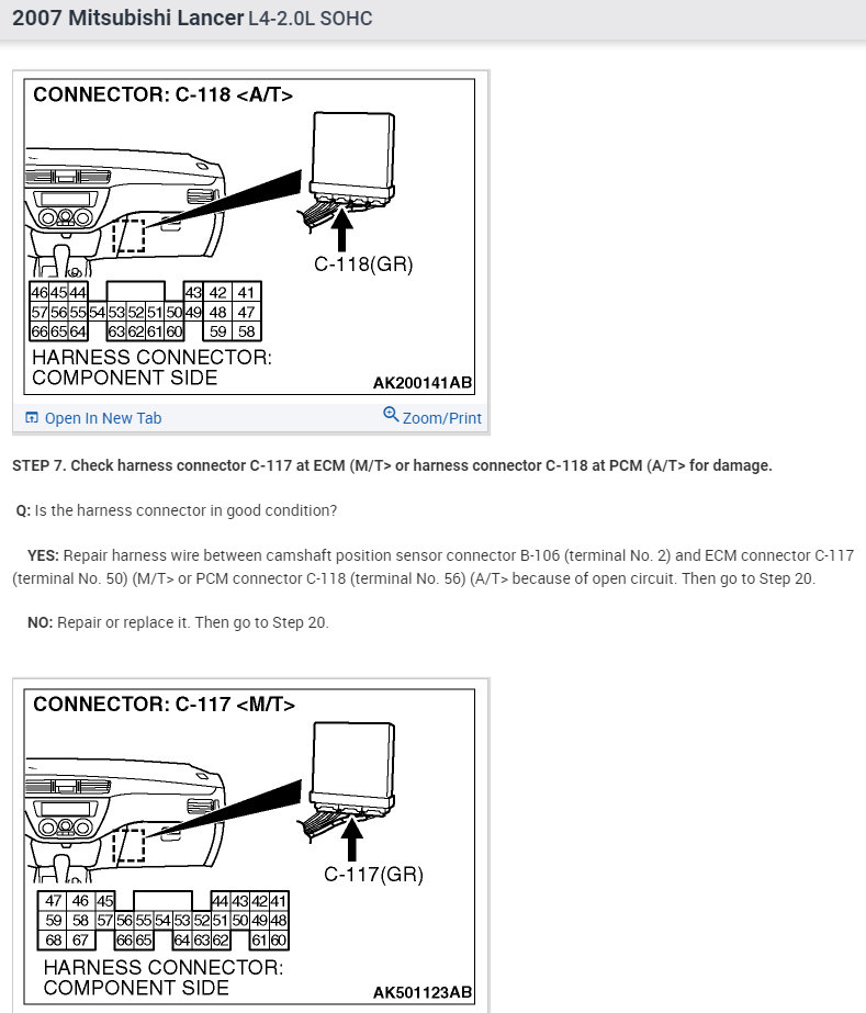

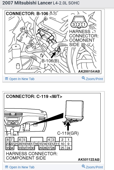

My concern is that I unplugged and removed the front ECU and the one behind the fuses inside the car by the kick panel prior to finding out about the p0340 code. Will they have to be re programmed?
