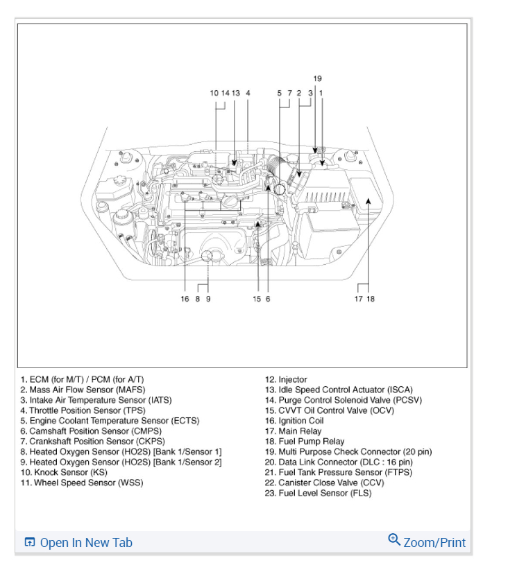

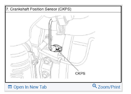

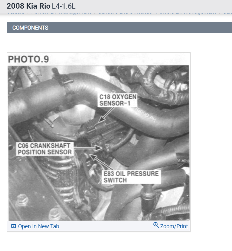

This sounds like the crankshaft angle sensor went out. here is the location so you can replace it to see if it fixes the problem. Check out the images (below). Please let us know what happens.
