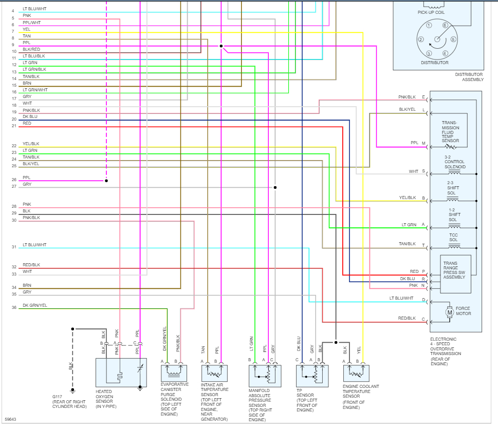

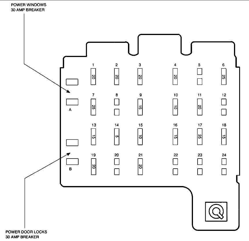

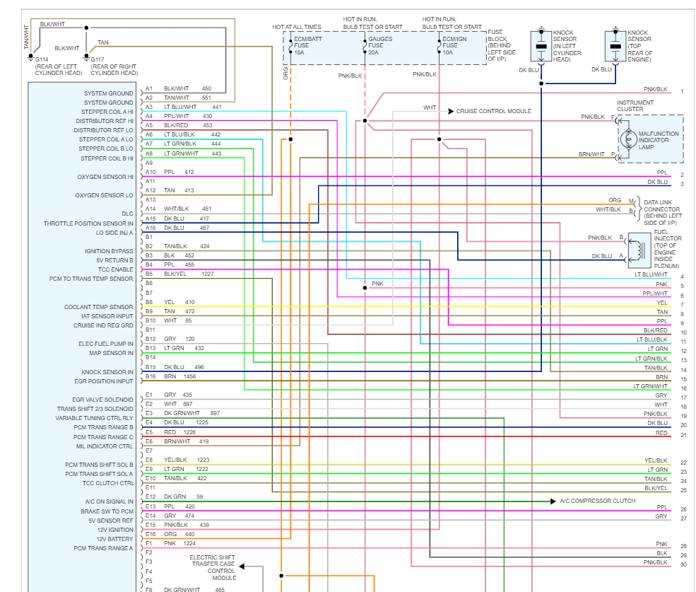

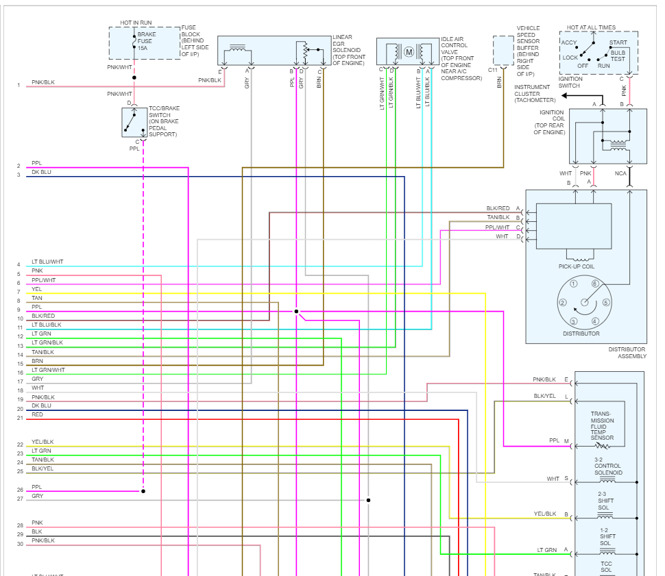

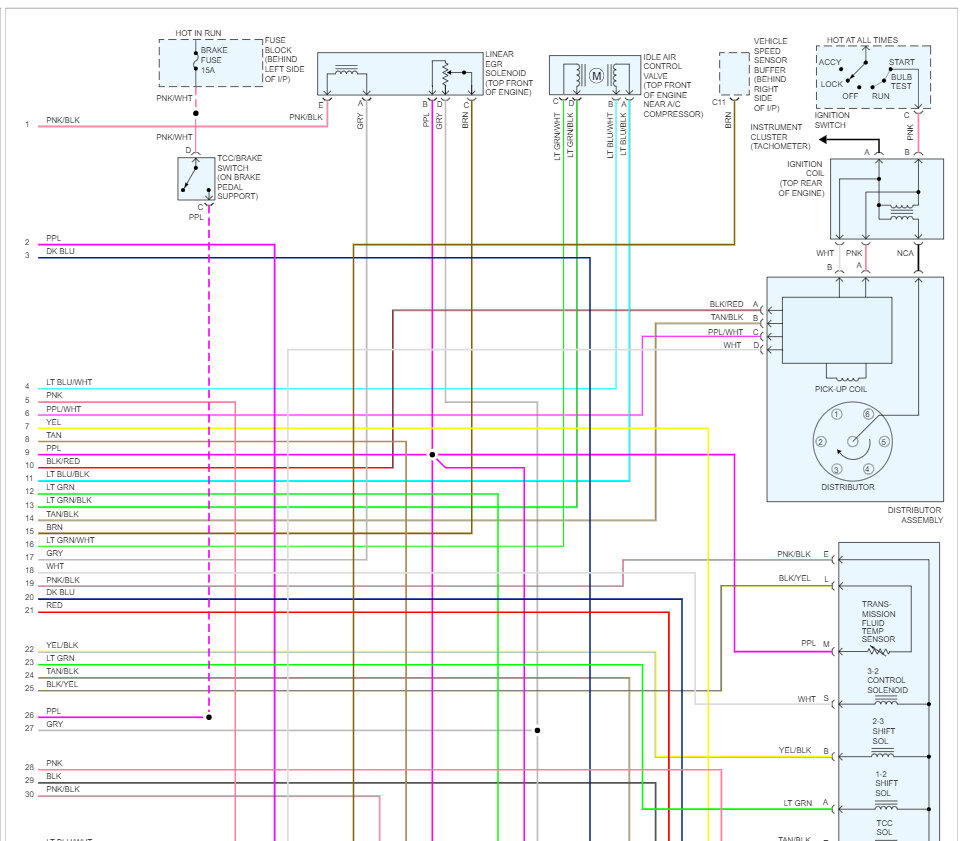

The first thing i would do is check all fuses. This guide below will help, and I have included the fuse location as well. Also, I have included the engine wiring diagrams so you can see which fuses to test for power and a guide to help you test the grounds. If the power and grounds are good, I would replace the ECM which I have instructions for as well.
and

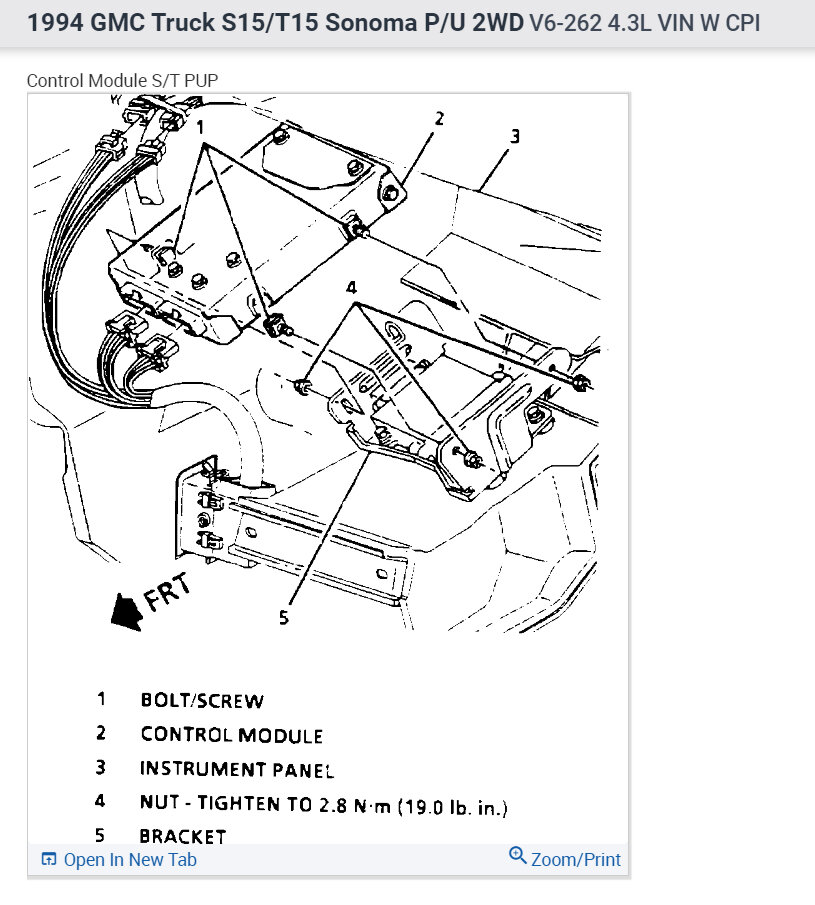

You must change over the EPROM unit from the old PCM to the new one. Check out the images (below). Let us know what happens and please upload pictures or videos of the problem.

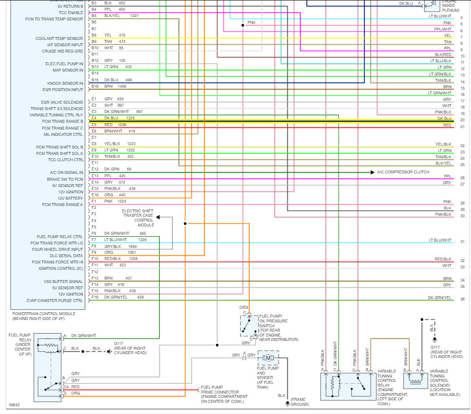

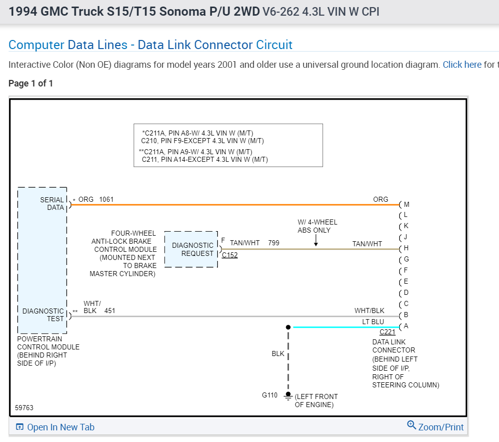

Yes, I would. Also check the power and ground inputs to the ECM using the wiring diagrams above. Here is the wiring diagram for the ALDL connector.

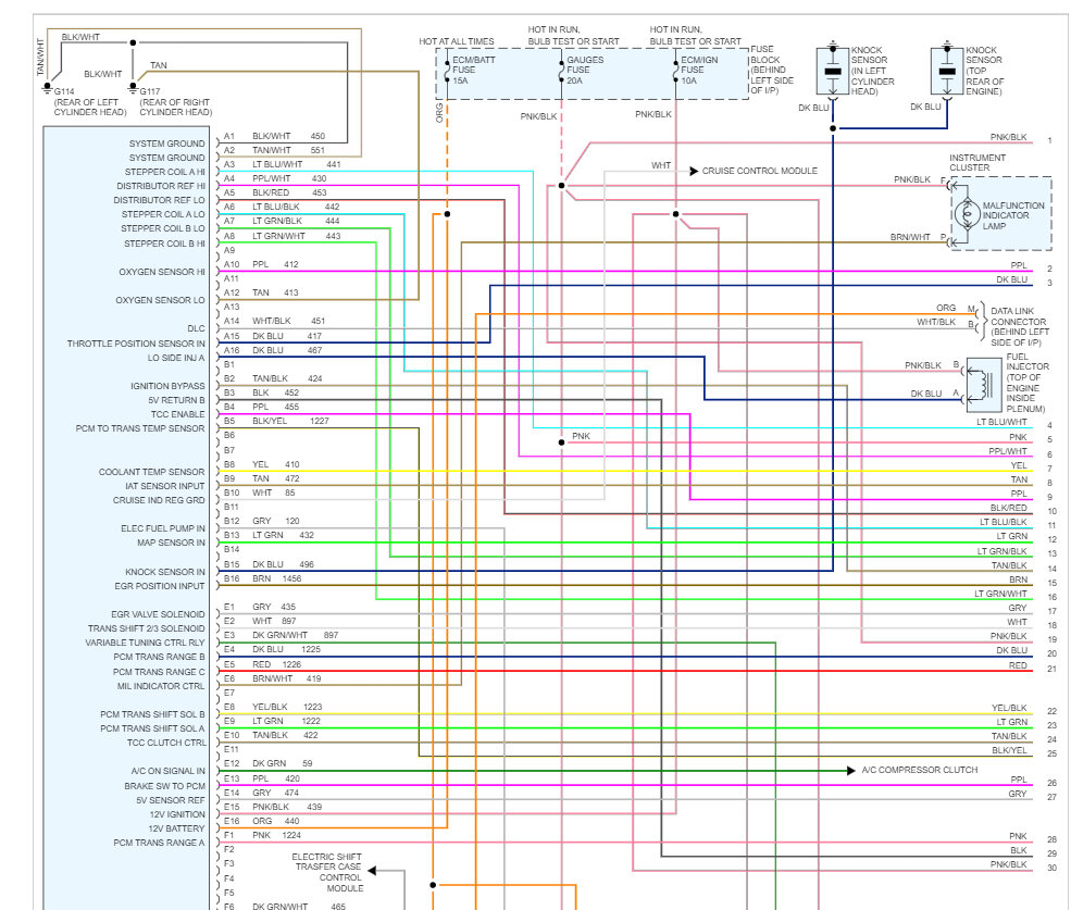

Did you swap the Eprom over? Also, I would check the power and ground sources to the PCM and if there are good, I would replace the distributor with a rebuilt unit. I would replace the ignition coil as well. These components trigger the fuel pump through the ECM. With the key on please test the remaining fuses for the ECM which you can see in the wiring diagram above.
