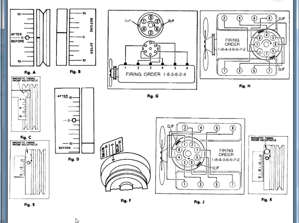

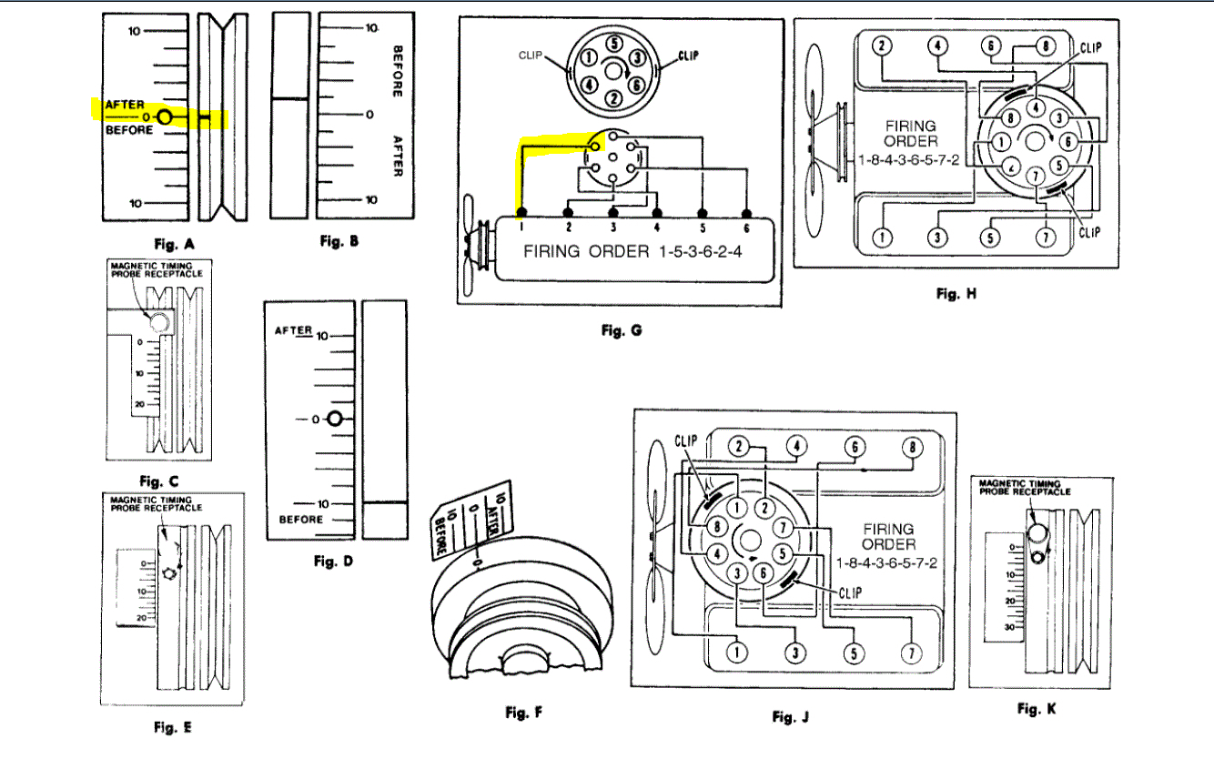

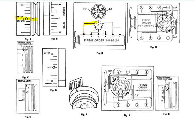

Now, I attached a pic below to help you visualize what I'm explaining. The easiest thing I can explain is this. Place the timing mark on the crankshaft on top dead center (TDC). Remove the distributor cap and snap a pic of the rotor's position to help you remember.
Next, with the timing mark on TDC, remove the retainer on the bottom of the distributor and remove the distributor.
To install the new one can be a bit tricky. You need to keep the rotor pointing at the same place as the old one, which is at cylinder 1 spark plug wire. If you look at the pic below, I highlighted the plug wire coming from the distributor. The rotor needs to be at that point with the crank pulley at TDC.

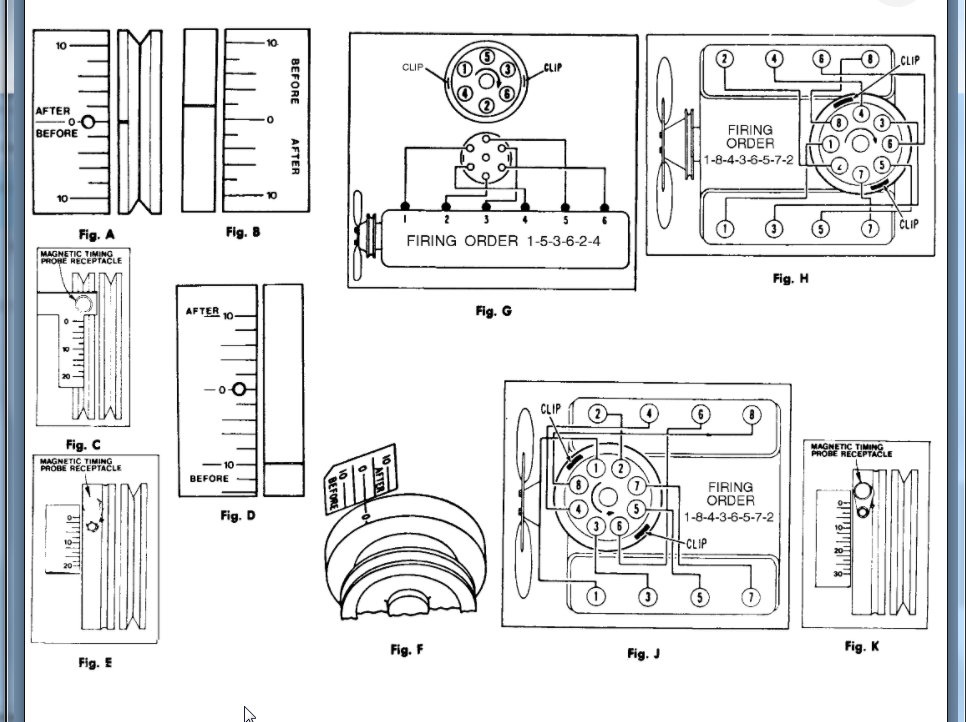

NOTE: The attached pic shows different styles that could have been used on your vehicle. Regardless of style, still follow the directions I provided.

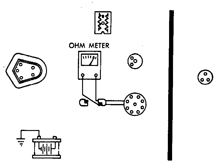

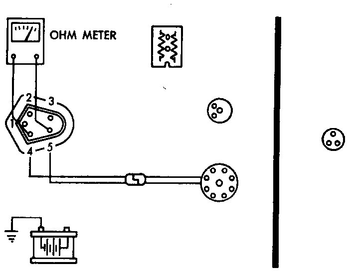

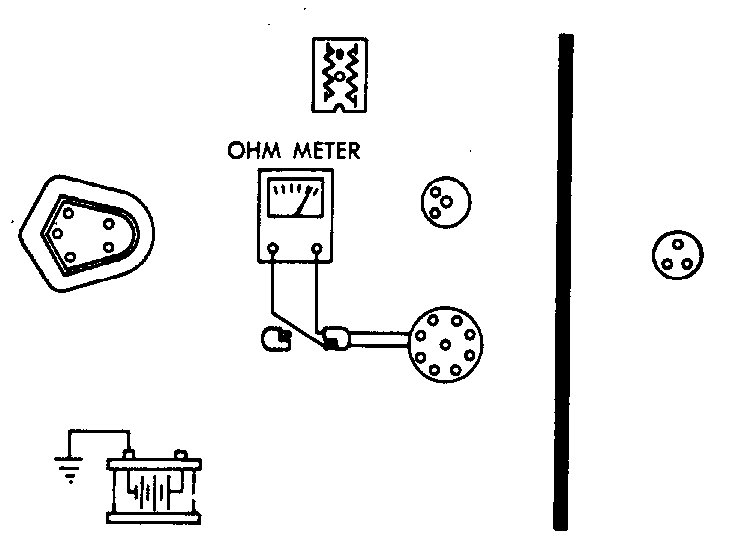

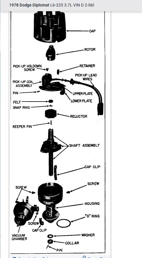

Also, here are directions for testing the coil. The attached pics correlate with the directions.
If you follow these, it will also indicate if the pick up coil is bad.
1978 Dodge Diplomat L6-225 3.7L VIN C 1-bbl
Component Tests and General Diagnostics
Vehicle Powertrain Management Ignition System Pick-Up Coil Testing and Inspection Component Tests and General Diagnostics
Fig 4 Wiring Harness Test
pic 1
1. Connect an ohmmeter between harness connector cavities numbers 4 and 5. Resistance reading should be 150 to 900 ohms.
Fig 5 Wiring Harness Test
pic 2
2. If reading is not as specified in above step, disconnect distributor dual lead connector and connect ohmmeter between the two leads on distributor side of connector. If resistance is not between 150 and 900 ohms, replace pick-up coil.
3. Connect one ohmmeter lead to a good ground and the other lead to either connector of the distributor. If ohm meter shows a reading, the pickup coil must be replaced.
