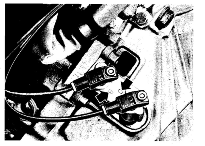

It sounds like the crankshaft angle sensor has gone bad. Here are some guides and diagrams to help you get to the problem and fix it. You will need to jack the car up first.
and this will give you an idea.
and
Here is where the sensor is on your car.
Please let us know what happens, we are interested to see what it is.
