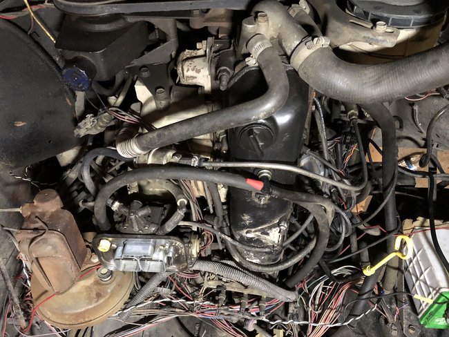

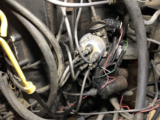

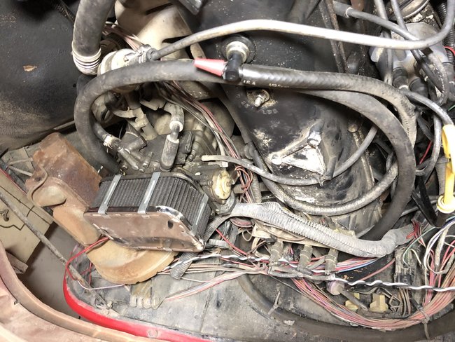

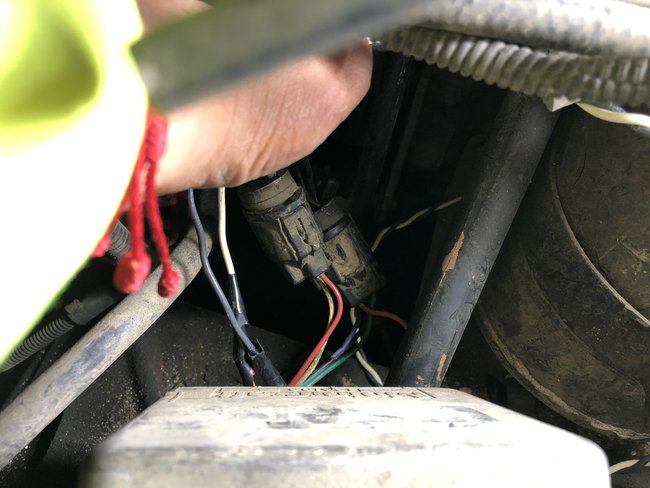

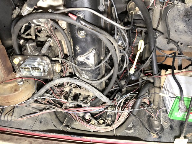

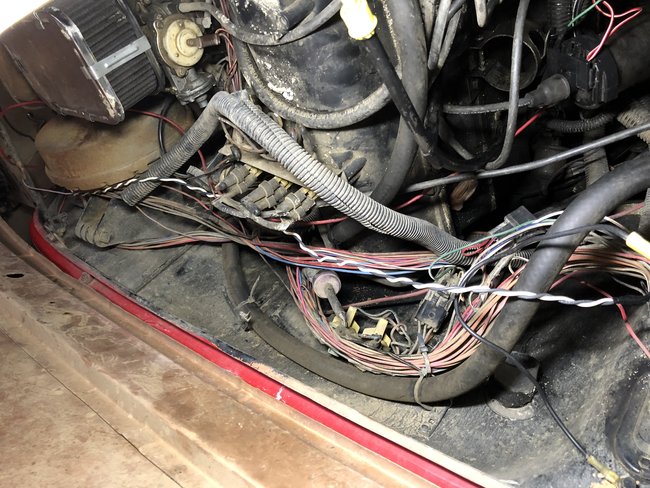

Can you send some good/well lit pictures of the passenger side/driver's side/top view remove the air cleaner for the pictures.
Can you tell me of any modifications that have been made?

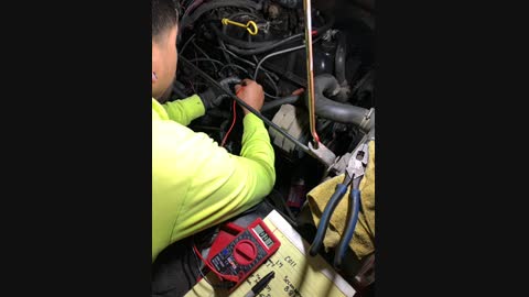

Do you have a voltmeter? ($5.00 at "Harbor Freight"). Timing light? Dwell/ Tachometer (portable type).
