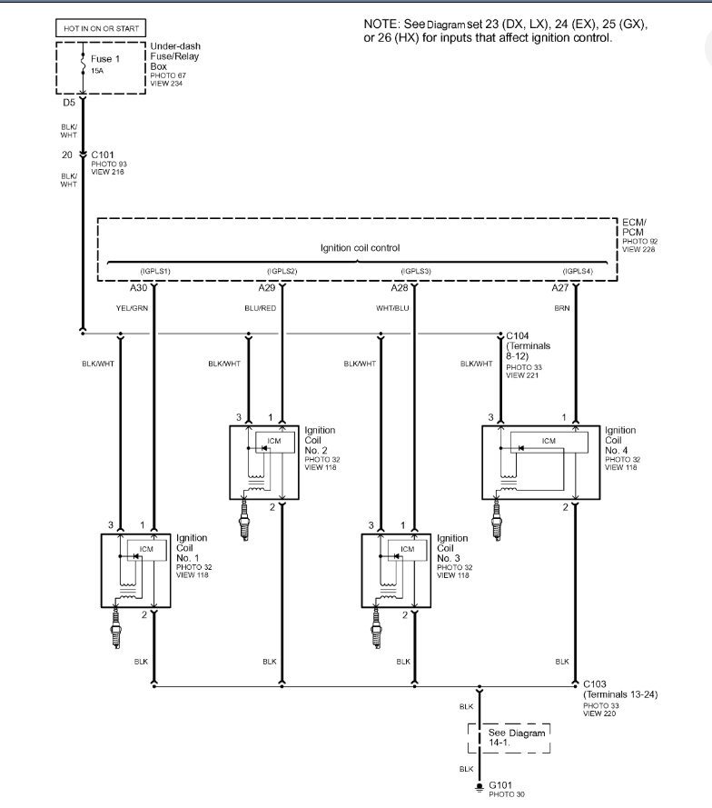

I just bought this car which initially was the O2 sensors that were messed up. so I fix those and camshaft sensor. now the problem is fuel pump just barely installed my fuel pump in the car still don't want to start. I have no idea what to do because I don't know about cars from a female I need some help or questions answer something because my spark plug isn't sparking on the coil. so I don't know if it's all the coil pack or not I don't understand why my car don't want to start.
