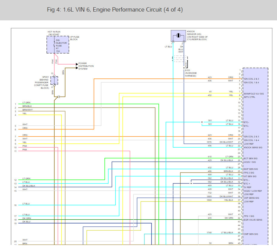

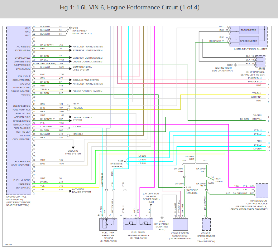

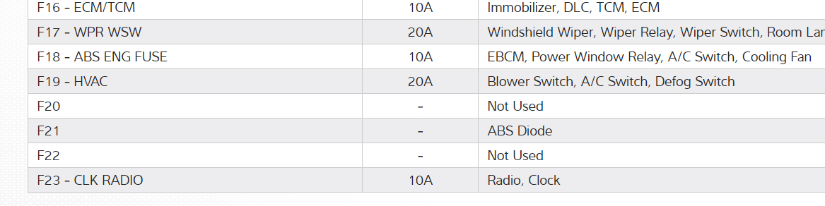

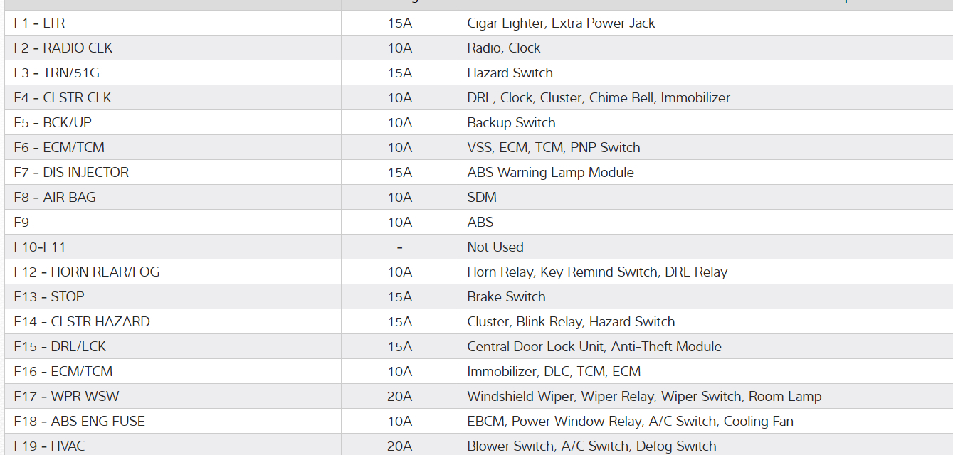

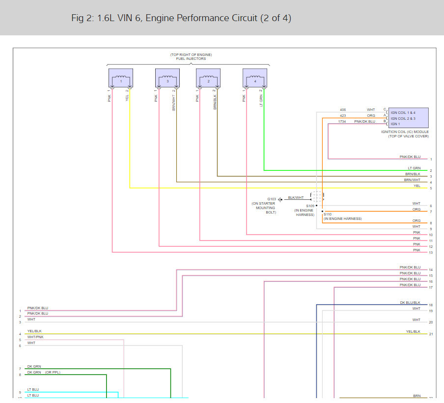

Why do I still not have spark? I hooked up my spark tester and there is no spark. The car turns over all day long. The plugs smell and are wet. So I am assuming fuel supply is not an issue. I Have even reinstalled all old parts and still have no spark. What is going on? New parts = no spark, old parts also = no spark.
