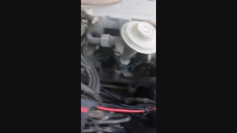

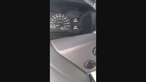

Update: Tried to get a code but my diagnostics wont work also I am very confused right now. Was instructed through a YouTube video on how to manually find the code and that's by inserting a conductive metal into E1 and TE1 to receive the code but nothing!

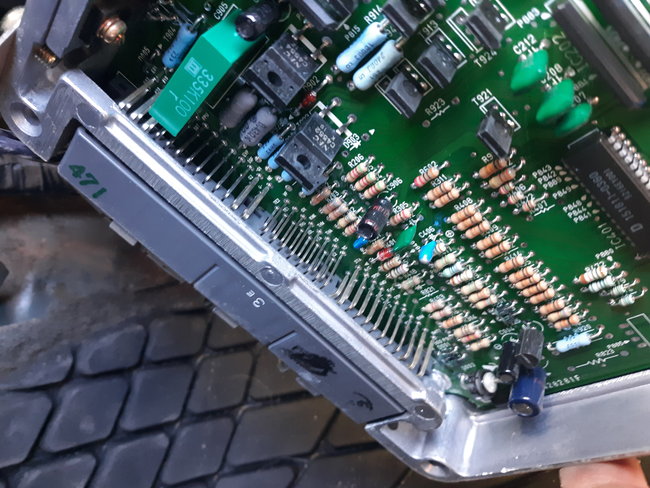

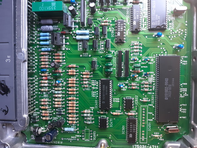

Here is a picture of the inside of my engine control module, I am no electrical engineer but it looks fine to me...
May 14, 2019 at 12:15 PM

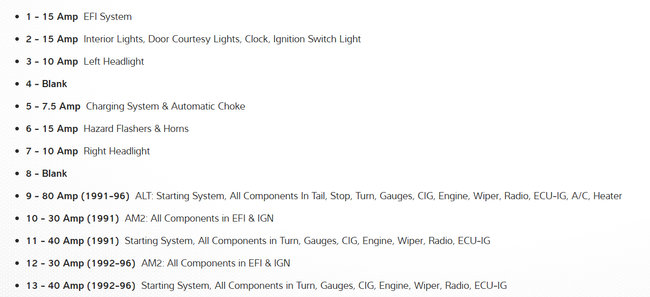

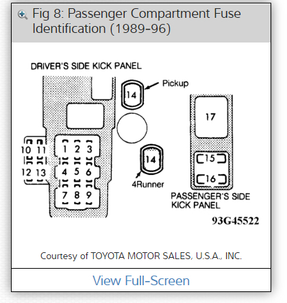

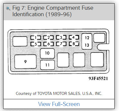

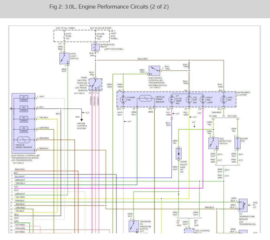

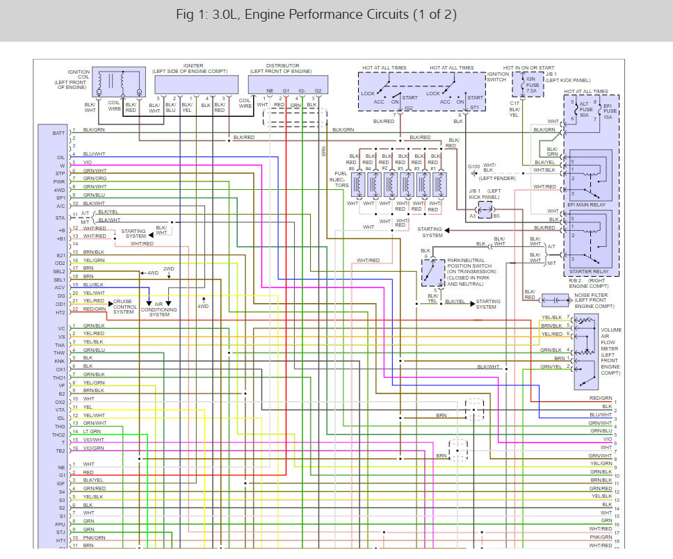

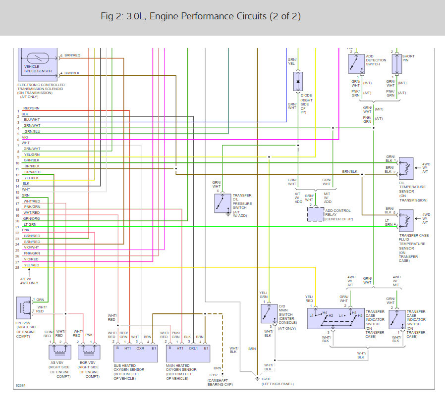

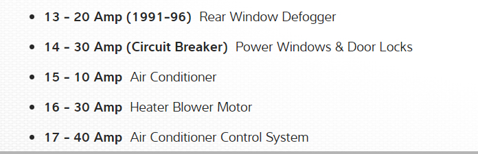

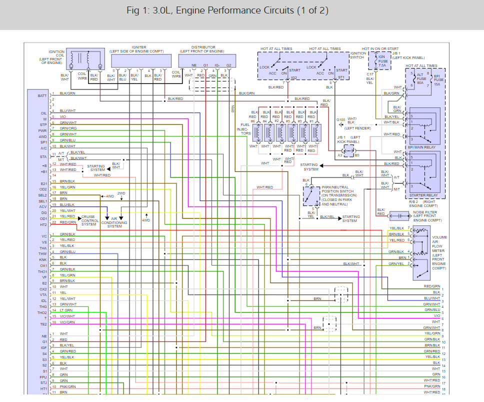

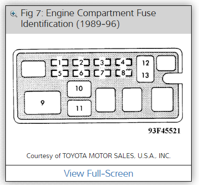

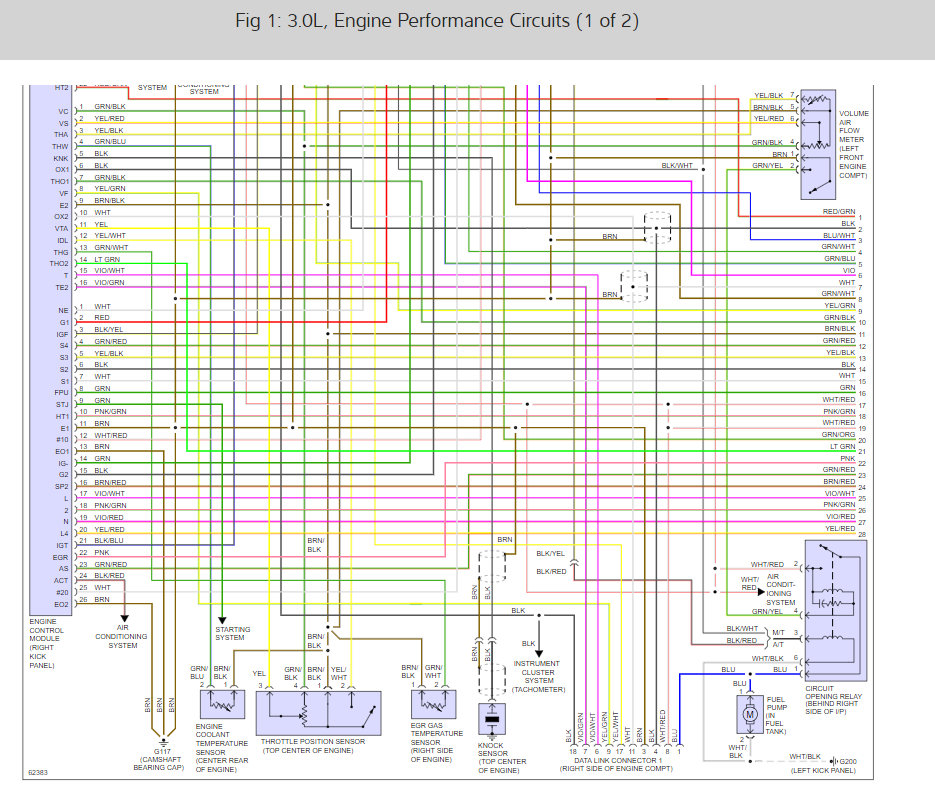

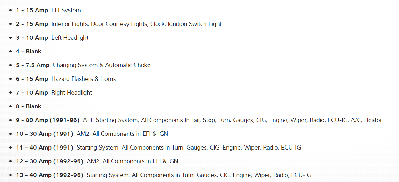

Thanks for the videos really helps, was the key on when you were trying to get the codes? Also the ECU can be bad even if it looks good how does it smell inside? Lets check the EFI relay here is a guide and the ignition wiring diagrams and guide so we can check those as well.
and
May 15, 2019 at 1:31 PM

Do you have power (pin 1) and grounds for the ECM working and did you check the EFI relay? Also check the ground cables from the battery to the frame/engine.

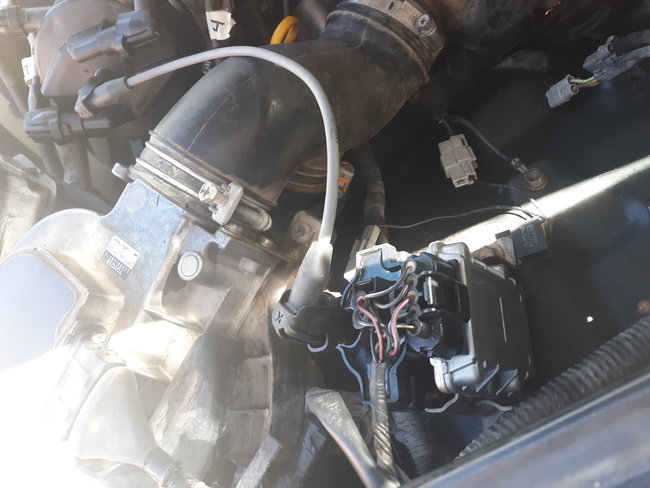

Found out my mass airflow sensor was broken the wires going into the circuit board just fell apart when I gently opened it. so I am going to replace that and then if it's still not going then I'll go for the engine control module. thanks!
May 23, 2019 at 11:13 AM
Shorted wiring at the MAF can cause the same affect. let me know.
